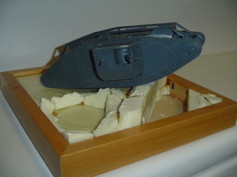

Here's a base that is basically what Scott suggested but with photo's.
Base with styrofoam:

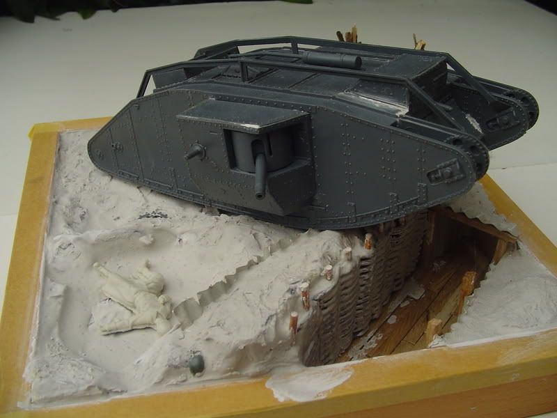

Instead of celluclay i went for paper maché layered with plaster:

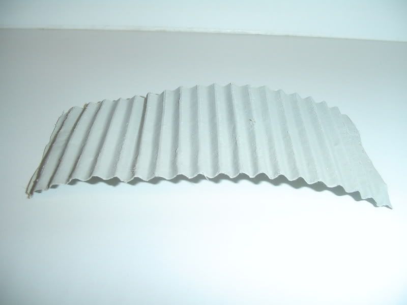

After seeing various photo's of other dio's i came across alot of corrugated iron used in defensive positions such as trenches.Some sticking dangerously out of the ground, others as shelter.
I simply removed the backing off of the flap of a cardboard box and spraypainted to seal.

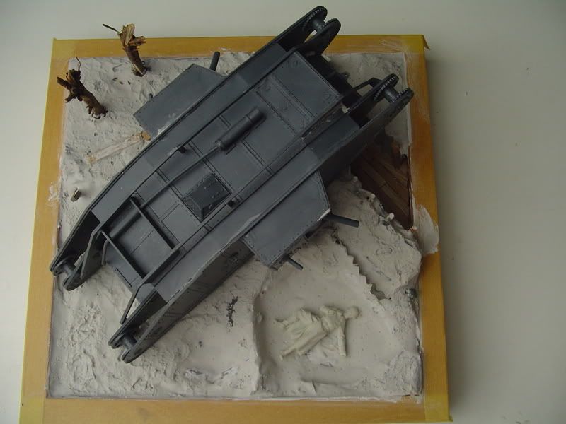

This is the stage i am at now during the painting stages:

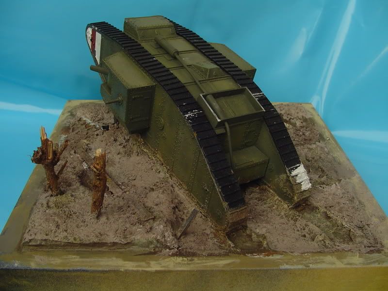

Here is a great W.W.1 dio example:
