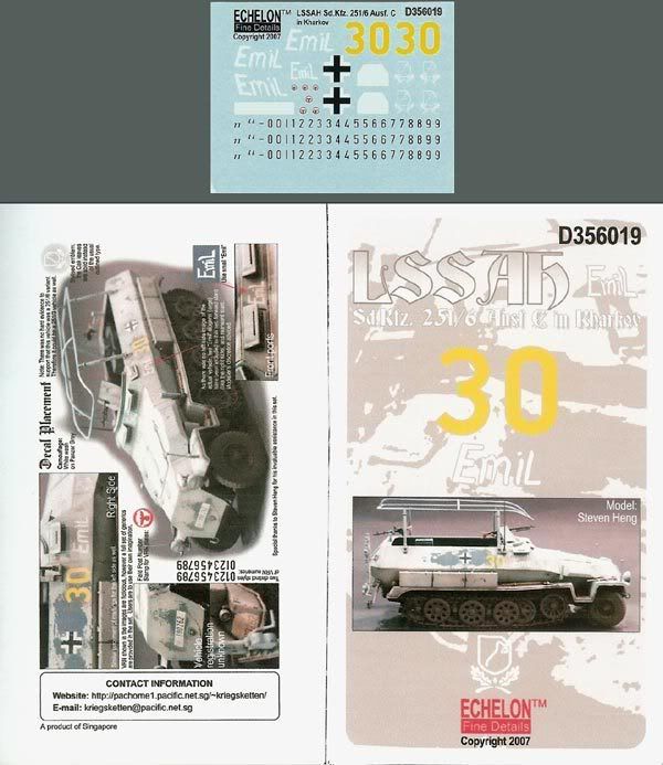

Another problem I have is the colour scheme, since I only have b&w photos of this particular model, I suppose it's the german panzer grey used mostly for this vehicle, but since I plan it to be used in the third battle of Kharkov in 1943, I believe whitewashing camouflage was used.
Some info I gathered from the net shows this decal much adapted to "Emil", haven't seen Echelon decals being distributed in Europe:
http://www.airconnection.on.ca/ECHELON/airconnection_ECHELON_ECH35619.htm

Thanks Ron and Steve for different tips.
Steve, the DML kit you suggested seems to be the best choice, therefore thanks for the tip. Since you made already this kit, excluding photo etched that I'm planning to use ( that is eduard photoetched parts, like the tool boxes and the whole set specially designed for the DML kit), what can you tell me about the tracks, should I look into more accurate ones or they are just fine?
Ron: As you requested, here you can see what "Emil" looks like. Hopefully the scan from the book that inspired me insn't too dark ( After the batlle nº112 - Four Battles for Kharkov) and you can get at least a glimpse at what it looked like. (2nd picture and 3rd picture) If there are more visible pictures of "Emil" it will be much appreciated.
DML kit 6206
The Echelon Decals specially available for "Emil"
