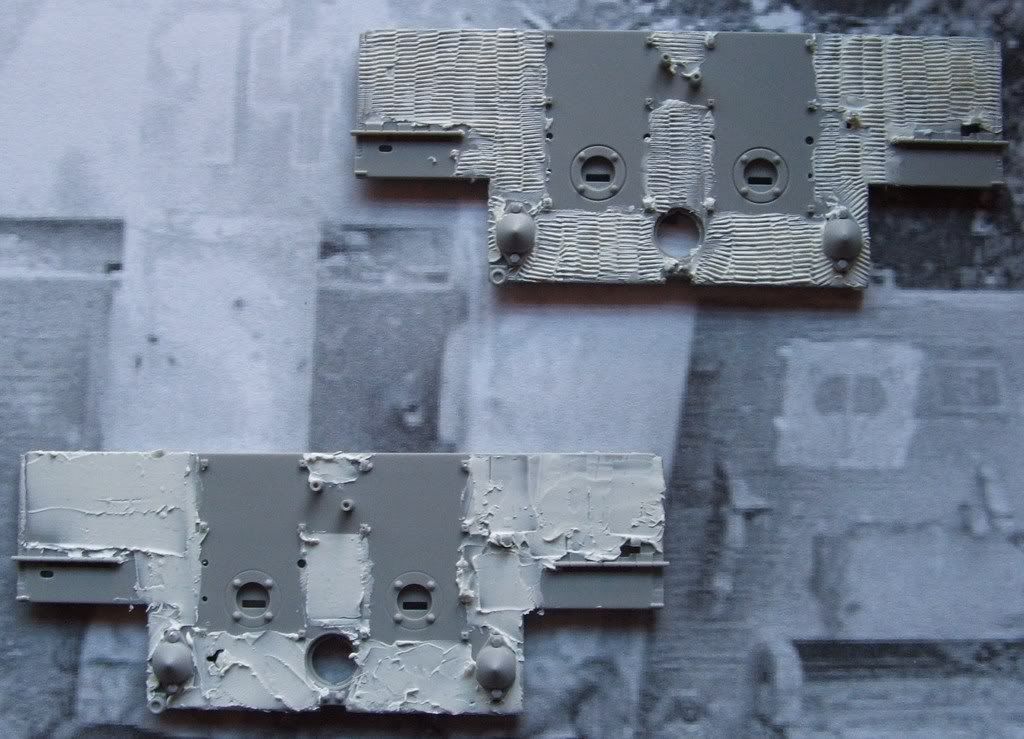

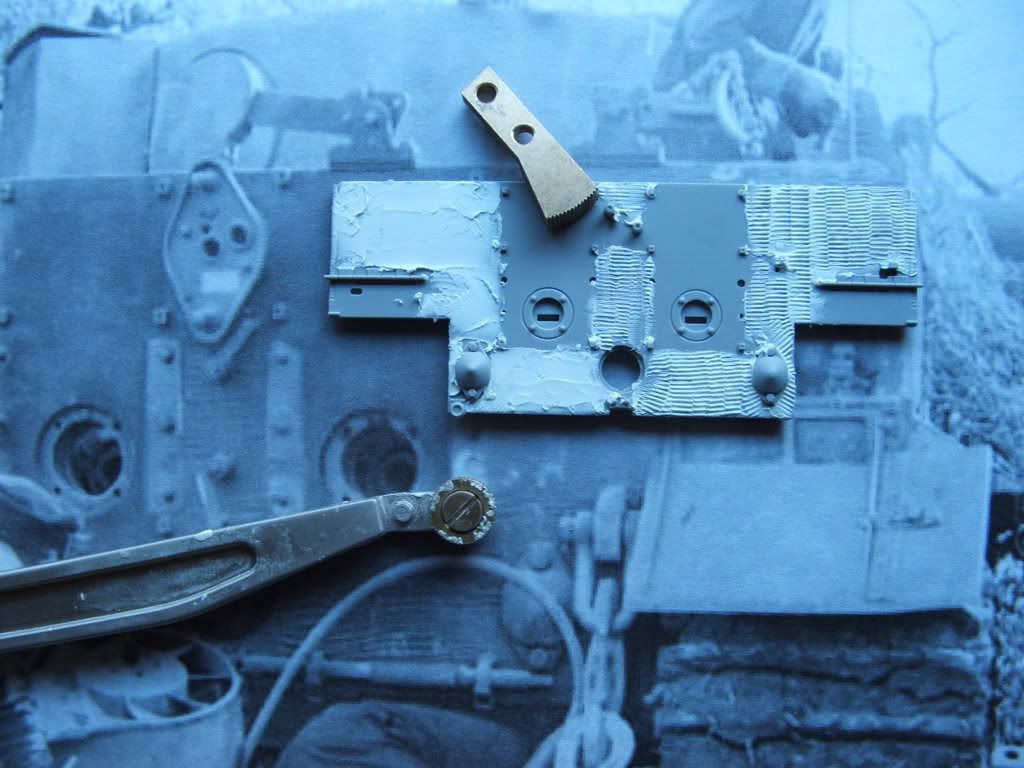

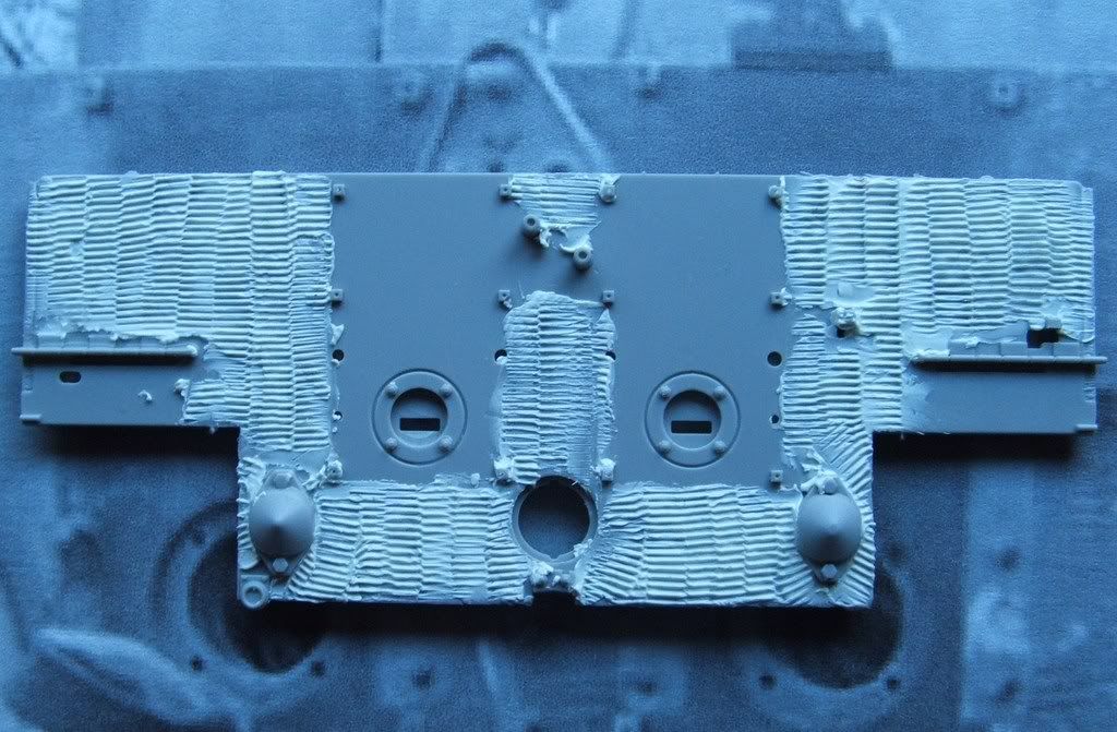

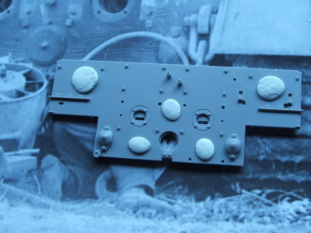

Anyway enough of the rambling. The first thing we need to do in order to start the 'pasting' process upon the rear hull plates, is to make sure we can find the location

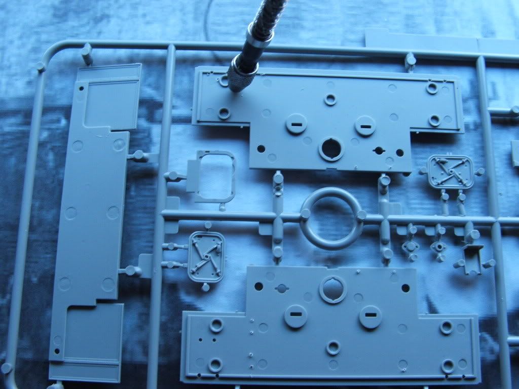

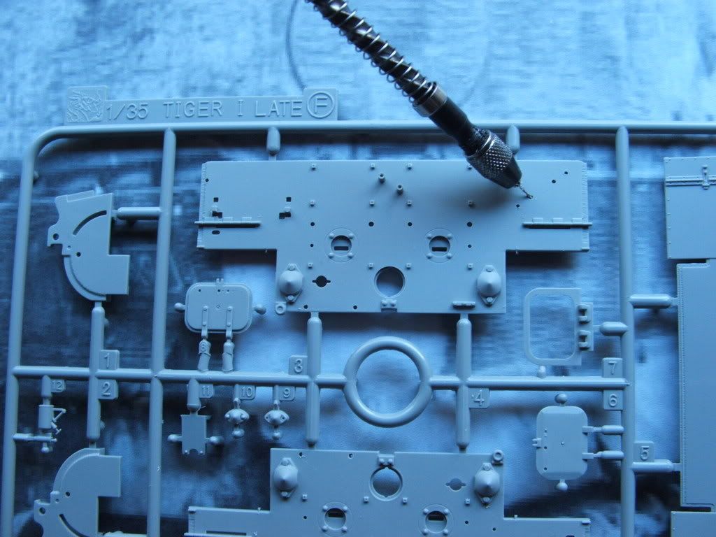

points for the stowing of the external equipment. Thus a small hole is drilled through to the rear side of the part.

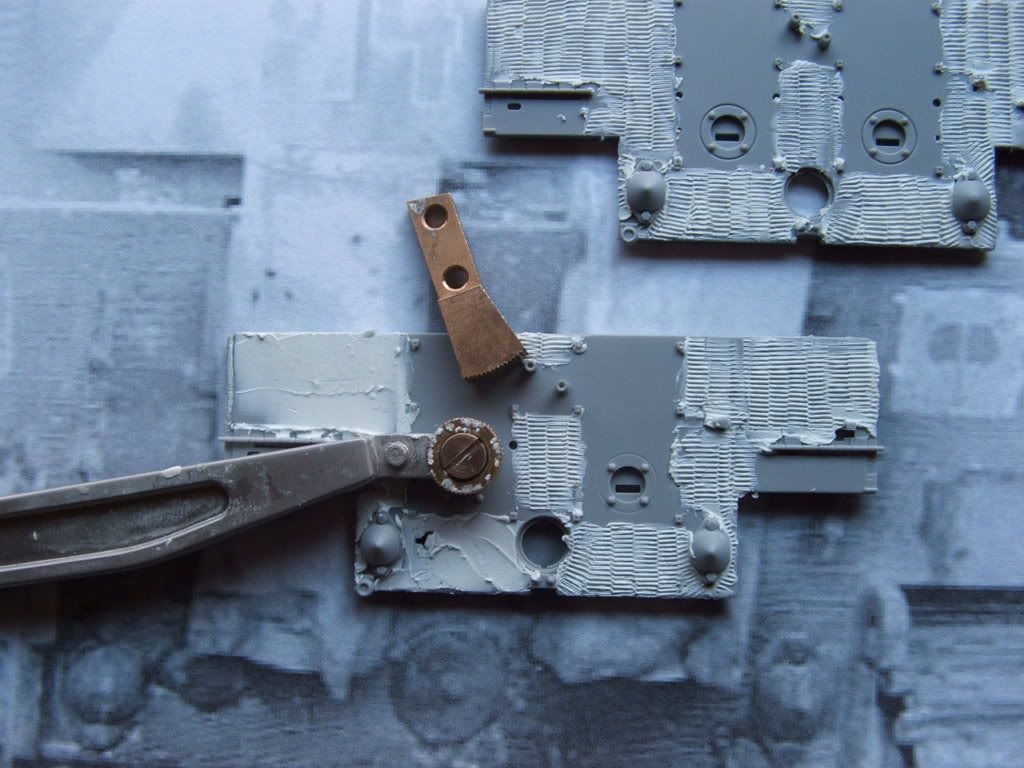

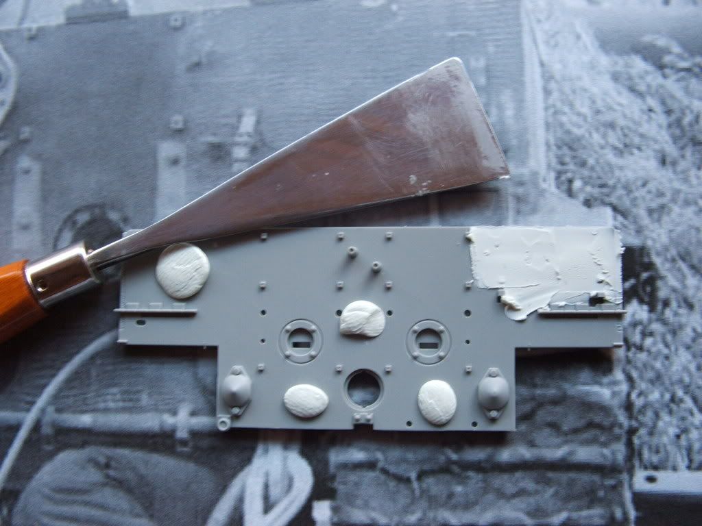

With this done, the Tamiya (or whatever putty you prefer) Epoxy can be applied in pinto bean sized lumps (thought pea sized was getting tired!) onto the rear hull part, separated into lentil sized lumps, for ease of spreading.
Then again this is spread to a rough evenish depth of aroun 0.2-0.3mm, with a flat bladed impliment, for some of the harder to reach areas, I used the end of a 'redundant' Tamiya 'zimmerit' tool to get at these tricky areas.
Once you are happy with the coverage of the to be pasted areas, it is once more 'rolling time' this difficult looking area is actually quite easy and 'fun'. Following the profiles of the track tension covers and starter port gives a real sense of authenticity to the zimmerit.
The corresponding pattern type doe is utilised for the areas that the roller can not get to.
With all the smaller and obscure areas done the pattern can then be imprinted over the remaining 'puttied' areas.
Then it's the turn of the other rear hull plate, the first one that we pasted above, is for the fine patterned turret... as David has pointed out, it is an earlier hull with the flat hull side front ends, around January '44' production, unfortunately a real 'transient' phase in Tiger 1 production variants, I also very nearly forgot to remove the welded mounting lugs/nuts for the deleted feifel air scouring system. This hull part is from the 'Kurzmaul' #6416 kit. I will have to ask David if this particular Tiger with this hull configuration would have had a travel lock, or if it would have had a very early fitting of the pre-heater cover and aperture.
There we have it 'zimmerited' rear hull plates!
Next job on the cards is to tackle the #6383 sculpted rear hull part, and remove that zimmerit under the exhaust stacks, between the lug nuts that secure the sheet exhaust shrouds, and also in the area where the armoured exhaust covers sit that are fouled!
So see you all next time! Thanks for being interested, you should see how quickly the pub clears when I start talking ZIMMERIT!!!
Cheers Phil

Right onto the rear hull plate once more! After the moulded zimmerit has been removed... even if it a fairly neat job, done with a Dremel (on low speed) with a flat tipped 'barrel' burr and a micro chisel, the surface still needs to be levelled, to do this Mr Surface 1200 is used, flooded onto the surface in layers, enabling the depth of the styrene to be rebuilt to a thicker depth.
When this is done to your satisfaction, you can cover it up quickly with the exhaust muffler assemblies and armoured exhaust covers! The mufflers are given a light stipple with Mr Surfacer 500, to represent some light rusting and flaking to the surface, keeping it subtle for newer vehicles, with this in mind if you do go 'over the top' you can sand back the texture to a smoother though 'pitted' surface. Right dry fit time.
To show the restored thickness to the rear hull plate, a shot of the top edge of the Tigers rump!
Also if you intend to depict a late production Tiger of the 1./s.SS.Pz.-Abt.101 then you will have to remove a little more zimmerit from the rear of #6383, as the area that would display the tactical schwere rhombus sported by all known lates of the kompanie is not depicted on the part, as it is upon the glacis, you could remove the sourface texture again for this or you could do it the dragon way and remove the section of styrene from the rear then plug with a stock styrene sheet plug of your own making. One of the things that I like about the kit, is the 'revisionist' take on the turret Tactical marking numerals for '112' having a green fill rather than the usually depicted black fill! History in the re-making eh! I have shown the area that needs to be wrangled/removed with a black patch!
Also still to do, is the missing section of zimmerit on the angled plate that joins the rear hull part to the belly of the beast! I will use the old 'screwdriver' method for this as the pattern is a lot heavier than any of the roller gear doe's for the smaller pattern, and the Turret ones would be to large!

When you remove the parts, you should hopfully have two darker areas, where the parts sit, that will enable you to rid the bow part of the moulded texture that fouls these covers.
When this is done and the bow plate and inside final drive plates are attached proper, you should end up with a nice snug fit, with the plates surrounded by the zimmerit, rather than riding on top of the paste!
So there it is! A small problem easily fettled... Another thing I have stumbled across is that for the tacital rhombus on the included plug option for the glacis, the area is a little to wide, this is a minor point, as it only relates to a Tiger 1 decal opition for the !st Kompanie of the s.SS.Pz.-Abt.101 #112, whilst looking at reference images, it appears to me that the small number 1 is actually painted directly onto the zimmerit and not on to where the zimmerit has been removed in a rough horizontal rectangle that carried the scwhere tactical rhombus, this can be seen on '112' 121' '114' and other Tigers of the 1st Kompanie.
Right bed bekons! So back tomorrow... Oh yes on a final note, I think I will try getting hold of a ModelKasten applicator. Phil.
