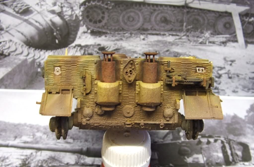

I know Grant... I know, all that attention on the mufflers only to be shrouded from sight... I made a promise to myself at the start of this that this 'poor relation' to the other Tigers in the gang (can't think of the 'collective grouping' title for more than one Tiger! It might 'be something cool like a 'Murder of Ravens' eh! But then again maybe not! ) would get some serious attention, due to it's lack of AM crispness, and bespoke zimmerit. So I am spoiling it a bit.Couldn't resist 'splattering a lighter contrasting coat of filth on her today. It is real good fun though!

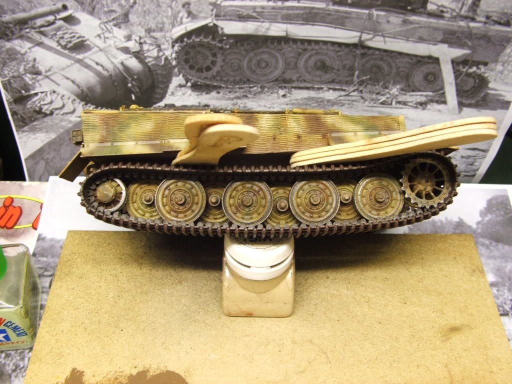

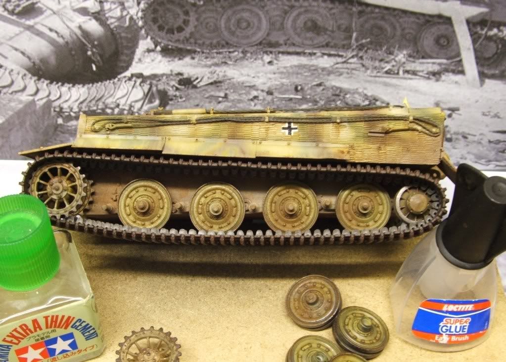

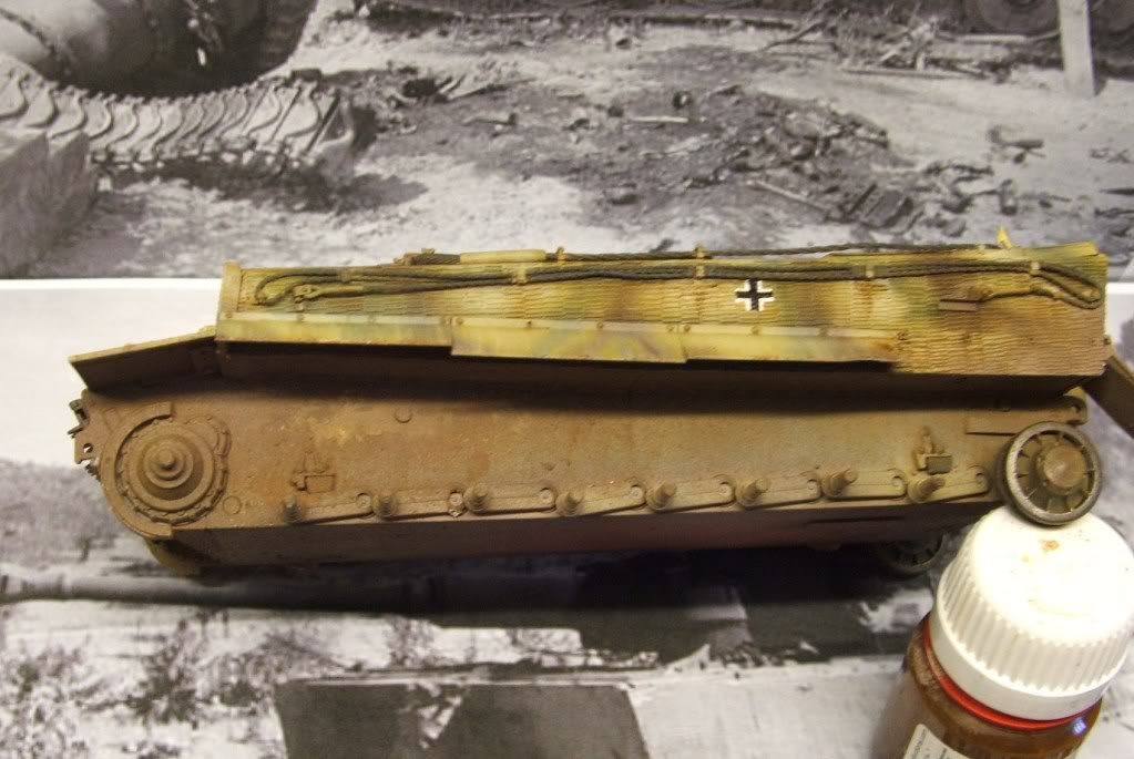

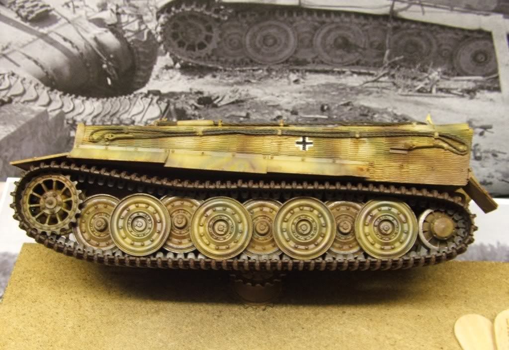

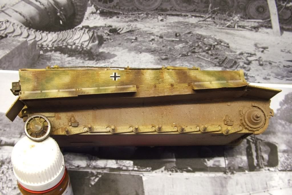

Okay then! They day of 'DS' reckoning has come... Not actually that painful in the end. I superglued the idlers in their central position, and the four single roadwheels at the back of the order were cemented with Tamiya extra thin cement, then the track was put around the idler and the sprocket placed on it's mount. Nice and tight without to much slack, but not overly taught.
Then the double middle order roadwheels were dry mounted, before the 2nd and 3rd received a dab of CA on their to contact surfaces,
and the track was 'wedged' onto the roadwheel tops with these handy little devices that the children found in some lollies! They did the trick though.
Then the outer row of roadwheels were fixed, and voila! Painless DS tracks, also with the extra links removed, and the idlers 'set' in neutral, this Tiger isn't even 'twine toed', good ol'Mr Byrden eh?

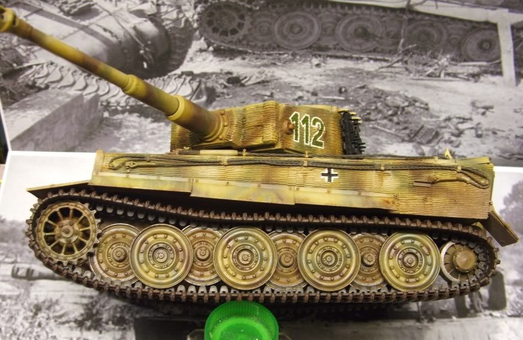

Right lets see how this baby sits in her battle tracks!
Right then lads! A little more light wear and tear, and the next Tiger will be approaching the horizon... Back soon, cheers for looking in.

Looking great! I'd hate to wear those boots in the winter and as you said must have been hell walking on the back deck on a wet day! Remember your three points of contact! (two feet and a hand holding onto something-otherwise you will get one point of contact-your rear-end on the ground!)

Looking better and better, Phil!
Every installment is just better than the last!
Nice work on those tracks--you're not far from the Tiger-Promised Land!

Looking great Phil, I really like how the tracks and road wheels turned out. All the extra work on the exhausts was well worth it, they look awesome dude.

Ahh! Rob the exhaust, I took a look a look at some of your rusted masterpieces and went from there! The rust is mostly Gunze Sangyo's Rust from their weathering set, with a little of their Schokoladenbraun H406, stippled over black primer.

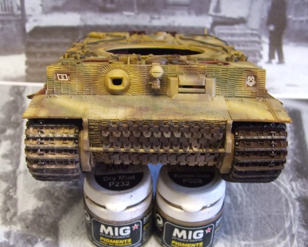

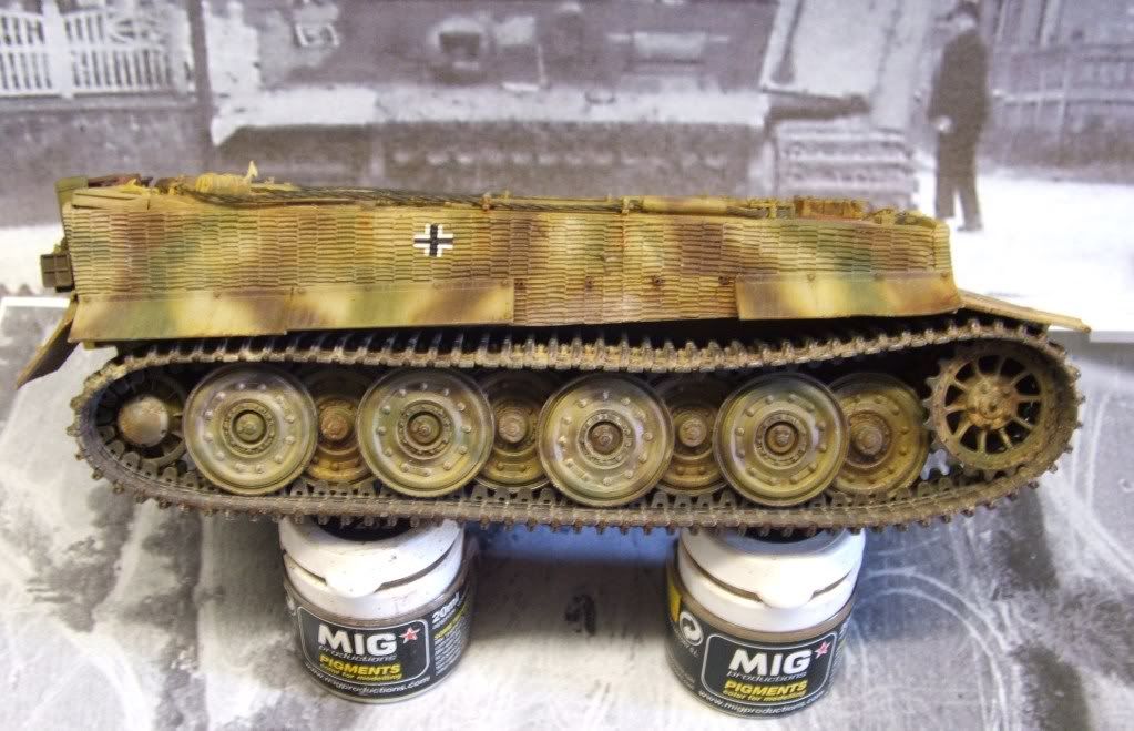

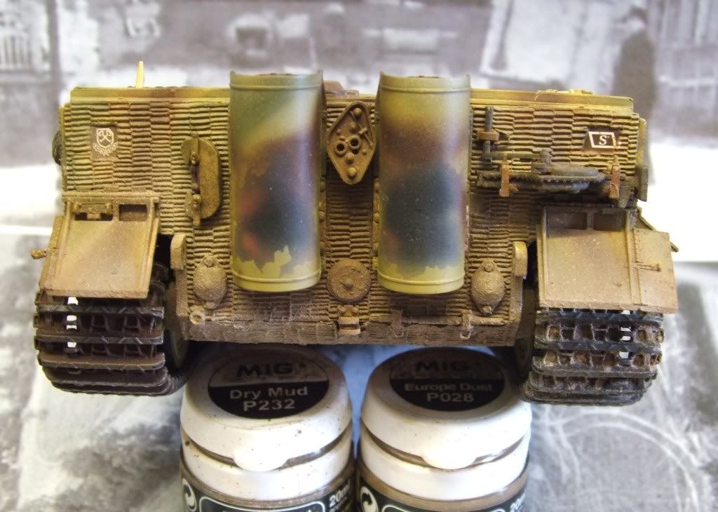

Right then, a little update for you... I have been 'messing' around with pigments, pastels and chalks in order to depict the soil of Normandy that these beasts chewed up spat out and trudged across the area with lodged and spattered on them. Here for your considerations are the results.
What do you think then? Another thing I have been contemplating is the actual surface of the N175 and other major roads in the region, due to the detritus of battle and probable interruption of any major maintenance or repair of the road infrastructure during the occupation of France, it is sometimes hard to determine what these larger carriageways were manufactured with, tarmac,asphalt, tampered aggregate or concrete? Looks like the trawler nets will have to be cast again!
Thanks for dropping in again... Back in the morning with the other side and some mud on those bare shrouds.

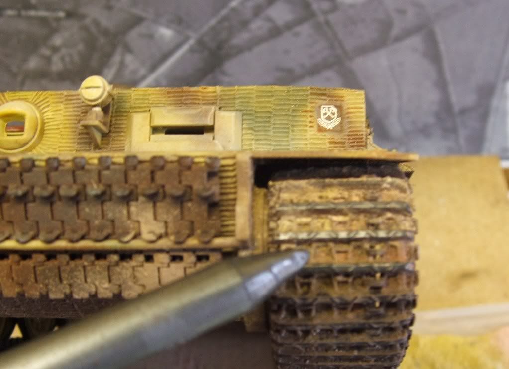

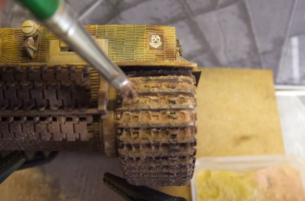

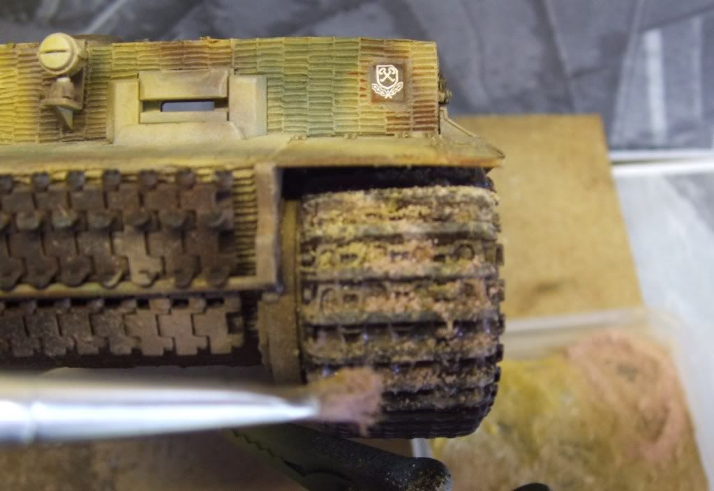

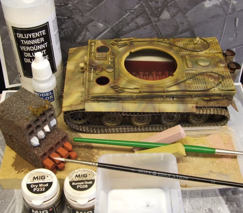

HiLo People! Just a quick update on the track weathering...
Firstly here are the mediums and materials used.
For the 'application medium' I mixed 50% Vallejo Matt Varnish #520 with 50% Vallejo Airbrush Thinner. Mig Productions Europe Dust P028, and Dry Mud P232 were mixed roughly equally as well as being used separately. Conte Pastels were powdered on emery cloth, along with some more vivid earth tone Water Soluble Artists Landscape Pastels.

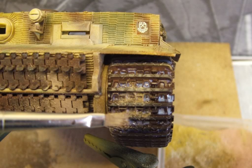

The recessed track areas were then dabbed in a randomish fashion, in order to represent the 'dropout' and the 'pickup' of dust,mud and general filth...This was a major livestock farming area so... There must have been a bit of the proverbial about eh!
Then the base Mig Pigments were applied by again dabbing into the recessed track area.
Followed by mixes of the pastels and pigments.
Working selectively where you want to create the 'mottled' effect of these heavy vehicles running over softer substrates.
When happy with the placement of the pigments and pastels, you can 'fix' areas of the dirt and dust application with random dabbing of a flat headed old brush.
To remove any 'overspill' of pigment from the track face and cleats with a 'moistened' thumb.
If you are not happy with the look of the 'worn' track areas, a quick reapplication of graphite or other metallic medium you prefer to use.
There! Jobs a good 'un', I should be able to finish up on this Tiger by weeks end and move on to another! Just for variety eh?
Right Sunday things to do... Back soon, Phil.

Masterclass, best track weathering by a long 'chalk'.

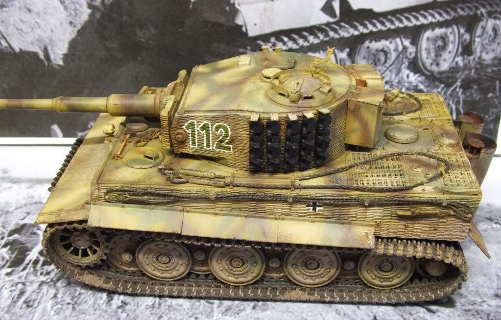

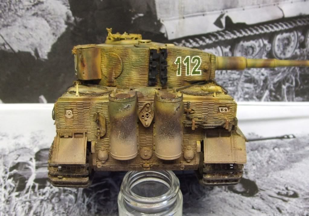

Speaking of tracks, alittle more weathering has been applied, as well as a touch up on the contact areas, along with some intial 'mucking up' of the exhaust shrouds, along with some restrained chipping on crew used/abused areas. The tools need 'graining' and the spare track links stowed on the turret need weathering up a tad, a bit of a light dusting, and some footprints for Rob... And we should be able to 'shelve' this until the other Tigers in the 'Ambush' are ready to kick up a bit of dust on the N175!
So sorry for the little sabbatical lads, see you real soon... And thanks again for dropping by.

well done on "112" The overall effect of weathering and wear and tear makes the Kat alive. Again thanks for taking the time to document your progression on "112" and sharing it with us. I hope in the near future I can share a build or two with you and the other forum readers.
