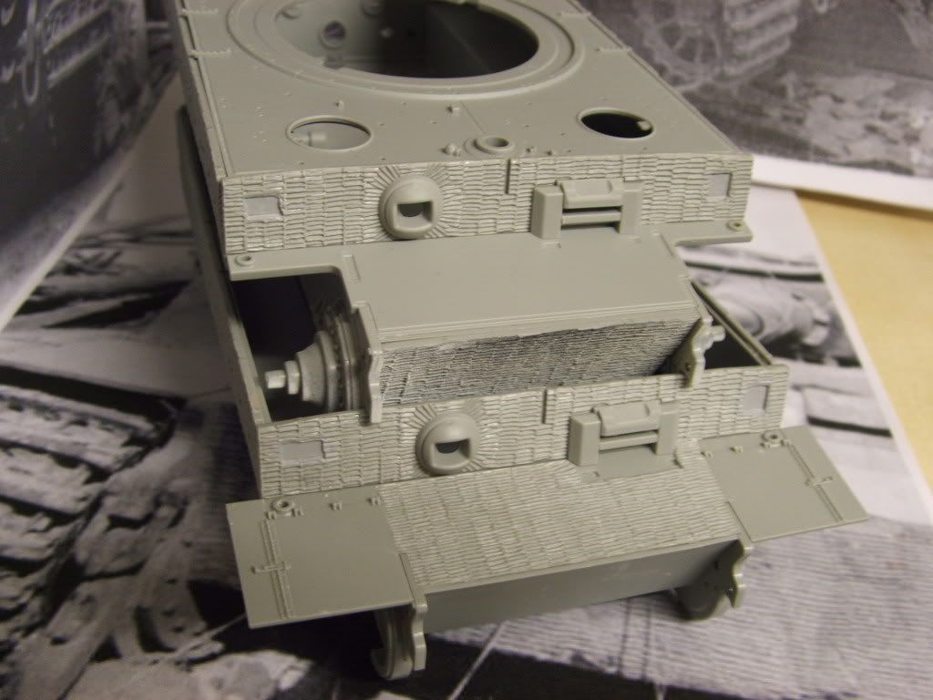

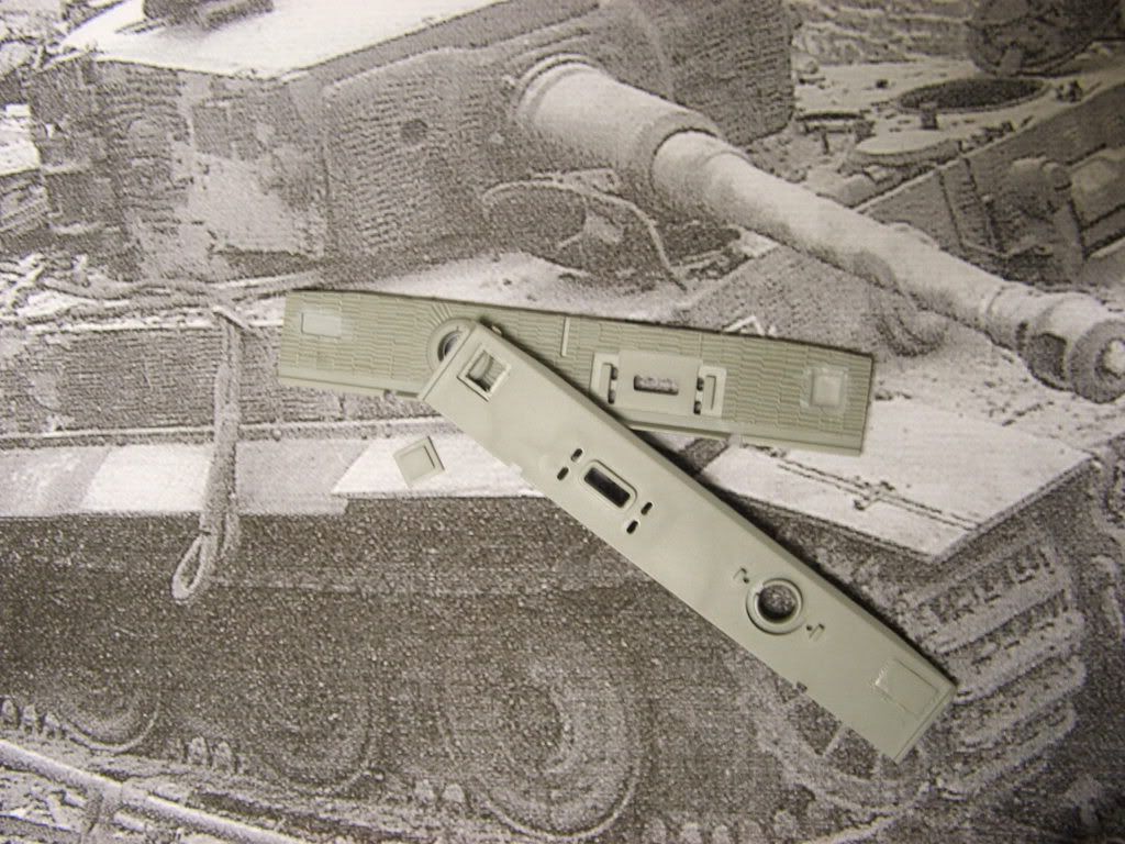

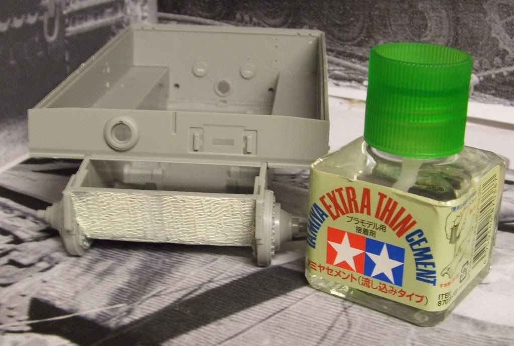

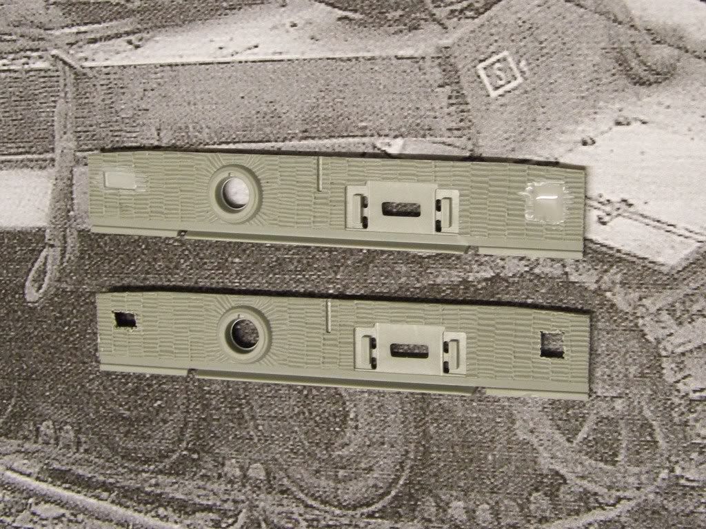

Morning All! Right glacis plates... These blighters and the fit onto the hull with the DML Tiger1's has caused some headaches for a while with modellers. A lot of people use a 'sprue spreader' to push the hull apart in order to take the glacis part. When dry fitting the glacis and the bow-glacis-apron you can have a situation a bit like a frontal strike at point-blank from a IS2, as the glacis and apron 'eject' from the 'sprung' hull skywards! I have a different slant on this issue (I thought you might... I hear you say! ) but more on that after this...
The glacis on #6383 has as we all know optional plug parts that sit in tooled recesses moulded into the rear of the part. These are removed at the lowest point in order to represent a bare armour patch on the face, when the plug is inserted. Then you can represent a late Tiger 1 from the HQ/1st Platoon/2ndPlatoon of the 1st Kompanie of the s.SS.Pz.-Abt.101 in Normandy '44'. The third platton had mids! Though when the 1st Kompanie transfered to the KT later in the campaign some of their late Tiger 1's were distributed to the equally decimated 3rd Kompanie. There is also a theory that a 2nd Kompanie Tiger had at least a 1st Kompanie hull... but thats another story and issue altogether! I told you these LAH Tigers were a tricky bunch
The sections to be removed are drilled from the rear with a micro drill to aid the 'cutting' of the part.
After the aperture has been opened up and you have trimmed the edges to a fairly smooth straight degree it's time to fill that opening. Now we can insert the plug and fill any gaps with Mr Surfacer whilst also bringing up the depth to a shallower level in stages, you could use some thinnish stock styrene sheet to speed this process up if you so desire.
And with that done we skip past a whole heap of the 'instructions procedural stages' and glue the glacis onto the hull!
Dragon themselves upon their website FAQ highlight the 'intentional warp' built into the hull of their Tiger 1's, and explain away the whys and wherefores, with this in mind and not having anymore than one pair of hands, I use the glacis itself as the spreader. This part is intended for the job, and when fitted and dry, all the corresponding parts, hull roof and bow-glacis-apron fit like a dream. Though on the zimmerit parts of #6383 the lower edge of the moulded zimmerit pattern slightly fouls the moulded zimmerit pattern of the BG apron part and you will get a much better fit by carefully removing some of the moulded surface texture before fitting. I have also softened the texture with wet and dry sand paper initially, upon the near horizontal apron part, as upon images of this area it is very hard to see the zimmerit (if applied) as being the main mounting point for the crew (hob nail boots and a ceramic ridged surface!!!), and a natural trap for detrius and mud etc always looks less textured. So with the glacis in place, the warp of the hull gone we can now safely dry fit the bow-glacis-apron and the hull roof if you are scepticle! (trust me I'm as paranoid as anybody, the fit of DML's parts are excellent with very rarely any filling needed, the one thing you notice doing mutiple Tigers is that the hulls all have a slight variation of 'warp',)
There we go 'spreaderless'! That should help if you are doing an interior!!! Back to #6383 then. You can now fit with ease the bow-glacis-apron of your choice. You will notice that I am only using one of the zimmerit parts for the apron, I am going to paste the mugard-less one as I am not too keen on the PE solution for the join to the bow plate.
And here are the other hulls wating for their 'paste job'!
Here I have tried to capture the subtle texture of the near horizontal surface appearance of the bow-glacis-apron from a near 1/1 viewing angle, you can see that it does look less heavily textured from this angle, than the rest of the zimmerit pattern.
There you go then we are nearly at the point where the hull are 'shunted' for finishing at a later date! Only joking, I have been told to complete thes kitties and that I will. Back later, thanks again for looking in and all the comments and support! You can post on the thread if you wish, I don't bite! Honest.
Cheers Phil...

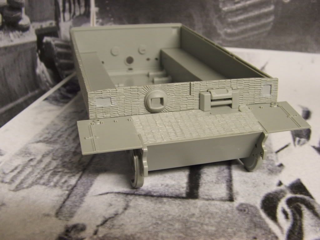

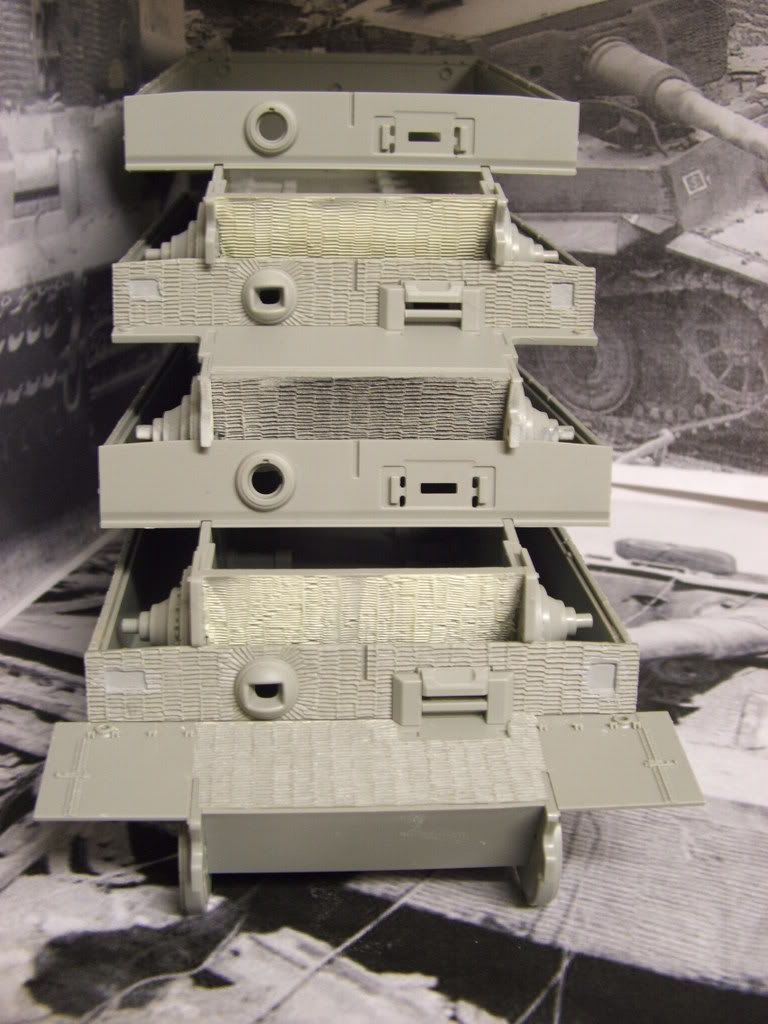

Hello All! Hi there Geraint! And welcome aboard this thread Dennis! Right lets get back to where we left off, glacis plates... Now we move onto #6406 and #6416 and the application of the pattern with epoxy putty and applicator roller tools. Again pea sized lumps of putty are placed onto the parts and spread to an optimum depth of between 0.2-0.3mm, as this minimises the build-up I call 'roller-splurge' between the rows.
With this done you can start to apply the zimmerit pattern around the two major obstacles on the glacis plate. Radial around the bow mg (kugelblende) aperture and vertical rows either side and above the drivers armoured vision block, the rows between the two columns above the vision block often vary in width on the real things as seen in period images.
Now the pattern can be applied across the glacis plate part, from the centre outwards or from one side to the other! Or the individual sections between the obstacles.
With a little practice you can actually start to give a fair representation of an individual vehicle(providing you have enough reference material ) Zimmerit can almost serve as a 'fingerprint' for Tiger 1's and other AFV's with it applied.
Next up is the optional part included that I have decided to use on the #6383 (modded) rather than the moulded zimmerit kit part supplied.on here it is best to spread the putty as thinly as possible 0.2mm max, as this area when seen upon the actual vehicle appears 'flatter' and less textured in relation to the vertcal planes on the tank.
For this pattern depiction I will use a sharpened flat headed 4mm screwdriver head, much in the same fashion as we used for the 'ommited' zimmerit from the angled small plate on the lower rear hull of #6383. In order to copy the pattern used on the moulded pattern on the hull of #6383 start at the top of the area, indent the tool into the putty and move down at a flattish pitch towards the 'bottom' in roughly even rows.
Her are a few shots of at a lower angle, just to show the softer appearance of this ''camera shy' area of the Tiger 1.
So thats that, as far as pasting for #6383 is concerned, next up is the BG pasting for #6406 and #6416, along with some attention to zimmerit joins on the four corners of the hull and replacement of small areas on the turret. Here are the turrets and hulls 'mated' just for some sheer Tiger image oppurtunity.
See I told you we would be getting some fully built Tigers at the end of this
! Just 64 torsion bars 128 roadwheels and other running gear and these kitties should be 'sitting pretty'!
Cheers for dropping in ... Phil

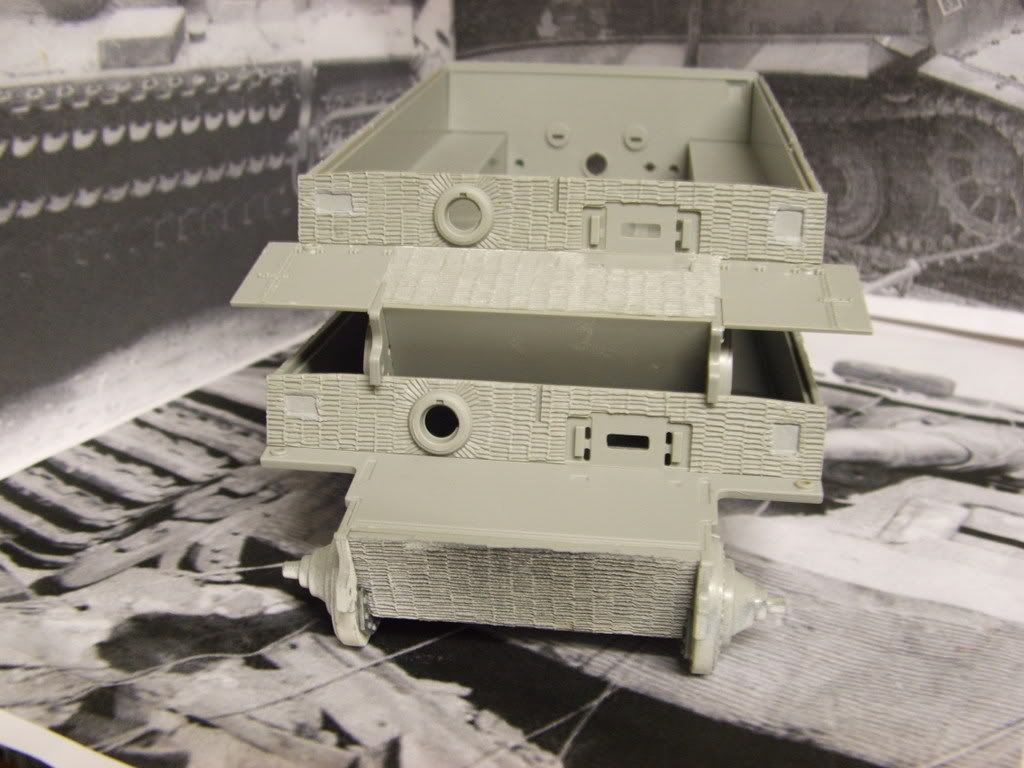

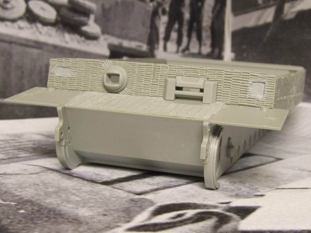

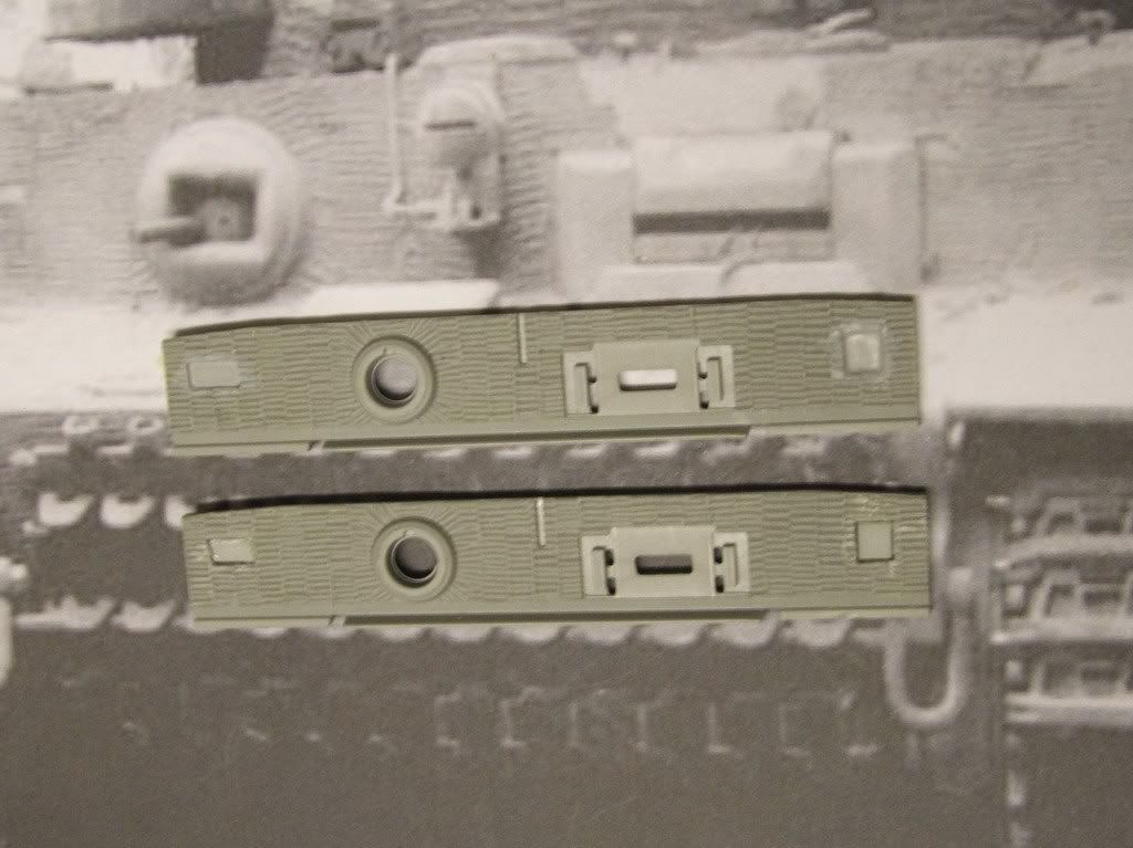

Wotcha! Pasting the bow-glacis-apron of #6406 and #6416, is the task for today. Once again... possibly the last time on this build-log? Place a small quantity of Tamiya epoxy putty onto the part to be pasted, and spread to a depth of around 0,2mm with an artists pallette knife.
Now you can get to 'rolling'! Using the Lion Roar tool you can use the corresponding 'doe foot' part in order to reach the areas towards the rear of the BG-apron where the roller cannot get to, and with the AFV club applicator tool, you can use the 'stamping' ends of the tool itself to imprint the pattern upon the areas where the roller doe head cannot get to.
With these tricky little areas sorted, it is just a matter of 'rolling' the pattern in roughly even rows across the BG-apron from front to rear.
And as usual for comparison, we include one of the #6383 hulls with it's older siblings!
If you want to leave this area free of zimmerit, that is fine as long as you don't see it on your reference images, as the OKW order was for zimmerit to be applied to 'all vertical armour plate' on all armoured vehicles above a specified fighting weight able to support the extra weight, with the intention of not applying it to horizontal surfaces (tell that to the 'workers' who applied it to Stugs,PZIV's wherever they could!) also with this armoured part of a 'lowly' 62mm sat over the transmission and final drives, you really wouldn't want a MAT-mine being slapped on their if you were the driver or the radio/bow mg operator! Mind you with this area being near horizontal a well placed mine would have a chance of not sliding off either!
Right torsion bars etc to be dealt with and onto the fun bits! Though I was thinking about those turret vision slits on the 'modded' #6383 now we have another one we can leave alone. ;
Cheers for lokking, Phil.

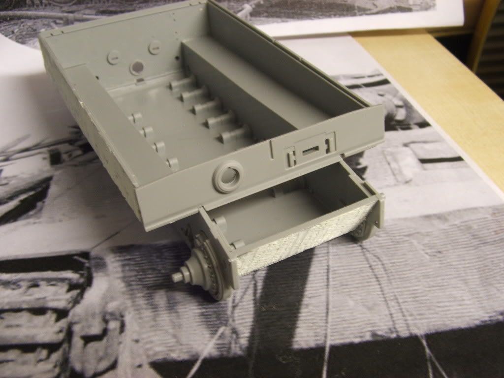

Hi Martyn, hello Ant, plenty of room on the engine decks of 'Kampfgruppe Appfelmetre' Sanity is 'overated' eh? Thanks for the words of encouragement. Not much to report in at the moment, bogged down with a few life and work things along with schools closed for the six or so inches of 'the white apocaylpse'. Mainly I have been stripping sprues of the relevant parts for the suspension torsion bars, and running gear. Along with removing the armoured turret protection ring, on the hull roof of the finer zimmerit pattern turreted Tiger.
One hull done three to go!
See the hull roof fits nice and snug even following the rebelious construction path, just remember to glue the hull sides to the glacis when you do finaly fit the hull roof.
The removal of the moulded turret protection ring is quite tricky, as I am really trying not to mark or remove any of the hull roof itself.
A light sanding and a covering of Mr Surfacer 1200, and some roof stowage re-arranging and we should be nearer to David's template for this production variant of the late Tiger 1. Please feel free to make corrections if I veer of course on this David... Please. Okay back to the mountain of torsion bars...

Just a quick update on the bow spare track rail. Here are both the parts C15 and K3 (fair dues, they are very similar looking!) And the 'MasterClub' (MC135005W) Pz.Kpfw. VI Tiger late resin Tracks in place, all that is needed to finish them off are some full length track pins in the drilled link holes.
Just a matter now of waiting the delivery of the PE and other track options, so some work can be done whilst waiting on '122' #6383 OOB and some more 'modding' on a few areas!
Back tomorrow... Phil.

Looks good Phil.. Nice to see one of Tigers starting to look a little complete.
A little word of warning about drilling right thru' the Masterclub links. They're a lot more brittle than drilling styrene and the drill bit can go astray very easily. I broke or drilled crooked on quite few when I first used them... So careful, slow and straight basically.
This is fresh in my mind because I've just drilled 12 Panther links for track pins today., and messed up 3 in the process But the Panther links are much more fragile than the Tiger links
I'd noticed the C15/K3 mix up too.. One for Dragon to put right on the Mid Tiger kit (in my dreams)
