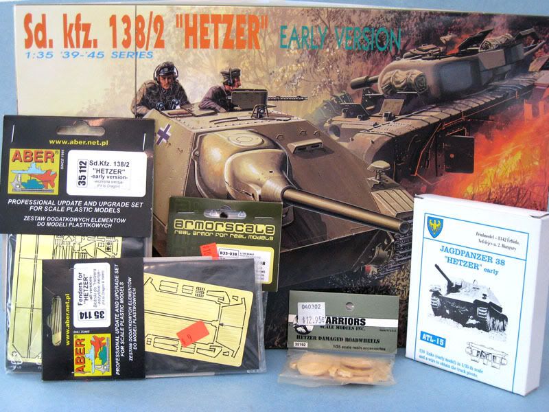

This build log is to compliment my in-box review.

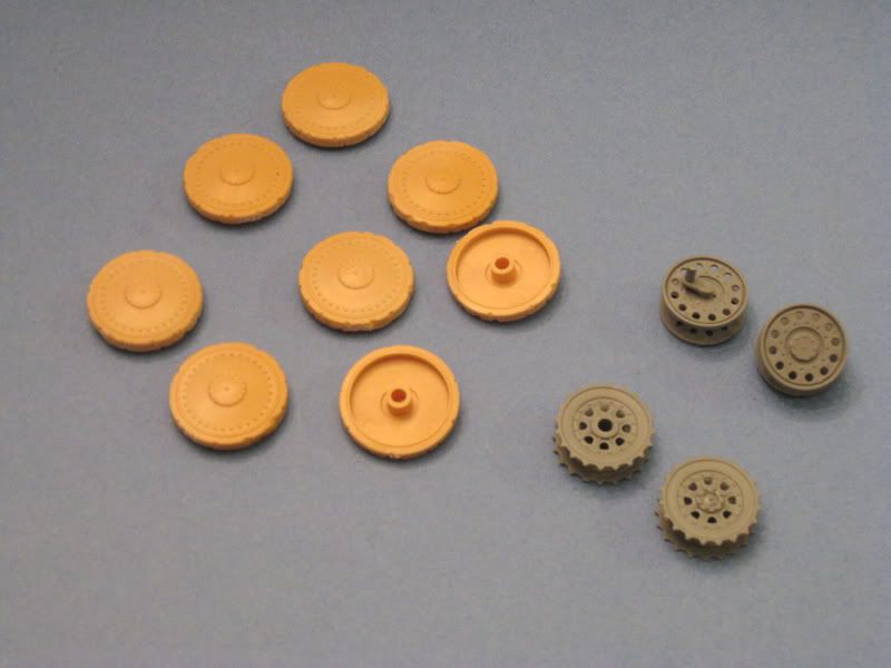

I have used the kit drive sprockets and idler wheels, but am using the Warriors damaged road wheels. They aren't particularly more-detailed than the kit ones, nor is wear & tear on rubber wheels hard to do with any Xacto knife, but I picked the set up cheap from another member and just wanted to use them here. I plan to make this baby well-worn and used.

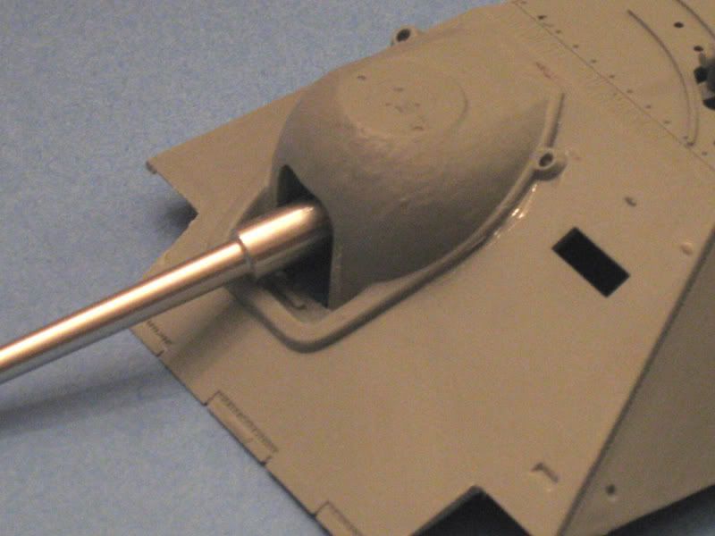

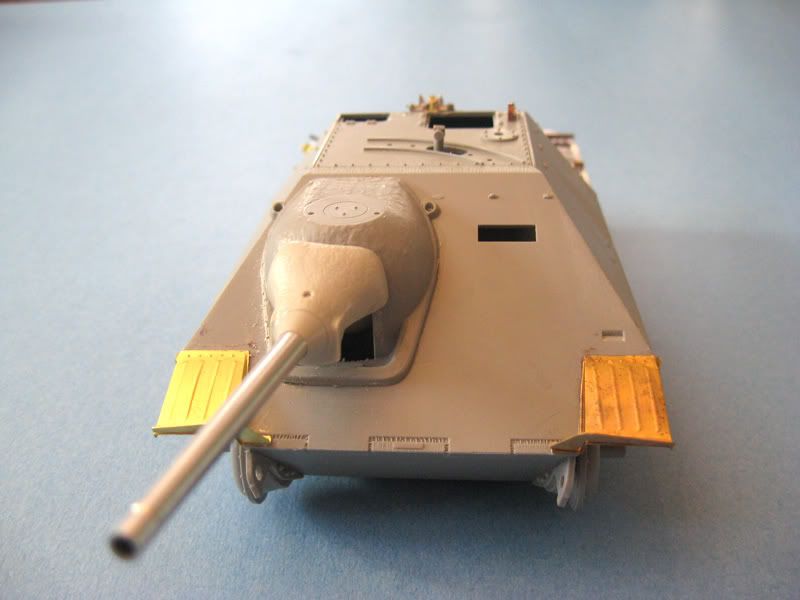

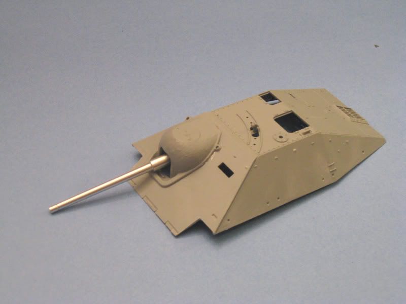

The kit comes with an average two-piece barrel, so my first choice was to #$%^-can that in favor of an Armorscale one. Had I known about JB Models, I would've used theirs instead, but that's another story, LOL!

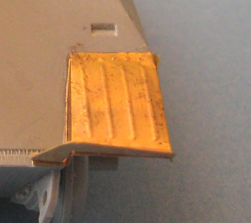

The Aber sheet of PE has some excellent touches, including these very well-rendered front mud guards:
In general, the kit goes together quite well, and I have few complaints about fit, etc. There are a few uncharacteristic (for DML) knock-out holes that required filling, including the front tow hook arms.

Thats a lot of AM your throwing at this one.
You're right, Deano. The kit comes with individual tracks, but they're attached to the sprues, so a LOT of clean-up right there. Might as well go for Friuls, though the set cost me more than the kit, LOL! The barrel, again, is a no-brainer for me. I just feel better with an aluminum barrel, no "truing" problems or clean-up.
The PE really makes this kit IMO. Lots of detailing that just isn't there with the kit. You get a small sheet of steel PE which is hard to work with.
And I owe a debt to Bill Plunk for arranging all the extra stuff in front of the kit. He taught me to identify what I use.
