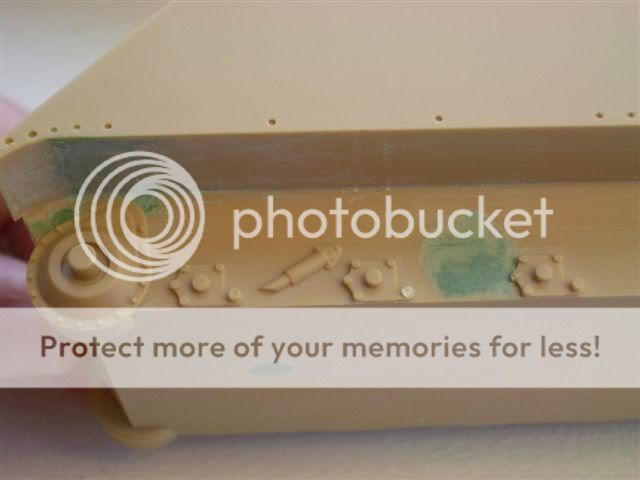

Have spent a while cleaning up the old academy hull.
1. I cut a notch into the hull where there is a distinct join and weld seam between two armour panels.
2. I ground off the 2nd shock absorber. A1 M113s have shockys on only the 1st and 5th roadwheels. A2s onwards have shockys on the 1st, 2nd and 5th. I also have ground off the locating lugs for the track shrouds and filled the prominent hole in the front right sponson.
3. Installed the excellent Mouse Armour M113 fuel tank. The kit supplied fuel tank is inaccurate for all but the earliest M113 gasoline vehicles. The Mouse House fuel tank represents that factory installed tank and as such will work in a US, Canadian etc. vehicle. I have detailed this area with lead wire and plastic stock and a Maple Leak Modelís ramp cable pulley assembly. Also note the sponson reinforcement plates modeled from white plastic stock.

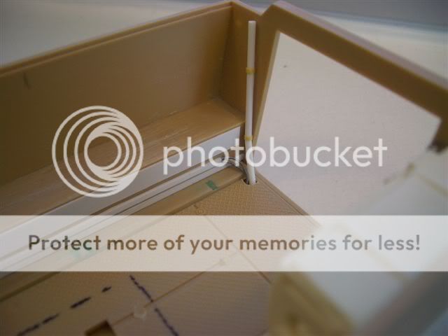

4. Rear right sponson details include bilge pump pipe, fuel supply pipework and conduit which travels along the right sponson wall. And finally the sponson reinforcement plate.

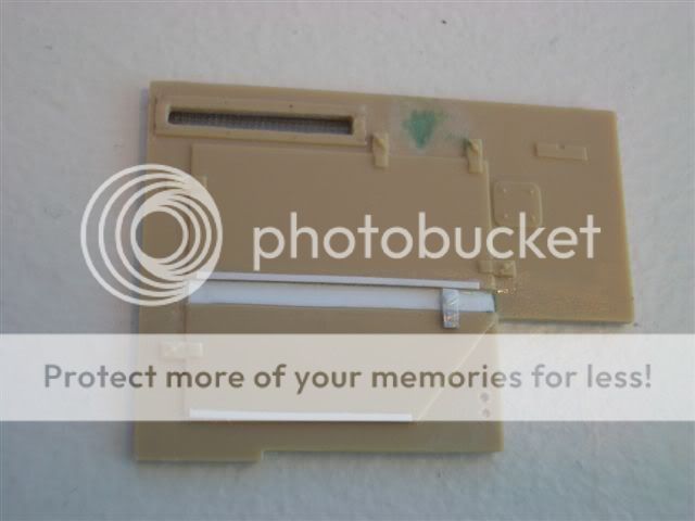

5. Corrections to the fire wall. The kit comes with a fire wall which includes a 1 piece engine access hatch, however early in the production run this was modified to a 2 piece engine access hatch arrangement which is common to almost all M113s used across the world. Also note I have removed the cdrís 2298 radio junction box (where the green putty mark is). I will replace this later in the build with the Aussie Armour Radio Installation components. These are more accurate and allow the use of lead wires to represent the wires use on the real thing. Finally note the ventilation panel added to the top left corner. This appears to be an Aust specific mod I have seen it in many aust vehicles.

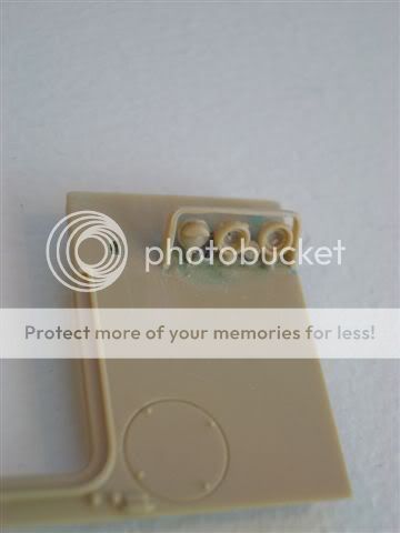

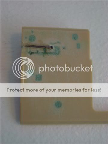

6. Glacis plate lights assembly. I am doing this work early in the project as I intend to mount the pivot controlís assemblies on the reverse side of the glacis plate so I wanted to get the front details sorted and then sealed up all the holes before I start on the interior details. The right hand lights require allot of work as they come in the academy kit all mounted on a single strip of plastic which is quite visibly incorrect. The Eduard PE approach also results in a highly visible strip of PE located on top of the glacis plate which is also inaccurate.
My approach to fixing the right hand lights starts with sealing up the slot for the supplied light strip. I donít like to use evergreen styrene strip (the white stuff) for this task, itís too soft and does not form a good base for mounting the lights on. I prefer to use scrap plastic from the kit to seal up the slot, itís denser and forms a more robust surface to drill into when drilling holes for locating the lights.
Once the slot is filled I grab some individual M113 style lights from the spares bin (most M113 kits come with a few spare M113 lights). For the blackout lights I drill a hole for brass wire to mount in holes to be drilled in the glacis plate. Why brass? So if I get the angle wrong I can bend it a little to correct. Now I drill the holes in the now filled slot on the glacis plate for mounting the lights. Also note I have drilled out a plug for fuse wire to represent the lights wiring. There are 2 such plugs in between the black out light and IR light and in-between the IR light and normal light. (If you donít have enough spare individual M113 lights you can always just drill out the kit supplied ones supplied on the strip and mount them on brass wire like I have with the back out light on the far left)
I have also drilled out the headlight lenses so that later I can mount some MV lenses.
Finally I filed down the brush guard to a more scale thickness (I think this approach creates a more accurate depiction of the lights than the kit or Eduard Photoetch option). Not 100% accurate but pretty close.
Iíll install the Aust style indicators later in the build. Note indicators on a ARVL are mounted on the brush guard (but more on that later)
Also a shot of the back of the glacis plate. It shows all the filling and detail work in greater depth. The wires will eventually be visible disappearing behind the vehicle instrument panel - perfect!!!

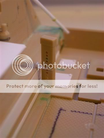

7. A shot of the driver's bay. Note access panels in the floor. These give access to the torsion bars under the floor. Note the driverís seat pedestal. In the academy kit this is depicted mounted to the floor of the vehicle and is incorrect. The seat is actually mounted to the sponson wall and does not touch the vehicle floor. Also note the mount the driverís seat pedestal is at an slight angle to the sponson wall not at right angles as depicted in the kit.
8. Finally a shot of the driver's bay details. Note all the assemblies are blue tacked in place. Any comments of their placement would be welcome?
Pictured here is the bilge pump pipe, Instrument panel, fuse box, mount for the night driving sight mount (when not is use), driver's F88C, driver's 2298 (radio and intercom box) and vehicle engine fire extinguisher system.
Have not yet finished detailing the sticks.

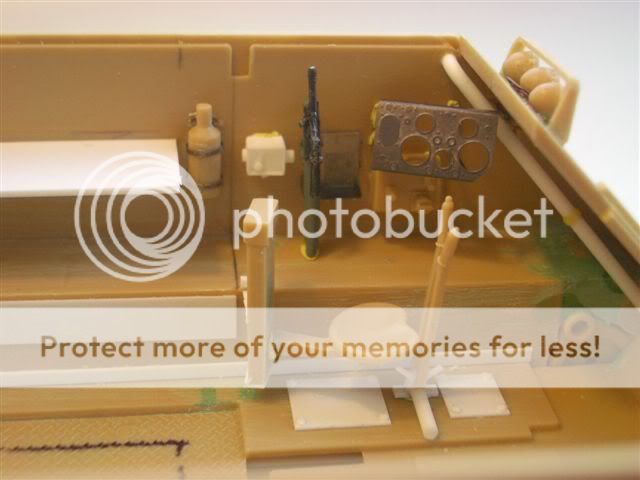

Inside of the glacis plate with the pivot controls.
Modified interior roof details.
Fire wall for driver bay.
Right hand sponson.
Drivers bay and left hand sponson.
Drivers bay.
A few more details to go and then I will strip out the tacked in details and paint and weather. Will fit the 1780 and wires for the radios after painting.

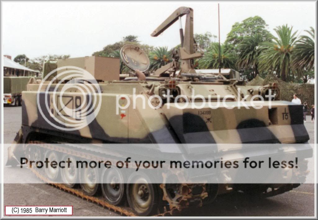

I must admit Iím a bit confused on the radios. I was toying with laying them out like this based or your advice.
However a bunch of photos of different Aust ARVLs I have always seen the hydraulic system reservoir in the front right sponson. So it would look something like this.
The only detailed set of pictures I have for the ARVL is a Canadian vehicle at: http://good-times.webshots.com/album/563768805zrquIq So when I found the below photo I thought there would not be enough room forward of the reservoir for radios. In an aust vehicle the crew heater would not be there but Iím thinking we would probably have the hydraulic system oil filter shown in this pictureÖ. The Canadian radios are laid out like these:
A bunch of photos of Australian vehicles show a layout like the below, but the details are just that little bit out of reach.
One thing Iím thinking; was your vehicle, with the radios in the right hand sponson and the 1780 on the firewall neat the CDR cupola, a Fitters track? Photo below:
Just hoping to get things right here. Many thanks for the advice mate it is appreciated!!!!

Posted: Sunday, March 22, 2009 - 02:14 PM UTC
Al,
Thanks for commenting I was hopeing you'd chime in on this thread. It's great to have a RAEME spanner/radio mechanic on this discussion group as I think I have only ever spent about 30 seconds in an ARVL.
W
Your right, I was discussing this with a friend who thought I was muddling it up between them, I got muddled between the Fitters and ARVL. Both the fitters and ARVL had the radios at the front of the right Sponson with 50 cal stowage below them. We had two 524's fitted one above the other. We had a Bin Pack in the left sponson and crew stowage on the shelf (maybe the bin pack is what i am thinking of? None of the Fitters or ARVL's I served on had 160's they all had 46/47 sets then RAVEN. The 1780 was on the front wall as I used to smash my knee on it when my driver got carried away and I have a recollection of recabling the car when we did a major service and relocating it to the left wall.
I can't remeber having F88 racks either as we had just been issued with the F88C when I joined the unit. All the A vehicle crews were issued a Browning & F88C as pers weapons. THe Brownings were carried in locally purchased Black leather Shoulder Holsters. CVC's were mandatory for all my crews.
Sorry to scare you.
Al

Wayne, I'm working on a pic of the thumb gaurds for you. And to be honest, I was being a smart a**e.
The radio fit out in the ARVL/Fitters would have been like the LR110 FFR, wouldn't it Al?

Posted: Sunday, March 22, 2009 - 10:29 PM UTC
The radio fit was literally 1/4" Alloy plate welded like a bookcase with shelves to which the 1029's were bolted. The ARVL one had the hydraulic connections where the bottom Ammo stowage would have been and the two top shelves filled with 524's or a 524 and an empy 1029 mounting tray. When we only had one radio we tended to use the middle tray as the top one caused too much heat build up and i was forever readjusting the Squelch settings.
My memory is slowly coming back from 15 years ago and this is a great example of you can't always go off what a vet says.
Sorry for the confusion Wayne.
I'm really looking forward to seeing this one. If you do 88 then her name was "REICHFUHRER" and removed in 94 when we became 1 BASB (1/10 markings - the tac plate for 101 also happened to be 88). The RSM hated Spanners and had us remove all our vehicle names. THe ARVL technically belonged to Recovery PL and two of the Fitters tracks 88A &88B belonged to Vehicle Platoon whilst the third Fitters belonged to the Forward Repair Group (88C or F depending on exercise) as did I at the time as the ART Tels. We only served as a functional group during Brigade level Exercises but I was put in charge of all A Vehicle related activities including Training. Thanks to the Readies we actually got so much ammo for the 50 Cals that we could have the whole unit have a Shoot and have enough left to do Battle runs - a rarity in RAEME units where you were lucky to get a liner a gun. The 50's hadn't been fired in over three years before i got there and were in the most part incomplete or unserviceable.

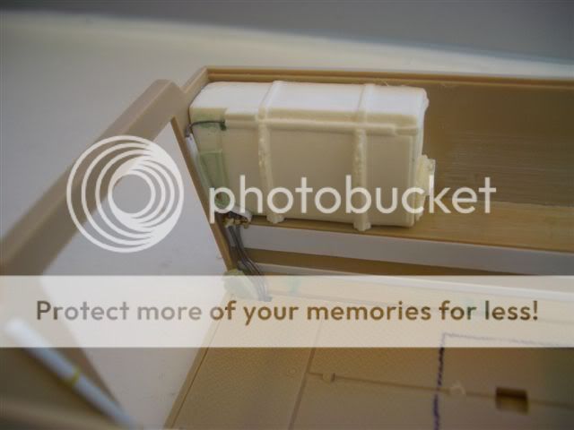

Have mocked up a basic shelf layout with plastic card. Most is hidden by the hydraulic reservoir anyway. Note I have had to shave some height off both 1029 mounting trays to create enough room for the shelves but I think it looks ok. I did want to mount 2 radios in my vehicle and I decided to go with a 524 and a 77 set as my regiment never had enough operational 524s so only troop leaders would get 2 x 524s. Whatís a vehicle mounted 77 set called again?
I decided to move the hydraulic system filter down onto the sponson wall (blue tacked in place) as I there is no room for it anymore attached to the hydraulic reservoir now that the radios are in place, I could not figure our any other place for it to go.
I have placed the winch counter balance valve (rectangular boxy thing on the engine firewall next to the 77 set). The MLM instruction shows it located here. So I placed the 1780 and 2298 on the firewall from right to left next to it.
Attached below is my mock up of the placement of the hydraulic system and radio components. Have predrilled hoes for the all hydraulic / radio lines and wires but I will have to wait until after painting the interior and assembly to install the lines themselves as they will attach to quite a few subcomponents that I need to keep separate for painting.
Now itís just the long slog to get through the rest of the interior minor details to get to painting! Lots of wiring and titch components!
Any comments or suggestions welcome?

Hello all,
Figured Iíd take a few last photos of the interior of my ARVL before I coat it all in primer. Most details are still tacked in place to be removed for ease of painting.
Interior
One interesting detail here is the collapsible footrest for the drivers left foot shown (in the first shot below). The mod was added to all Aust M113 FOVs as a result experience from mine damage in Vietnam.
I also took a crack at detailing the periscopes. Nothing major as they will barely be visible through the hatches but I wanted to get the wing nuts in as they are quite distinctive.
