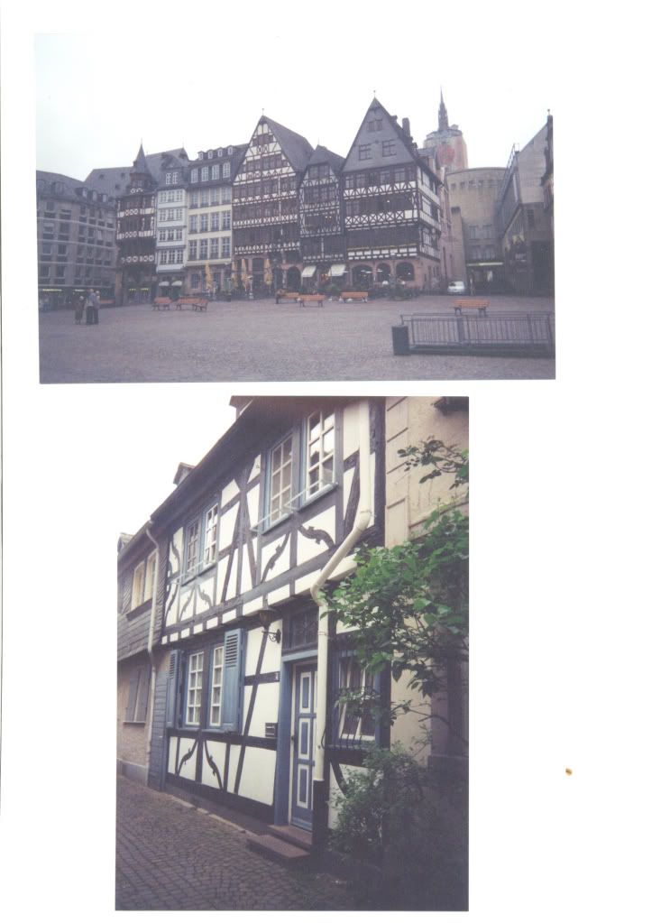

Posted: Friday, October 30, 2009 - 04:05 PM UTC
Don't forget alot of the "historic" bldgs are post war.
Top photo is all new construction from the 50's (this area was flattened in the Jan. 44 bombing. Bottom photo is in a small town about 5 mi. / 10 km away and is real historic ca. 1750's. The wood / timber styles are similar but few hundred years apart.
The door in the historic bldg does have a high door knob - but I think it was a fairly standard size door.
