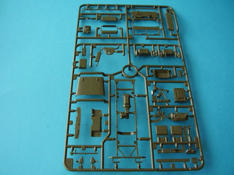

Well with the airborne trailers pretty much complete I'm about ready to move on to the 2nd of my Airborne Jeeps for the Op Market Garden Campaign. It runs until December if you have a mind to join up;
Link here
http://armorama.kitmaker.net/modules.php?op=modload&name=SquawkBox&file=index&req=viewtopic&topic_id=136186&page=1

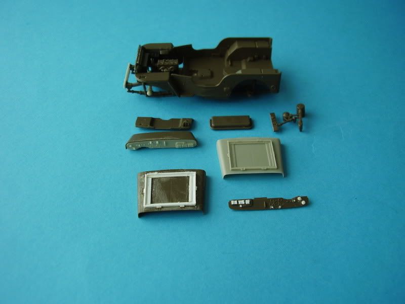

This is time I'm going to try the SIgnals version and James should be publishing a review on this soon.
Just a flavour of the kit as I still have to upload all the images etc.

The donor Kit;
The missing part of the 2nd spur are the drivers parts I have passed on to a good home.
I shall probably use these for the crew

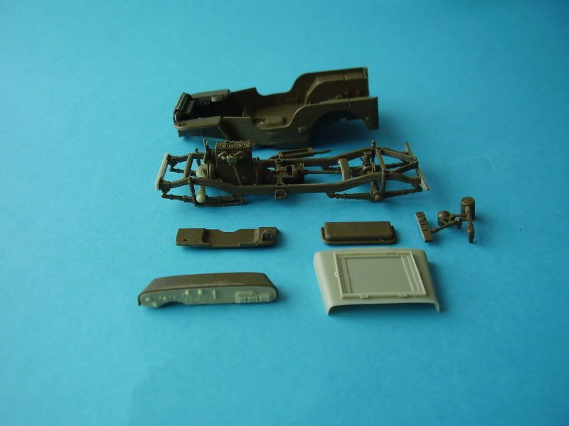

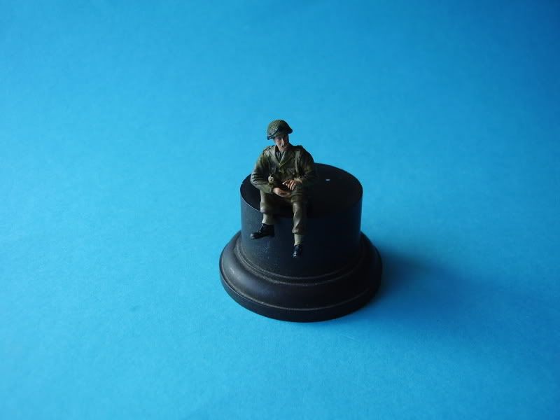

thought I'd start on the crew first, progress so far and a test fit in the RA Jeep
Al

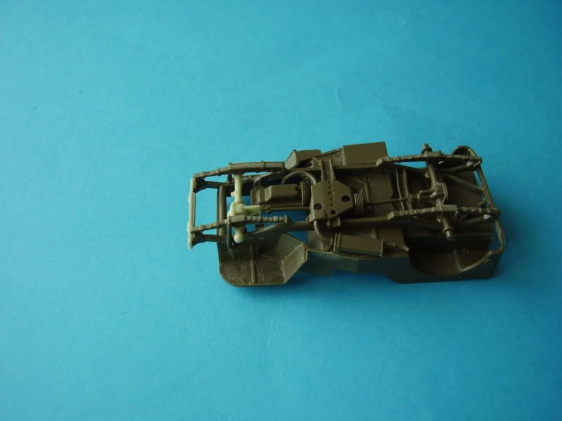

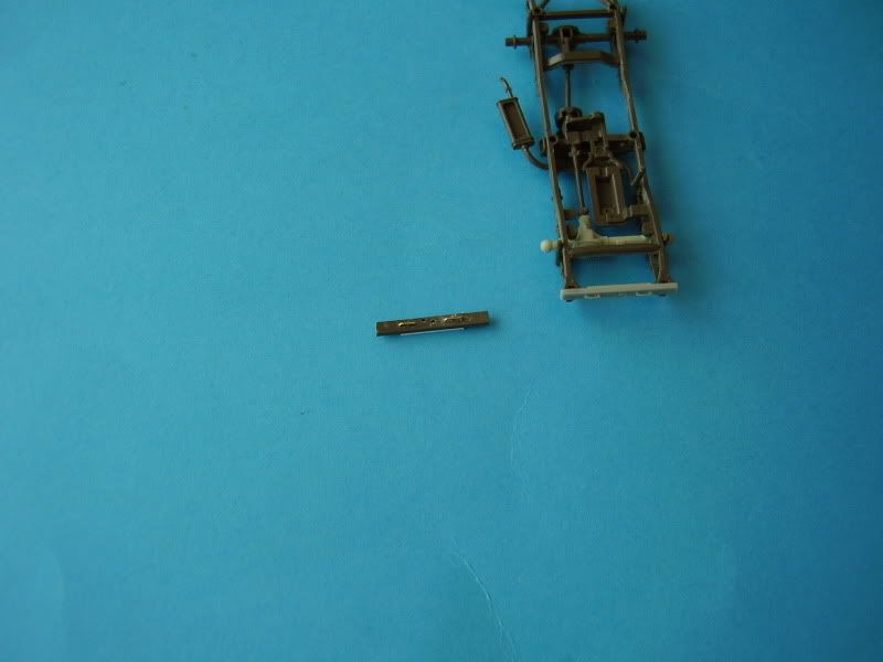

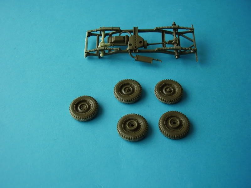

Made a start on the chassis and underside, removing the sink marks and flattening off the rear bumper. Also cut away the offside step. Instructions part 1:
Al

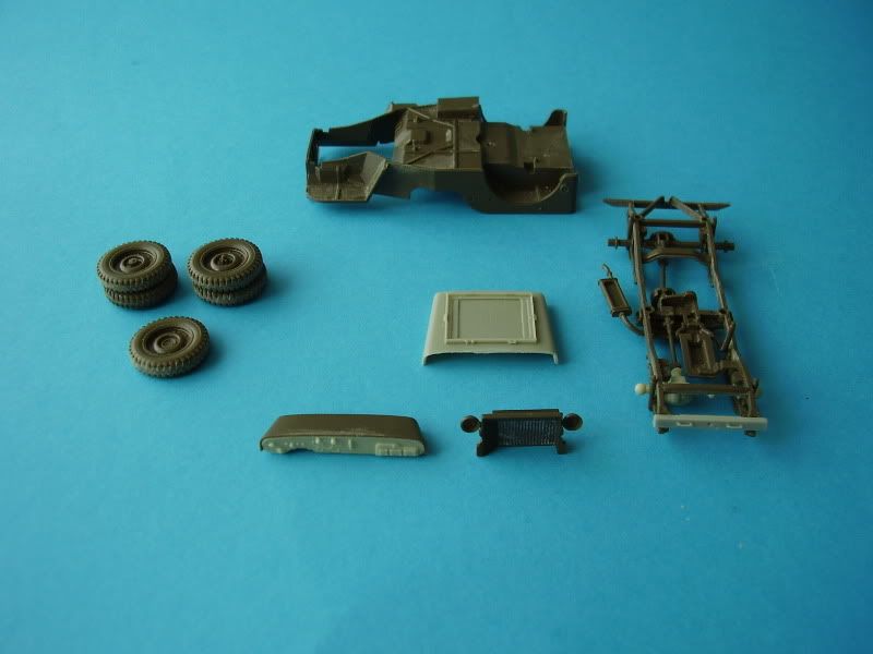

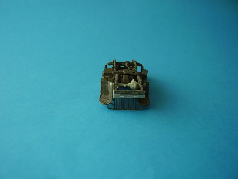

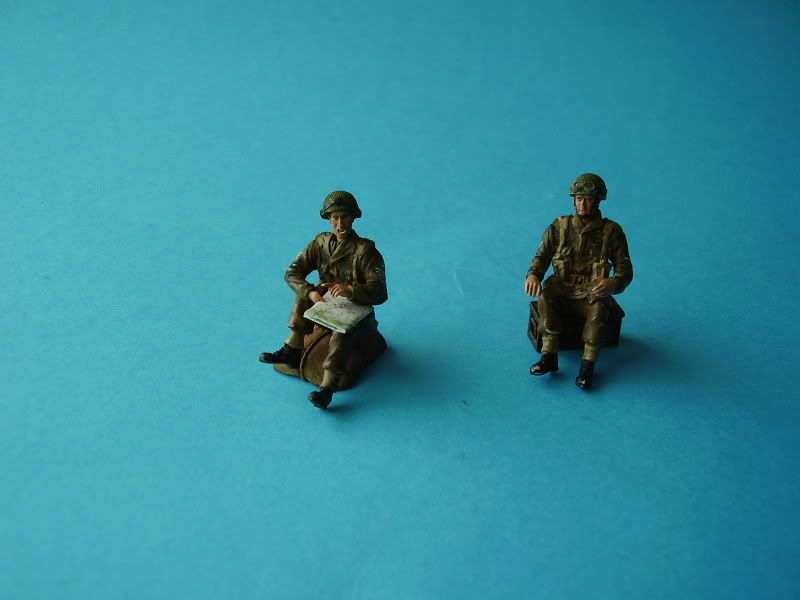

Some work on the chassis. Added the replecement front axel, that will allow the positionable wheels, also the reduced repalcement front bumper along with the springs and exhause. The rear bumper has been flattened and thinned down a little.
Some cleaning up of the sink marks:
and a test fit of the parts
the kit has a nice set of wheels but you do get a replacement spare in the conversion set.
Finally a little mroe work on the figs
Al

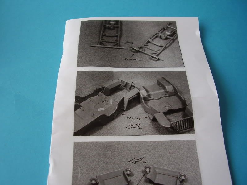

For Tony Roberts.
Scratch build details.
Hi Tony,
Iif you are following this and want to convert your jeep without the kit, then follow these steps. Remove the two projections on the rear bumper. Sand it smooth. Use the Tamiya front axel as normal and build the chassis. On the front bumper saw off each end at the point on the rear where the fitting bracket is (either side). The front bumper should be 25mm in length, then attach 2 small lifting handles (3mm in length) either side of the the starting handle hole. The hole will need moved so that it is central in the bumber. (Also just to clarify the starting handle hole is correct but you need a central point of reference to work from .) Look on the reverse and you will seen a small injection mark. The hole on my example if about a mm off, so drill another to give you a central point of reference.
Saw off the right hand step up on the jeep as shown - OK so far? On some examples of the jeep both steps were removed but it was the right hand one that caused the problem getting the jeep loaded into the Horsa so it was always removed.
Tidy up and seems lines etc on the chassis as normal. Clean up the injection/sink marks on the main frame of the vehicle. That will give youo the squat square look the jeeps had.
Al
Edit : Oh, and drill out the end of the exhaust.
