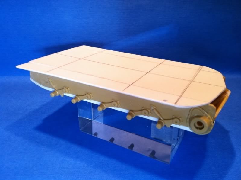

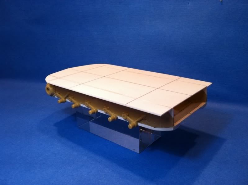

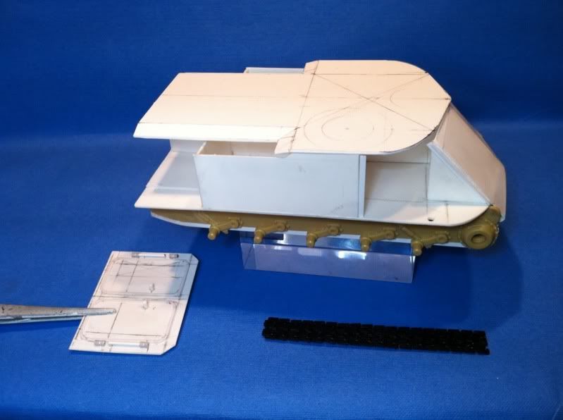

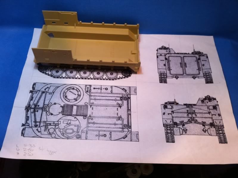

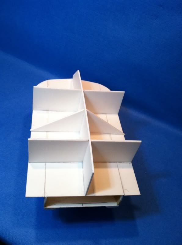

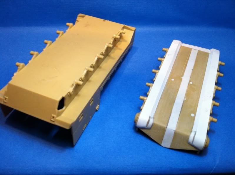

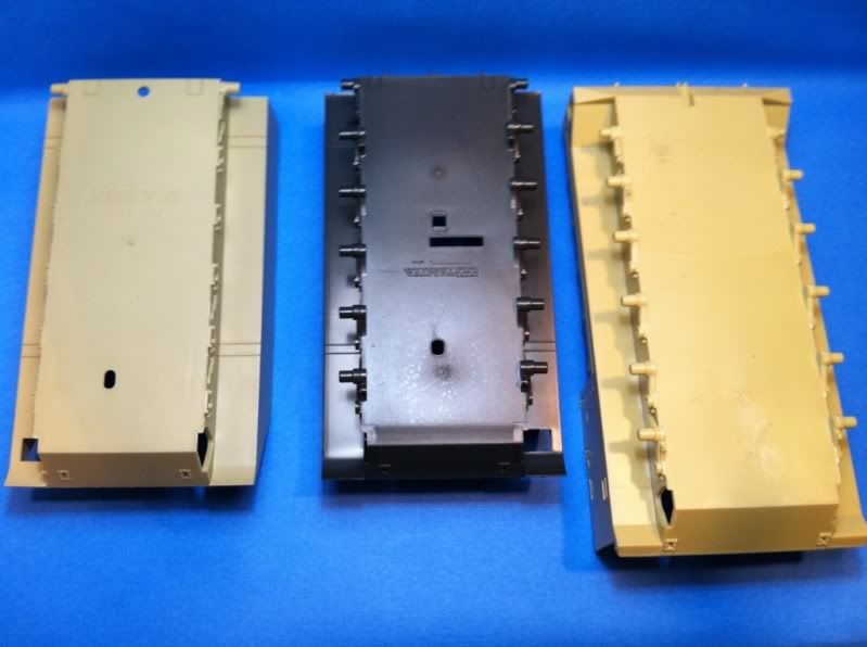

Like, I suspect, a few others hereabout I seem to have signed up for quite a few campaigns so I shouldn't really be doing this but the title gave me the excuse to build something that has been on my "to do" list for many years, the Swedish PbV302 APC or Pebba as I believe they are called. Something about the shape is just fascinating and in winter/splinter colours as well it should look rather nice.
I had heard that you could use a little of the basics from a M113 but it wasn't till I started that I realised just how little.
I compared both the Tamiya and Academy kits but both required lengthening and widening
Then I considered the AFV Club M548/Chapperal and it fitted the drawing that I had scaled to 1/35th just needing to be made wider.
So cutting down the sides,widening, building up the drive houseings and rebuilding the underbody does indeed leave little of the original left.

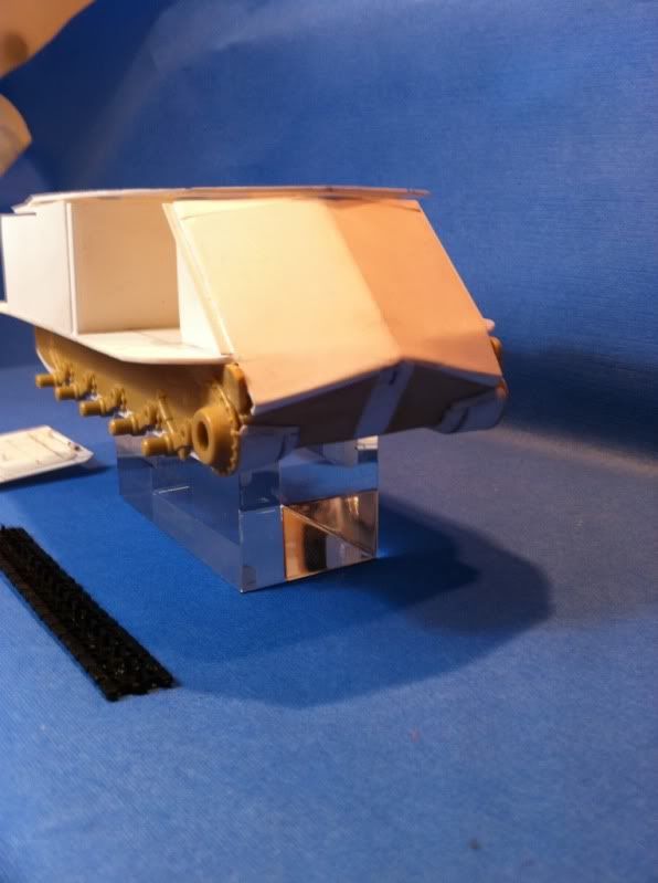

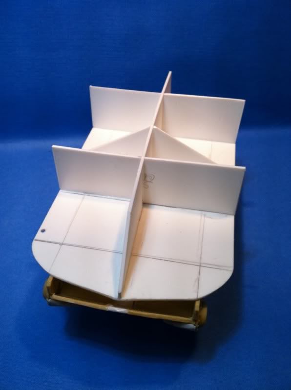

Next I put in the new floorpan onto which I planed to build the bodywork.

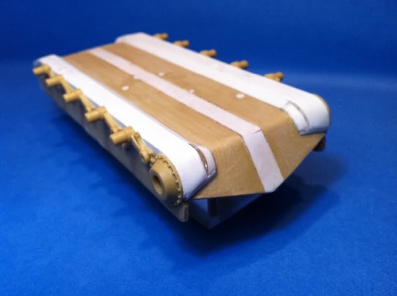

Then comes the compartment sides,the glacis plate, the roof and the rear doors.
It actually starts to look like the PbV, in outline at least.
You will of course notice that I have left the tricky bit, i.e. the curved side panels till later.
