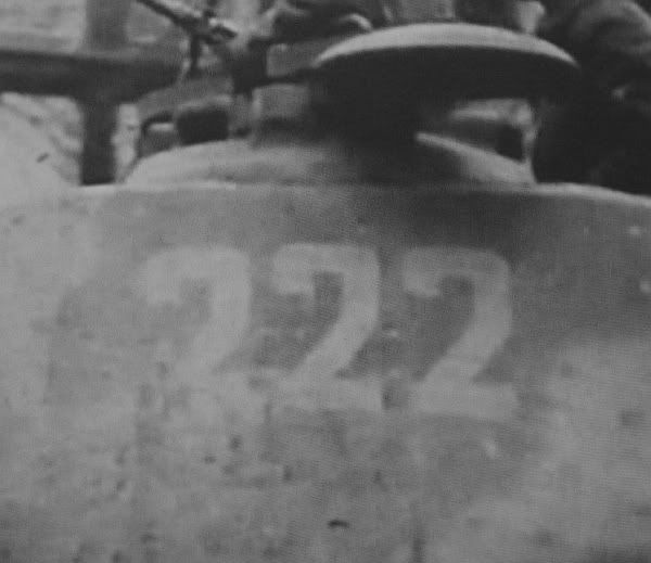

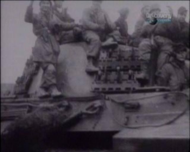

I noticed in the final series of the knocked out 222 there are traces of a German cross faintly visible either painted over or under the number 222 on the turret's left side . Any comments? Were the tanks originally painted with a cross on the turret sides at the factory and when issued, the units over painted the cross with the tank number?
The cross was also (just) visible on '222' when it was in service.
Here's a still from that well known newsreel from the beginning of the campaign:

That last pic is the one that proves the point right there. It appears as though the 501st SS covered it, giving a hard AND soft, at least in the area of the turret #s. One of the reasons why it faded after the battle may be that at that stage of the war, Germany was low on paint (just like everything else) . Crews in the field would thin the paint to make it stretch, with water usually, and I've even heard that solvents were used. There seems to be a new move by paint companies these days to offer a "late war" dark green and red brown, but I think that change in color was due to the thinning. Sorry about the paint thing.
