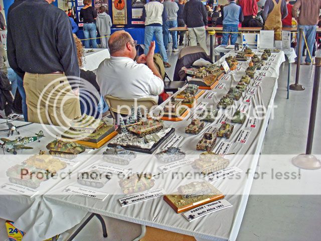

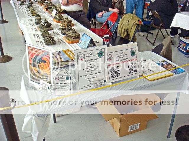

As I mentioned earlier, I've been side-tracked with organizing an AMPS club public exhibit as part of the Columbia (SC, USA) Army Air Base 70th Anniversary celebration. We participated as one of many exhibitors in the event which was hosted by the South Carolina Historical Aviation Foundation (SCHAF).
The event was put on in honor of the WWII veterans, civilian workers, and their families who were stationed, worked, and trained at the air base. The air base was a major training facility for the pilots and crews who flew the B-25, and during the war, over 200 air men died from various training accidents. Two of the B-25's that crashed on training missions have been recovered from area lakes, and one of the SCHAF's misisons is the restoration and preservation of these aircraft.
Here are a couple of pics of the AMPS exhibit:
We were all honored to be invited to participate and humbled by the attendees who had served with such distinction and sacrifice during the war years!

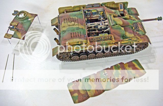

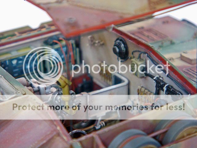

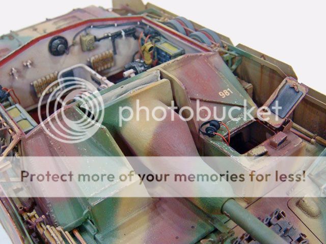

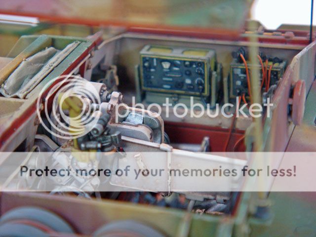

I've finally finished up the headsets and throat microphones and installed them into the fighting compartment.
Once this was done, I was able to do some additional final assembly, so that now, with the exception of the Schurtzen, fighting compartment roof, and antennas, the StuG is done and is ready to glue down to the base.
Those final parts will be added after the vehicle is glued down. Here's a pic of these ready:
I've also added the tow cable and driver's hatch:

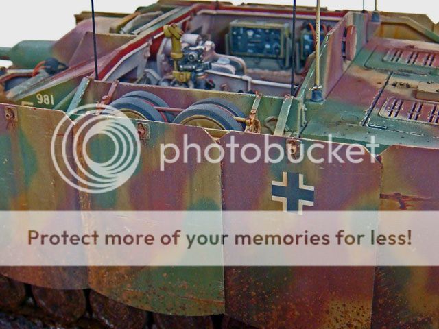

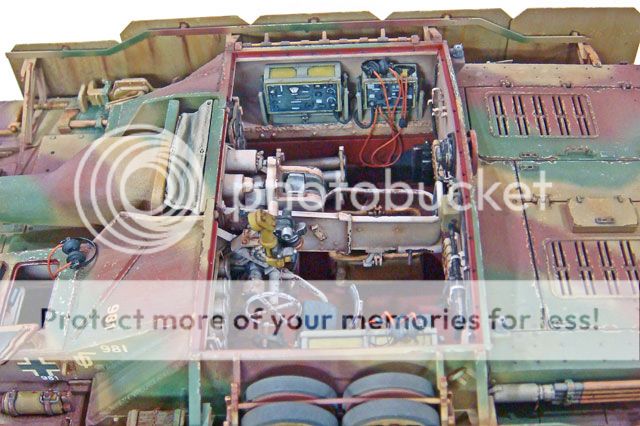

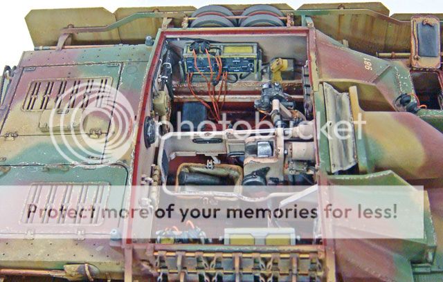

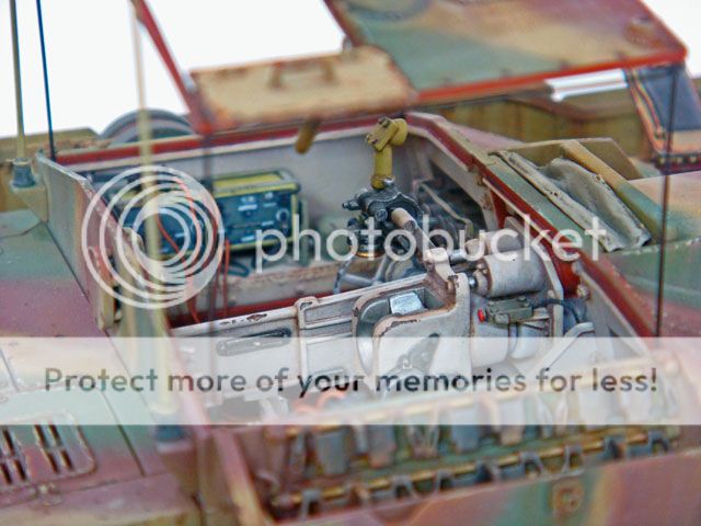

Here are a couple of unobstructed views of the interior of the fighting compartment showing the headsets and microphones installed:
The few color photos that I have of these items either wartime or post-war museum / collector items show the cords ranging in color from a medium brown to russet red to redish-orange. So, I went with a slightly brighter color to add some contrast and show a bit better in the shadows once the roof is installed.
More pics to follow...

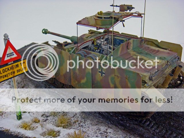

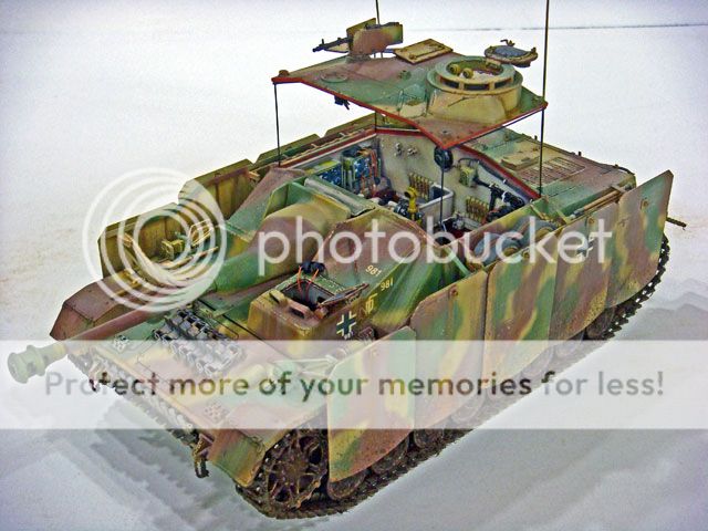

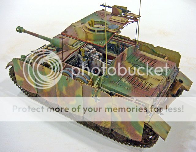

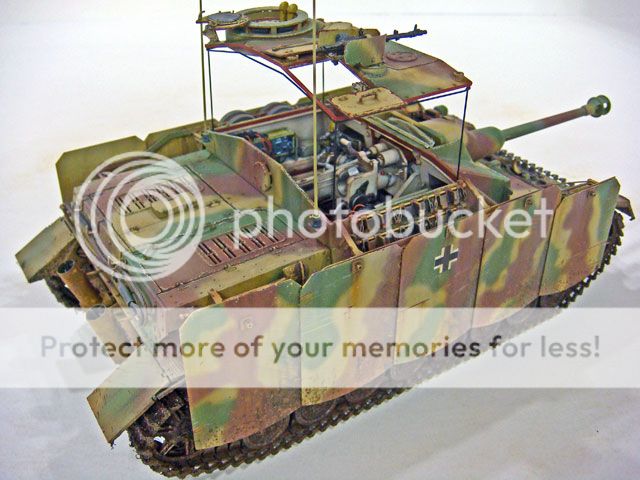

Moving on, I've done a final test fit on the roof display method with the frame glued to the roof:
Some close-ups showing what a viewer should be able to see:
I think it's going to work.
A couple more to follow...

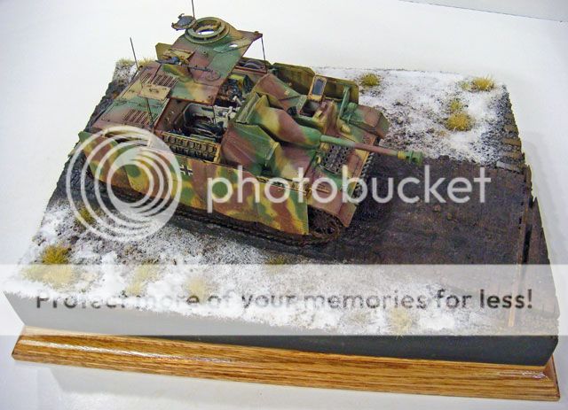

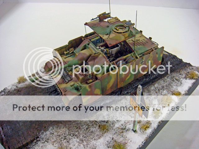

Finally, here're a couple of the test fit on the base to get an idea about the final look:
So, next up should be gluing the StuG down to the base and tidying up the track-to-ground points. I'll add the road sign, and then start painting the figures.
Still a lot more to go, but I'm getting there!

Wow, that german camo really pops against the drab winter base and the raised roof is done superbly. Definately worth the wait.
Can't wait to see it up close...

great work love the paintscheme and the initive way your displaying the interior

Dang Man - i love the way you displayed the top! thats sweet! may have to steal that idea from you. Outstanding work Mike!

@ Gary: Hey, you're welcome to the display idea, if you want. I don't have any copyright for it!
I'll also freely admit that the idea was inspired by several other models that I've seen, the most recent of which was Cesar "Manny" Rodriguez' "Judges' Best of Show" Pz I winner at this year's AMPS International Convention.

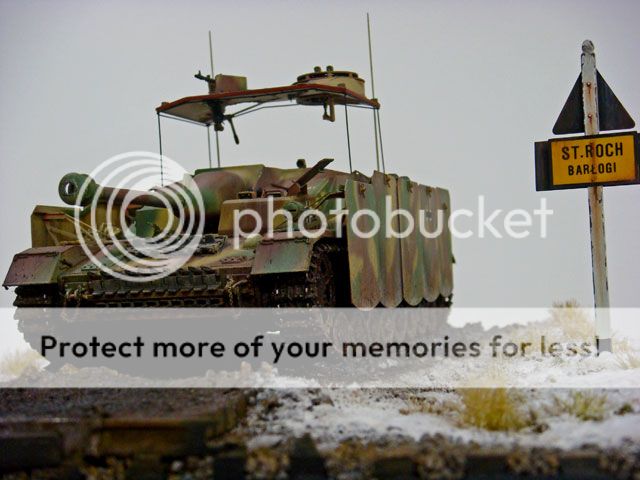

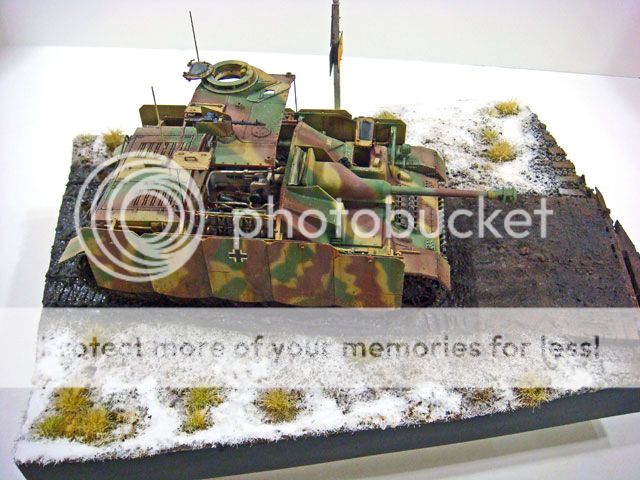

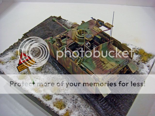

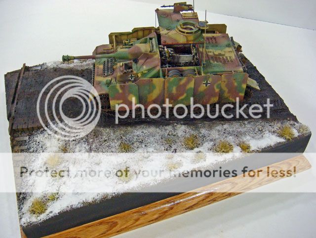

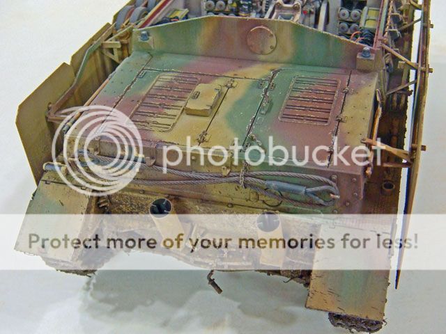

Well, I've finished up assembly of the actual vehicle, to include attaching it to the base's terrain module.
One thing that I needed to make were the cotter pins that hold the swinging Schurtzen on their frames. These are made from fine copper wire bent around a .020 drill bit. Here's a shot of the pins ready for painting:
They are stuck to a Post-It note. I airbrushed one side Floquil Rail Brown. After that side dried, I turned the pins over and stuck them to another sticky-note and painted the other side.
They were inserted into the tubes that form the attachment points for the Schurtzen, their ends were bent out slightly, and I touched the paint up.

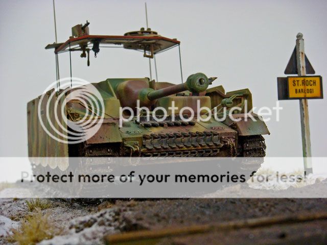

With that, the StuG is now finished. Here're a few general views showing the vehicle, the signs, and the final details attached to the StuG:
Here are two shots showing a "ground eye" view:

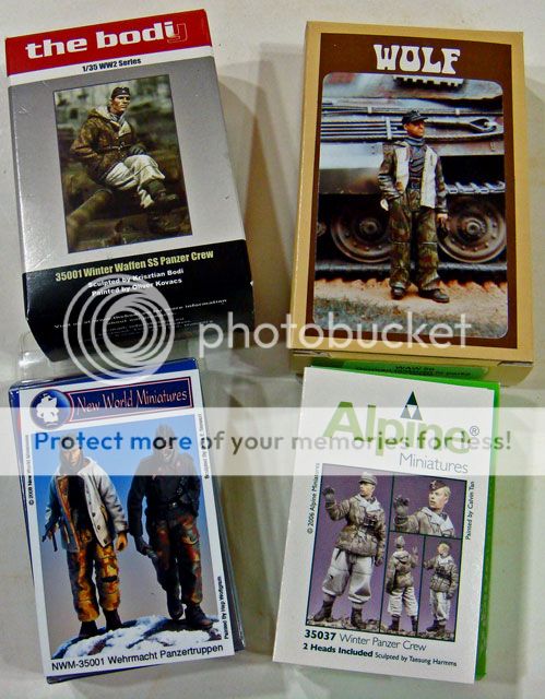

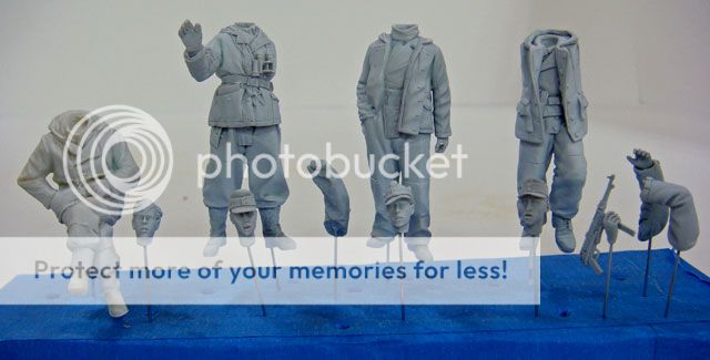

Yet to come are the crew figures. Here are the ones that I'm using:
So far, I've done some minor conversion work on all of them and got them primed and ready to paint:
All four will be wearing WH winter uniforms, camouflage side out. I did change the head on the Bodi SS figure to one wearing a WH hat. Other than that, there were no other changes needed for him. All of the other figures have had head swaps too (either Alpine or Hornet) and two have Hornet replacement hands. I filled most of the sculpted rips and tears in their uniforms and removed the Wolf figure's headset and throat mic and associated wires.
So, that's where I'm at right now. Next up-dates should be for the figures as I paint them up.

Mike, what do you use to prime your figures?
What are your thoughts about adding a bit of snow in the road itself. Any high spots that would still have snow? If the snow is that old, it seems maybe a little 'too perfect' in the covered areas. Maybe some spots where it's started to melt.
I could be totally off base, just my observation.

Hey Jesse,
Yea, I'm not 100% satisfied with the snow, especially the transitions between the muddy road and the snow on the grass and weeds. It's a long story, and involves a couple of different proprietary "snow" products ("Snow in a Pot" and Citadel's "Snow Flocking" - neither of which worked worth a darn), but by the time I got to the micro-balloons and PVA, the verges already had too much other snow "stuff" on them.
(Note to self- Just use the micro-balloons next time!)
I'm still contemplating what (if anything) I'm going to do to get the verges to look better, more like areas of recently melted snow rather than the "hoar frost" look that they have right now. Although it doesn't show very well in the photos, there's already quite a bit of "splashed" mud and weeds poking up through most of the snow. I'll probably do some more airbrush work in the transistion areas and follow that up with some more "splashed" mud from the road.
In regards to the figure primer - I don't use anything special. I used to use Floquil primer, but now I just use Tamiya flat white. I give the figures a wash in warm soapy water, and spray the Tamiya white on after they dry.
This works well for me since I undercoat my figures with acrylics and paint them with artist oils on top of that.
Thanks for the observations about the snow. That'll help keep me motivated to continue working on it. Hopefully have this one done for the February show in Atlanta - See ya there!

Nice to see this nearing fruition. You have chosen the figures wisely grasshopper,

"Xičxič nǐ, zhǔ" (he said with a deep, respectful bow...)
I think they'll work out, Jerry. I had to look hard for some that would group together like a crew, were wearing the correct uniforms, and that didn't need a lot of conversion work.
Because, unlike you, my friend, I really don't enjoy converting and sculpting figures. If they're available, I much prefer to use nice, well-sculpted stock figgies!

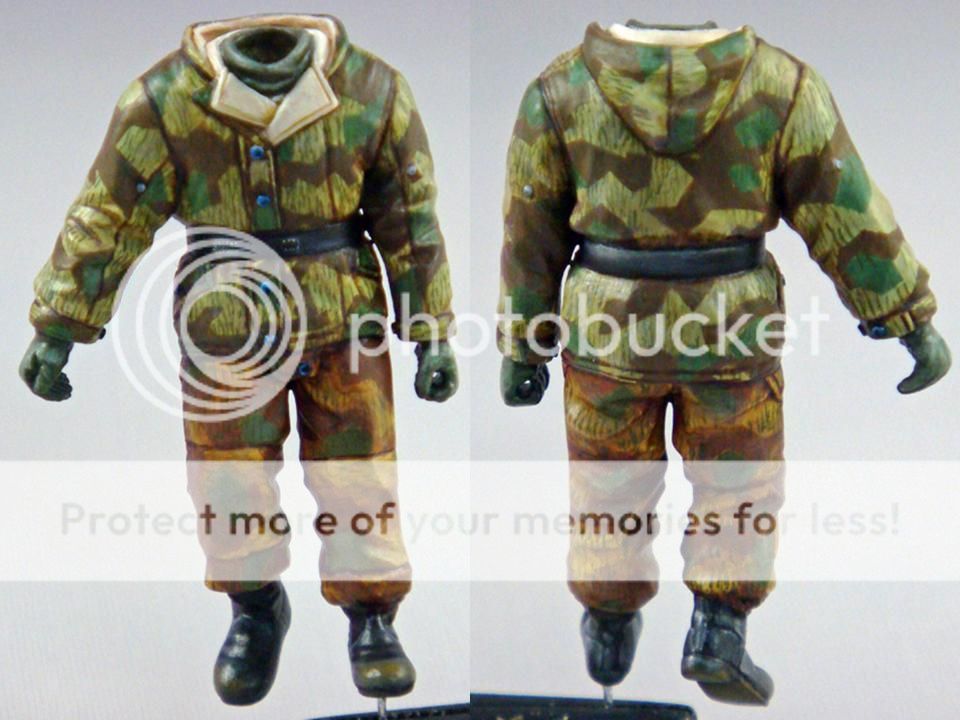

Well, I've been trying to work out a technique to paint the Spilitter and Sumpfmuster cammo uniforms for my figures.
I'm basically using Andy Evens' methods and colors but adding the shading with oil paints. I'm a "classic" style figure painter, and simply can't find the patience to use acrylic glazing for highlights and shadows.
So, here are a couple of happy snaps of my practice figure:
I'm not particularly pleased with the Sumpfmuster pants, but the coat came out acceptable. I can see that on my next figure, I'll use a darker umber color for the shadows on the Spilittermuster and make the "seam" lines a bit narrower.
Also, Andy clearly said to NOT brush over the raindrops more than once, but like a knuckle-head, I didn't follow his recommendation. But next time, I'll know to simply paint each raindrop once and leave it be.
This figure still has the "glossy's" while the oil paint is still drying, but I was also playing around with a light tent my son gave me for Christmas, and trying to figure out some changes to my photo methods, too. So, I took the photos before the paint had dried.
I still have to add this figure's belt buckle and the 20 liter fuel can that he's carrying. He's a stock DML figure with a Hornet head, assembled and primed in Tamiya flat white. The acrylic undercoats and cammo colors are Vallejo with artist oils for the actual painting (except for the cammo colors, of course.).
Andy Evans' excellent SBS article on painting German Splittermuster cammo can be found here: Historicus Forma:: Painting Splinter Pattern
Anyways, this little up-date is more to keep this blog on life-support and let everyone know I'm still workig on this project.
Happy New Year and Happy Modeling!

Hi Mike,
That “practice” figure sure looks good to me! The face looks awesome too!

Thanks, John!
Hopefully the figures for the vignette will come out even better. There's always much to learn and practice. I'm trying, though, and maybe one day I'll grow up to be real figure painter!
Happy New Year!
