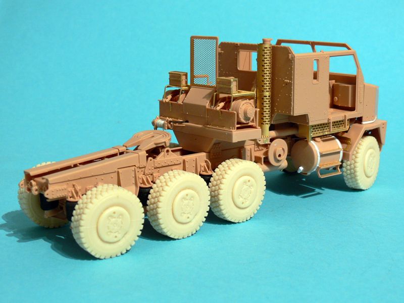

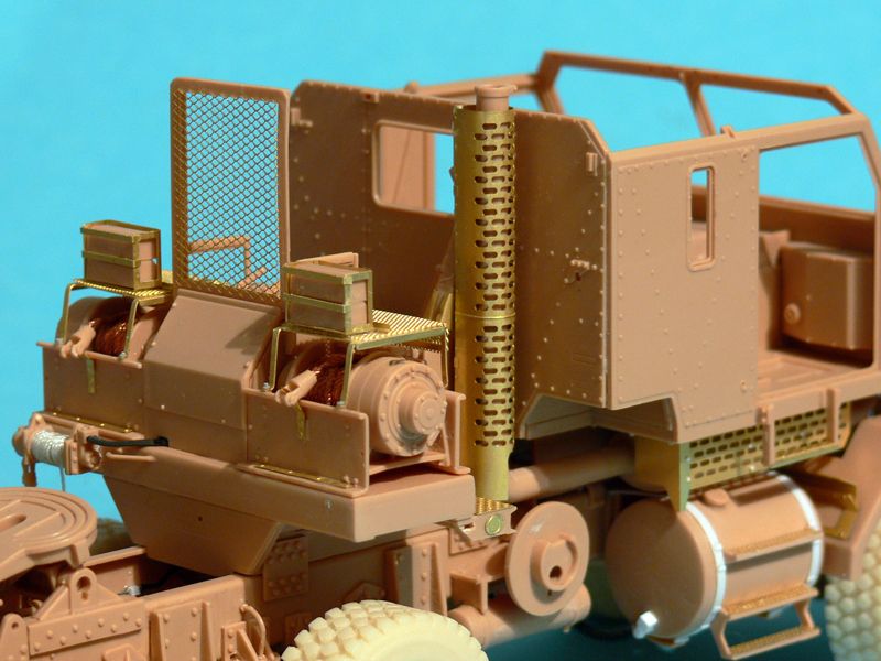

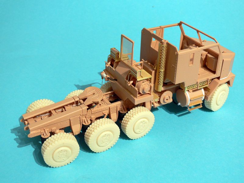

Next small update - Exhaust

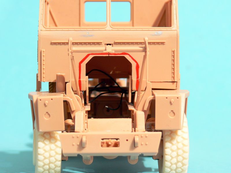

I found a fatal error in the bottom of the cab. The tunnel for the engine is closer to 4-5 mm. For this reason, the engine will not fit under the cab. The only possible solution is:
Make new parts number - C7 + C15, C11 and C12 adjust.
Photos for comparison.

I'll have to buy another model to adjust parts. These parts are supplied from the resin with the engine. Still try to disassemble the cab.

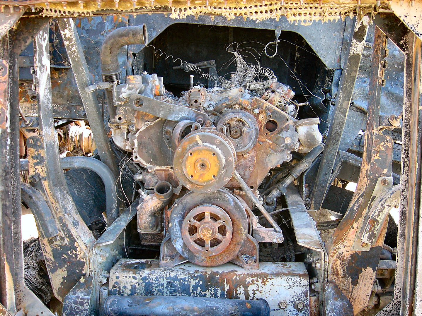

If this issue wasn't brought out, no one would be able to tell it was not the correct size anyhow. Or is it an issue? Do you have actual measurements on the opening under the cab, or are you just working from the picture of the deformed cab after an IED strike you posted above?
