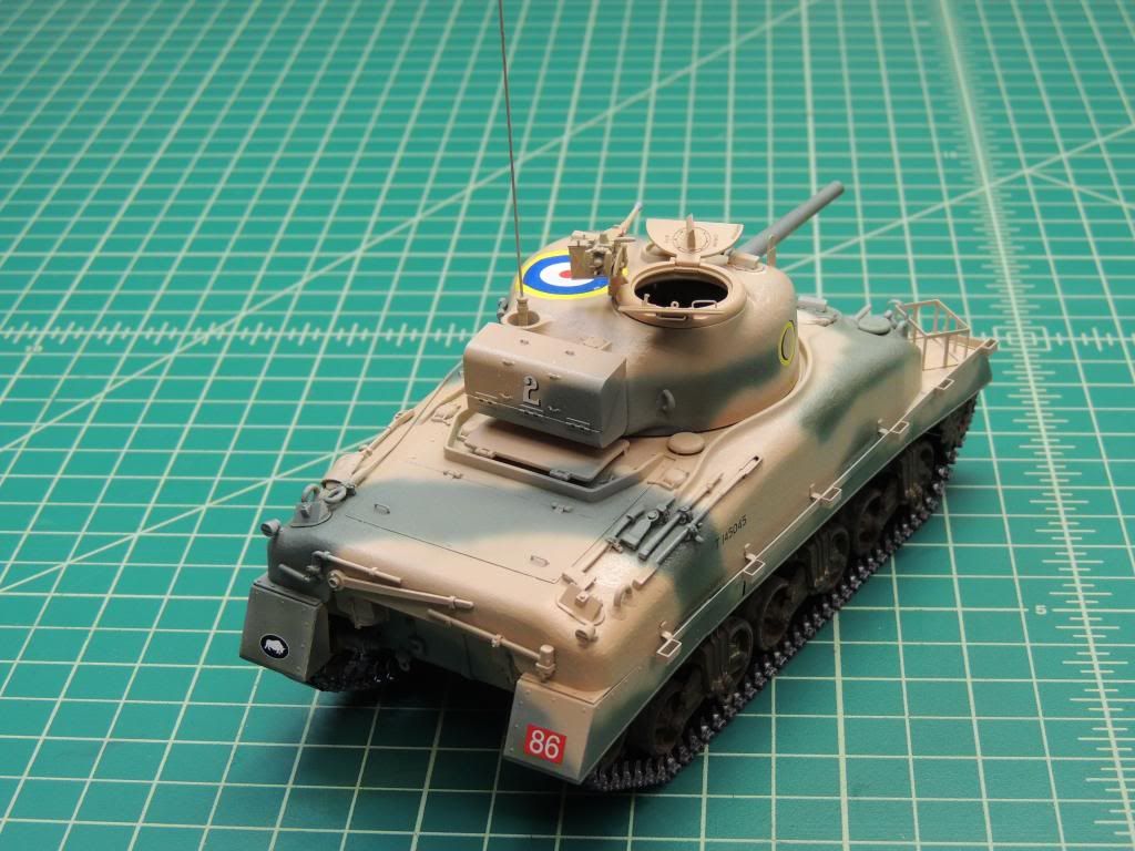

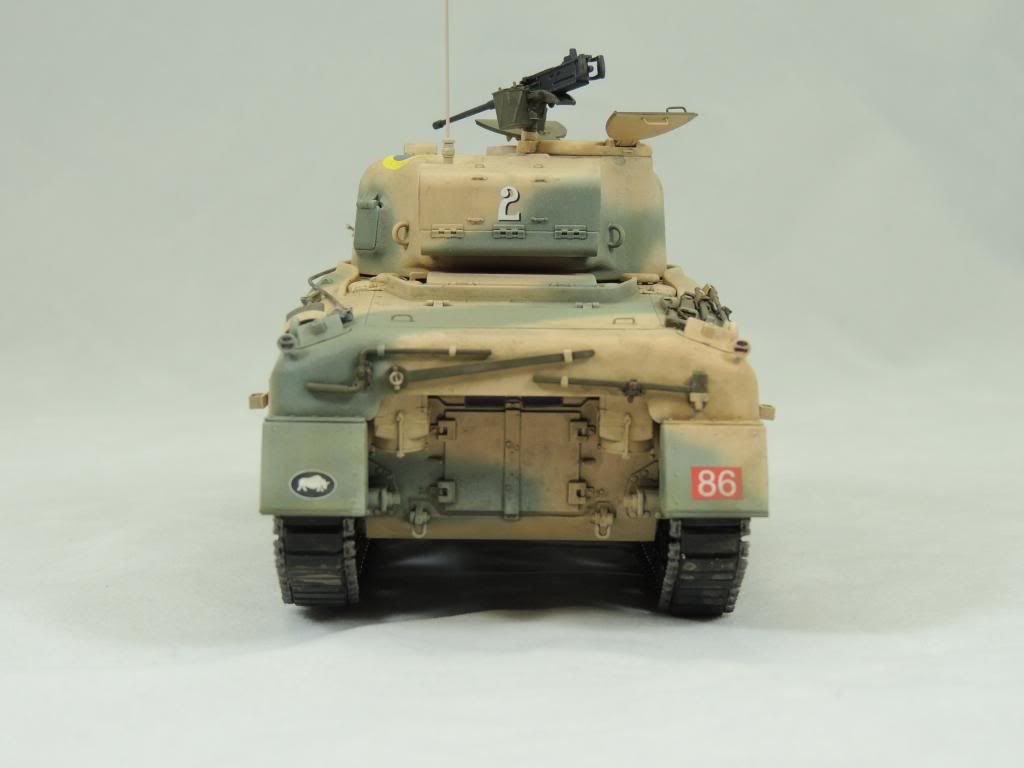

Paul and Jeff,
Thanks, it was a lot of fun to build, one of DML's better kits. The casting texture is very good but that DS track never fits.

Hi Irvin,
thanks for the info, you just saved me some money
thats one resin set that I won't get, not yet anyway
Cool build there, the camo and weathering looks very convincing indeed

Beautiful Sherman Irvin.

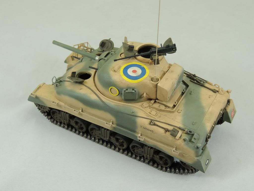

and................

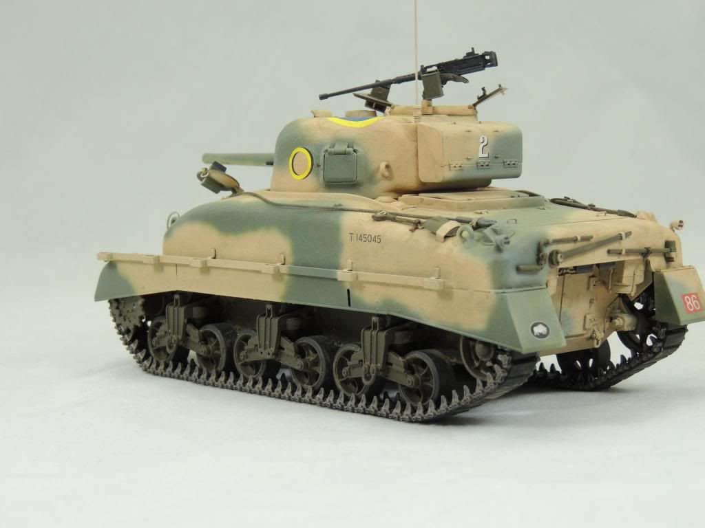

More.............

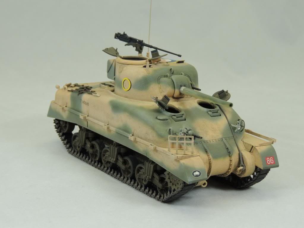

My M4A1 British Sherman II from El Alamin is done!

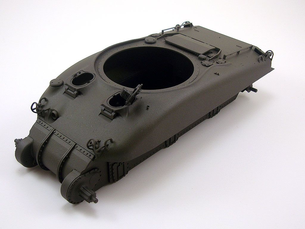

Like many U.S. Army Shermans, this tanks paint job is simply olive drab. To add variation to the one-color paint scheme, I decided to try a three-layer method first described by Doogs over at Doogs Models and further promoted by Jon B at The Combat Workshop. Here is how this technique was applied to this Sherman:
I started by priming the model with Vallejo Surface Primer Black. While my photos show the hull, it shoud be noted that everything was painted with black primer but only the hull, turret and main gun would get the three-layer method applied.
Next, I sprayed white on surfaces which I wanted to highlight. I primarily emphasized the upper surfaces. I used Vallejo Model Color White and ran into a problem with paint splatter. It turns out that the tip of my airbrush needle had gotten bent. When I replaced it, the brush started shooting normally again. Still, when I first saw the splatter, I freaked out but then I realized that it helped emphasize the cast texture of the hull and the turret.
Next, I applied several highly-thinned layers of Vallejo Model Color U.S. Olive Drab. I was a little disappointed with the end result. I did not get the tonal variation that I was looking for and the color itself was much darker than I was expecting.
Rather than strip the model and try again, I decided to provide apply additional tonal variation by airbrushing a lighter color on the horizontal surfaces. Here, I used Vallejo Model Color Brown Violet. Whereas I used a 4:1 thinner to paint ratio for the olive drab, I used an 10:1 ratio for the brown violet. I applied a few coats, each pass covered a little smaller area than the previous. I was effectively building up layers like you do when using acrylics on figures.
The photos still look a bit dark but in real life, Im very happy with the results.

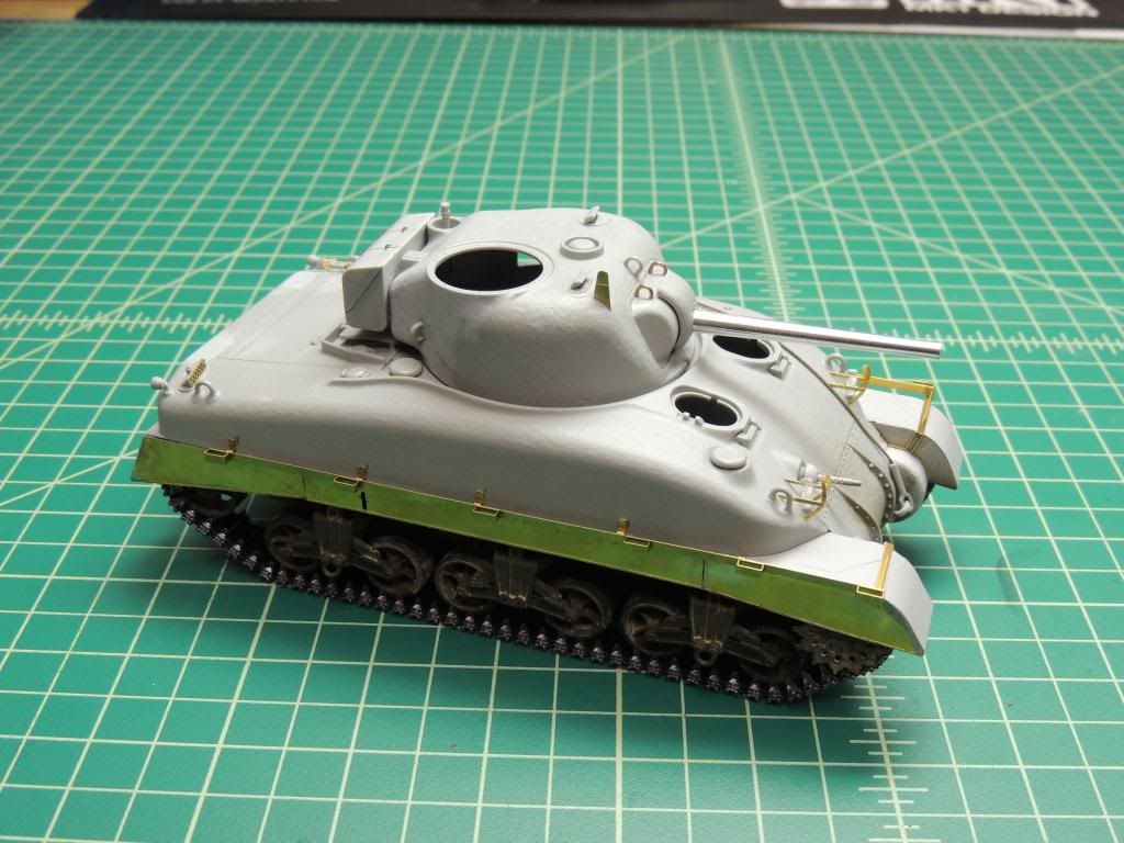

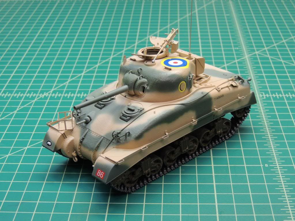

more

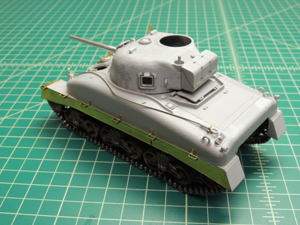

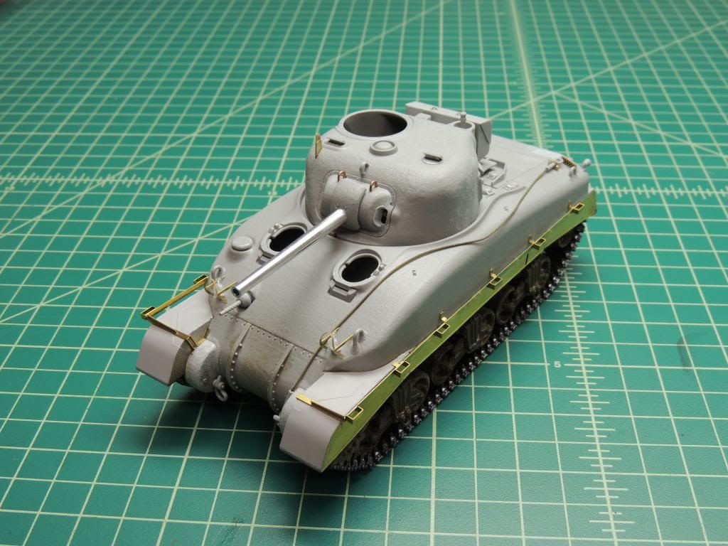

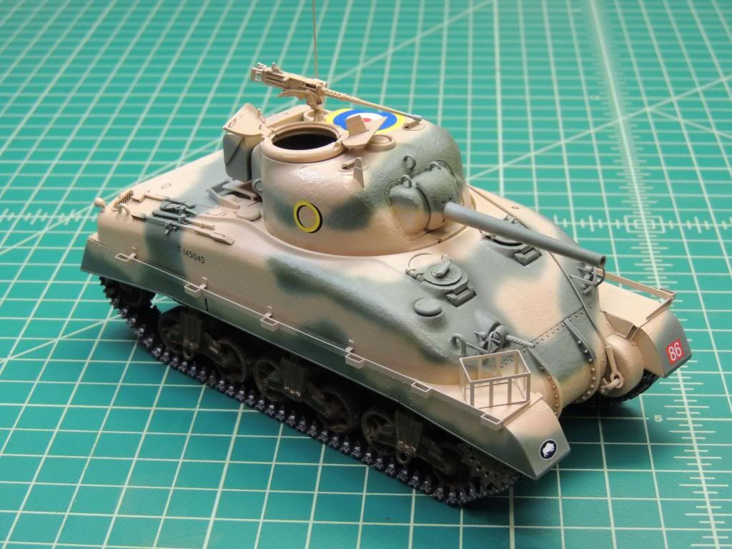

Ready for paint

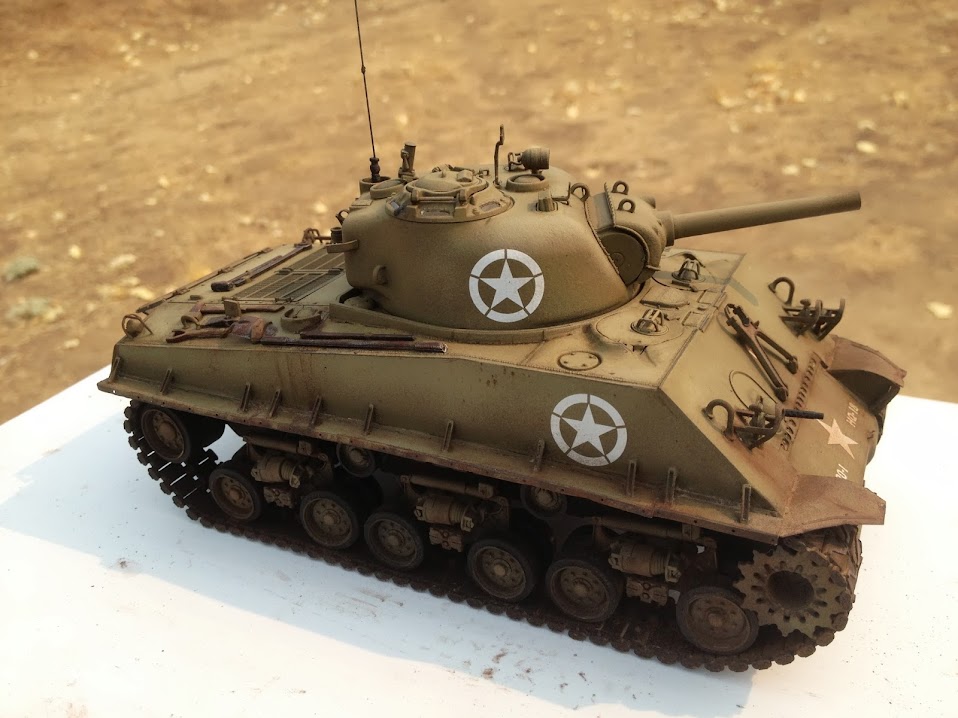

Late submit, El Alamein sherman finished.
