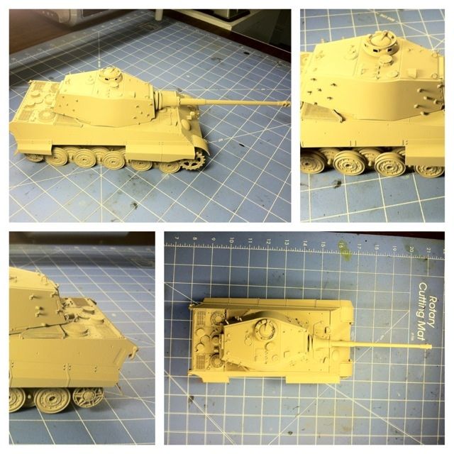

Final mock up of the vehicle with only the tools to be added.
The tools are done and ready to mount. I made the "threaded" rods ends by rolling some solder under a file.

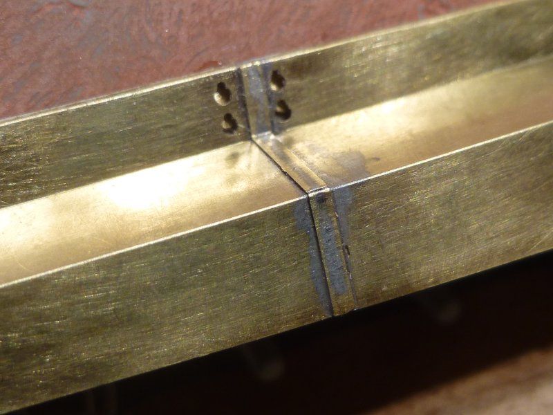

For whatever reason I absolutely could not get a good looking solder joint on PE. Tried Tix flux as suggested by friend and WOW. Ive heard about solder getting sucked into the joists before just never saw it. Got the fenders done with only minor clean up. Instead of trying to get the fenders to stay on only attached at the mounting plates I filled the back with strips of plastic flush with the top folded edge and secured with CA. Scraped away the Bondo and I was able to get a really strong bond.

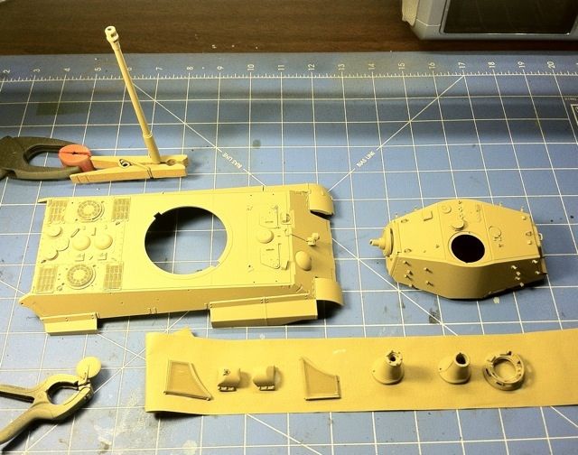

Finally applied some paint. It was kinda sad to cover up all those precious metals! But it had to happen sooner or later.
I'm still debating which method to use on the tracks.
