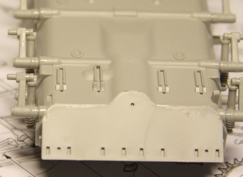

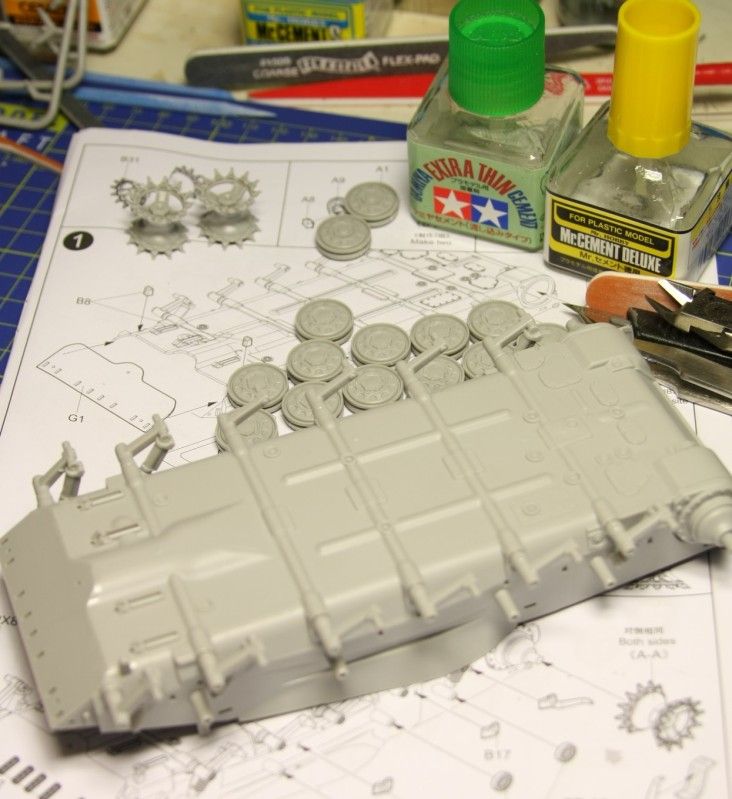

Construction begins on the lower hull:
I've go Kagero's 'Topshots' walk around of a Polish Army T-64 handy so I can compare the real steel with the detail in the kit and so far its pretty damn good. The suspension and running gear on the T-64 is quite differen to other Soviet tanks of the era, it makes for an interesting build.

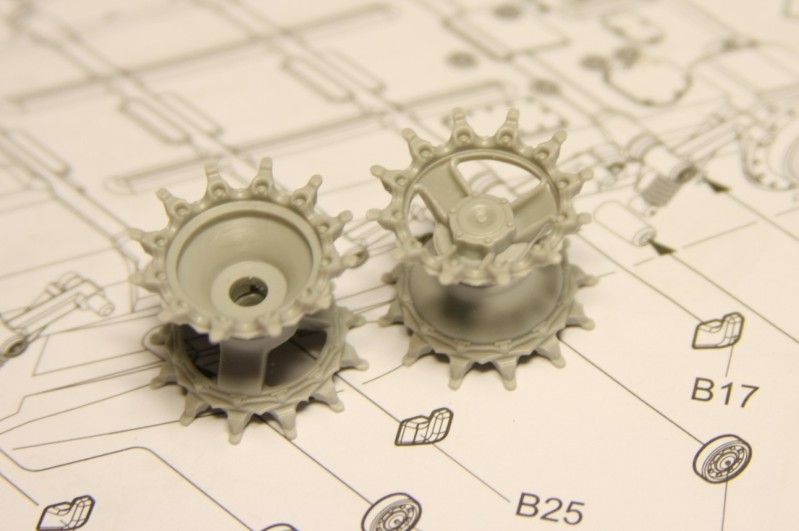

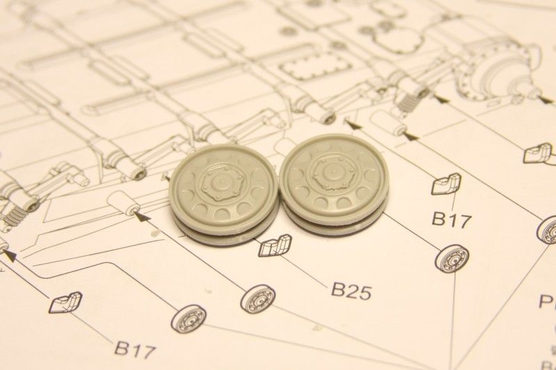

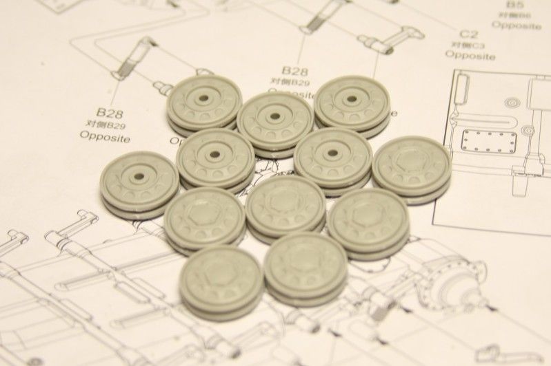

The twelve wheels are three parts (no polycaps unfortunately...I like polycaps!) with an inner and outer face plus the hub. The idler wheels are identical to the running wheels with the exception of their hubs which are a slightly different design.
The sprockets are really nicely moulded and feature what I reckon is the thinnest sprue attachment points I've ever come across- really excellent stuff!
I'm not quite finished Stage 1 yet, there's the return rollers and a good few other bits of detailing yet to do on the upper hull.

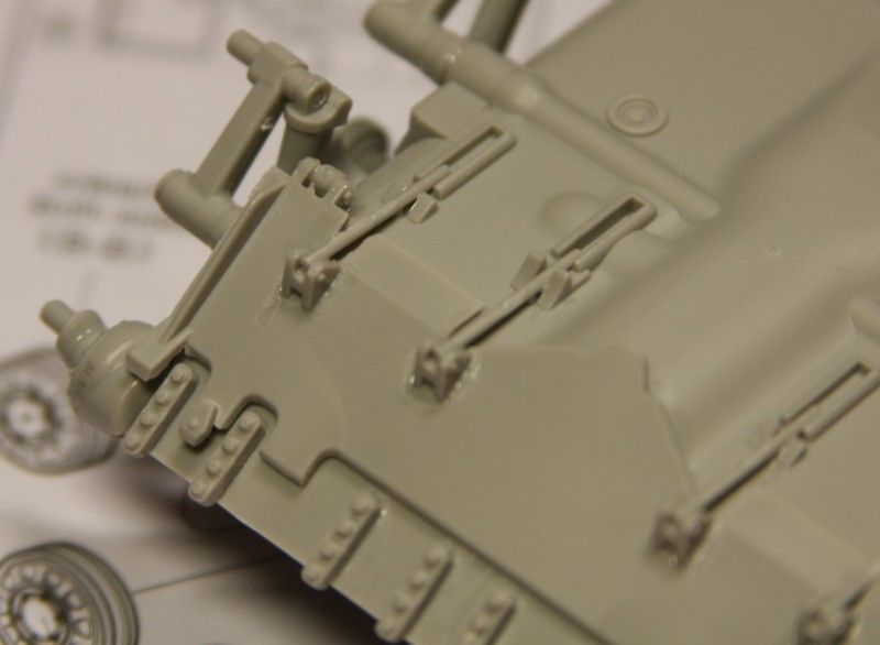

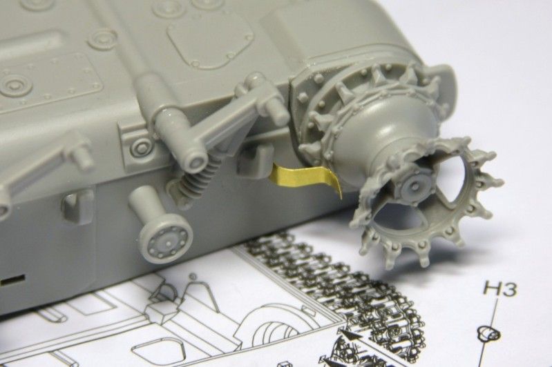

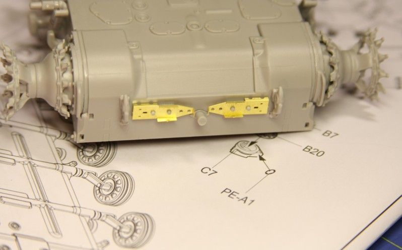

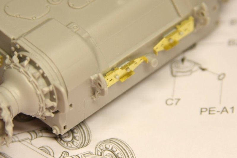

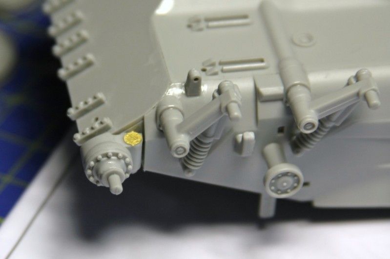

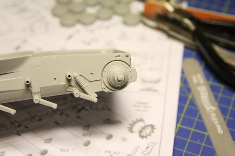

I've got Stage one of the build finished, the last bit on the first page was adding some smaller parts to the lower hull. I'm not great with identifying some of these smaller parts so please forgive me if I get them wrong!
I believe this small piece with the etch attached is the debris scraper for the sprocket- there's a small shaping piece in the kit to bend it, I'll try and show it when I do the other side.

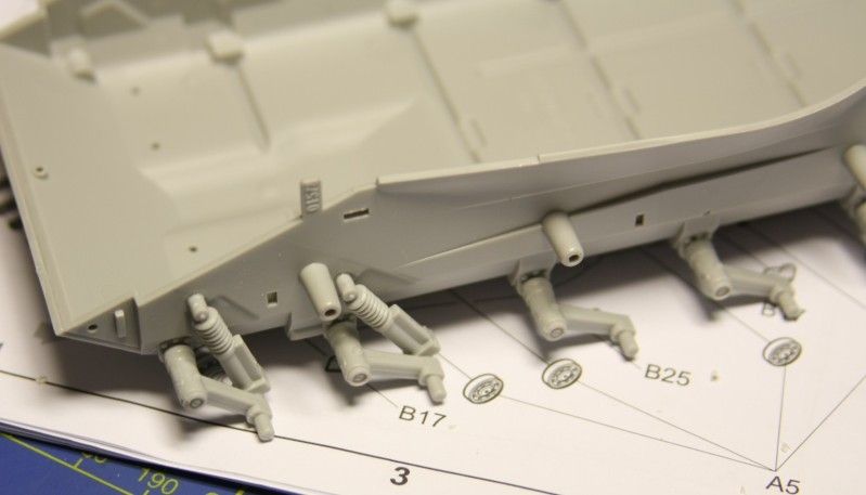

The return rollers and these small upturned arms (anyone know what they are?) go on next.

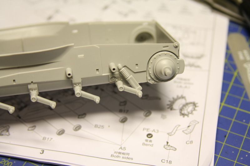

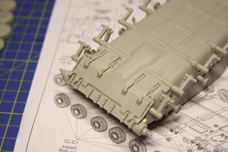

The axle for the idler is nicely detailed consisting of three plastic pieces and an etch bit.
The mounting points for the mine rollers used on the T-64 are great little pieces and the fit, as with everything thus far, is perfect with only a skim of extra thin cement needed.
This is just a view looking down the side after all the parts were attached.
They are usually called control arms. They rotate on the hull side to allow the wheels up and down movement.

Rick I think he was talking about the hook like items above the control arms. I think their bump stops for limit control of the roadwheels.

Rick & Chris- Yes it wasn't the control arms I was wondering about, it was those small hook like attachments just above. If they were bump stops how would they work? Thanks for checking out the thread guys!

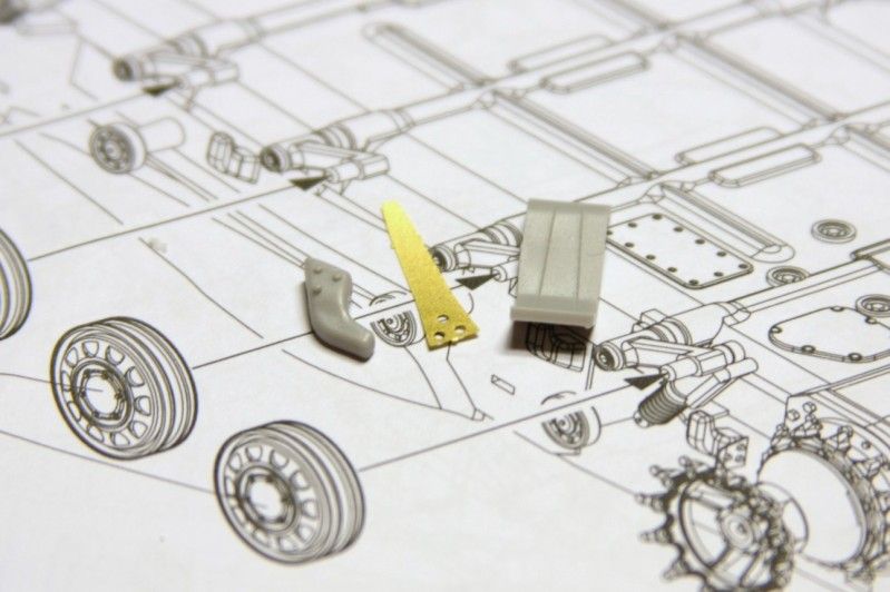

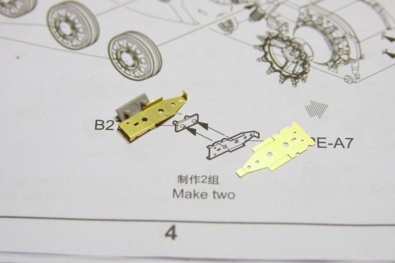

These are the three parts you need to make the debris scrapers for the sprockets.
A small S shaped kit part acts as a bending channel for the PE part. I found its not totally exact, you have to bend it a slight bit more than the channel allows but you are able to achieve the general shape very easily without miss-shaping the parts.

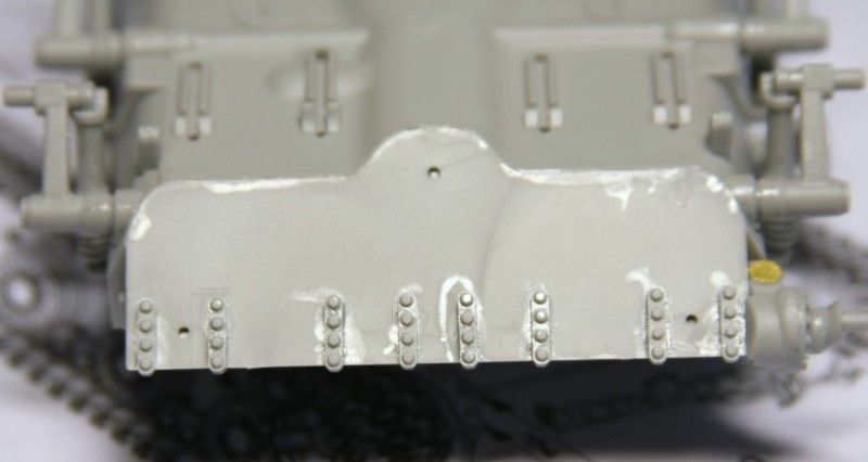

These nice PE parts make up some details on the rear. I would recommend using an etch shaping device when you need to obtain good folds in PE parts. However, when a piece is this small and the folds are quite small then you can get away with using a pair of tweezers like the curved needle-point pair shown a couple of pictures up. It takes a bit of practice to get used to it (and lots of messed up parts, believe me!) but it is sometimes easier and faster than using an etch tool. Etch tools are still fairly necessary though especially for more complex bends and larger parts.
A good, thin CA glue is always useful (I'm not recommending the brand shown or anythig!! There are loads of good brands out there.) when dealing with PE as capillary action allows it to flow under and around PE parts to get a very secure bond. I usually drop some out on an up-turned CD and use a paper clip end to place the CA glue. An accelerator for CA is handy too as it gives you a pretty much instant bond which is good for tricky parts that just won't seem to stay in place.
The small entrenching blade on the underside of the lower hull front is nicely done and I reckon, with some very minor modifications, it could be posed in use.
