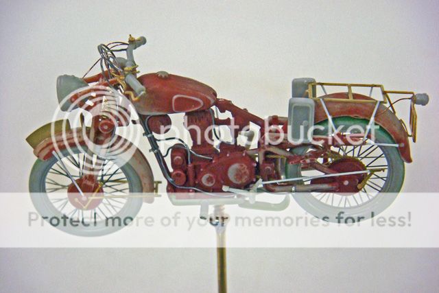

I'm putting the Model Victoria #4081 "Gilera LTE 500 Motorcycle with Bersagliere North Africa" on the vignette with the tank.
The "Gilera LTE 500" is a very nice little kit - all resin and photo-etched. It does require a little bit of scratch building to add some fender braces, make some coil springs, and to "plumb" the bike.
The figure is quite nicely sculpted and fits the bike like a glove.
Here're a couple of pics of the bike after construction and before painting.
You might notice the bike doesn't have a saddle. This is because the figure is sculpted with the seat for a perfect fit. (The kit does include another seat to build as a stand-alone bike, and Model Victoria does sell it that way.)
The primer red is Floquil's lacquer based Special Oxide Red which I sprayed on the larger resin parts before I cleaned them up completely and assembled them. This helped me to see all of the details for cleaning up.
I'm working on the figure right now - making a minor change in his pose to fit my vignette idea with the M13/40 and crew. I'll post some more pics as I make progress.

Posted: Thursday, November 08, 2012 - 05:57 AM UTC
Mike, outstanding as usual.
Nice work on the wiring and scratch building.
I look forward to seeing it in person, perhaps at the store today?
I would have thought even the Italians would have a 'kick stand' on the bike and not a screw and rod?

... I would have thought even the Italians would have a 'kick stand' on the bike and not a screw and rod?
Keith.
Thanks, Keith! (Had a good time hanging around the hobby shop today!)
For everyone else, the bike was too delicate to hold it normally while I was trying to build it. It was kind of like building a spider web. I felt like every time I touched it something was going to break off, so I fabricated the "screw holder."
It's made of a (#6 I think) brass wood screw soldered onto a piece of brass tubing. It's screwed into a small tapered hole drilled into the bottom of the engine crankcase with the tip of an X-acto knife. I'll fill the hole when the bike is finished and before putting it on the vignette.
