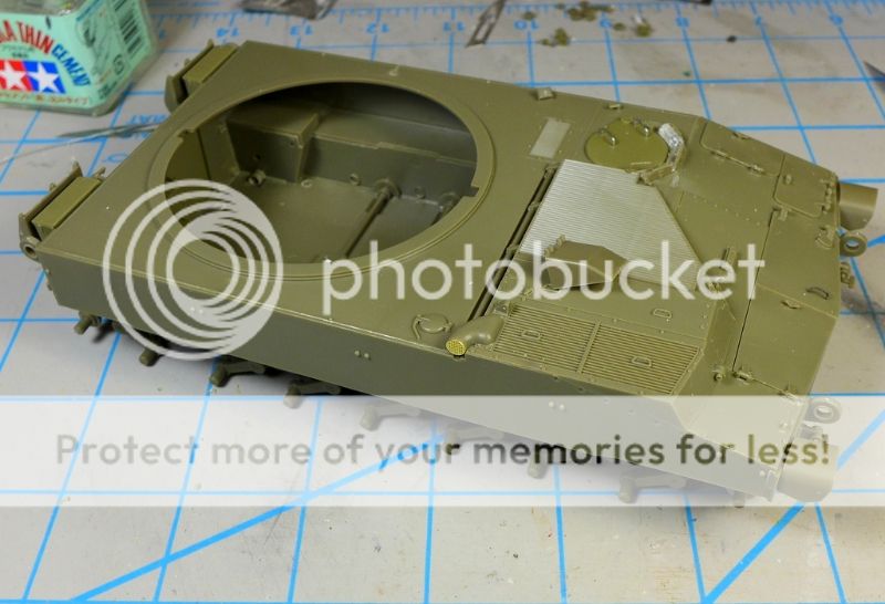

Mecanix, she's looking good.
Here's a little progress from my Paladin:
Armoured cover for the drivers hatch - 0.3mm plastic sheet with some
Dragon bolt heads.
Anti-slip made from 400er sandpaper (0.2mm thick)
Gun barrel with added diameter at the turret side (0.3mm), I checked some pics on the net and noticed that the barrel was thicker
in this area. I also caught an Adware virus doing this , so be careful if you google M109A6 Paladin. If the pic you wish copy ends in a download then bin it and check your PC.
I also added 3 mm in length to the Kit barrel because it just looks too short, well according to the pics I have seen it's so.
Here's the picture:
05.09.13 001
That's it for now, hope you like it.

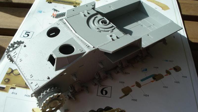

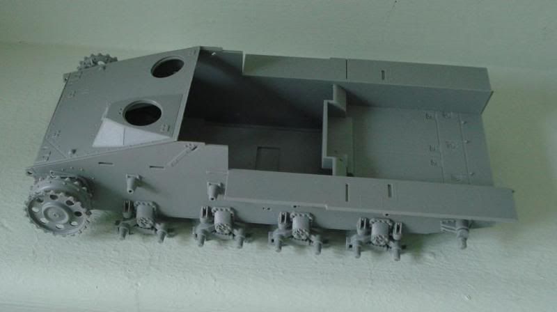

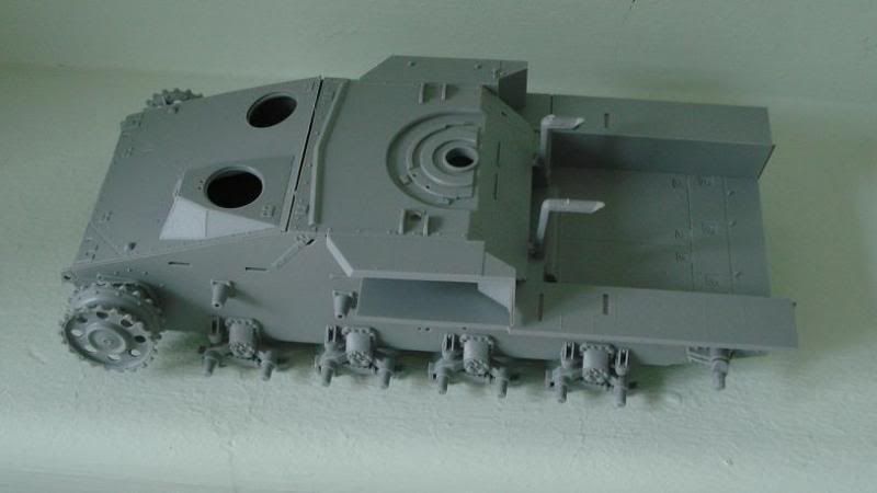

Update on my Hummel

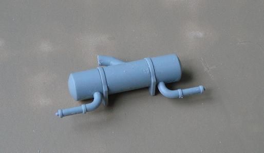

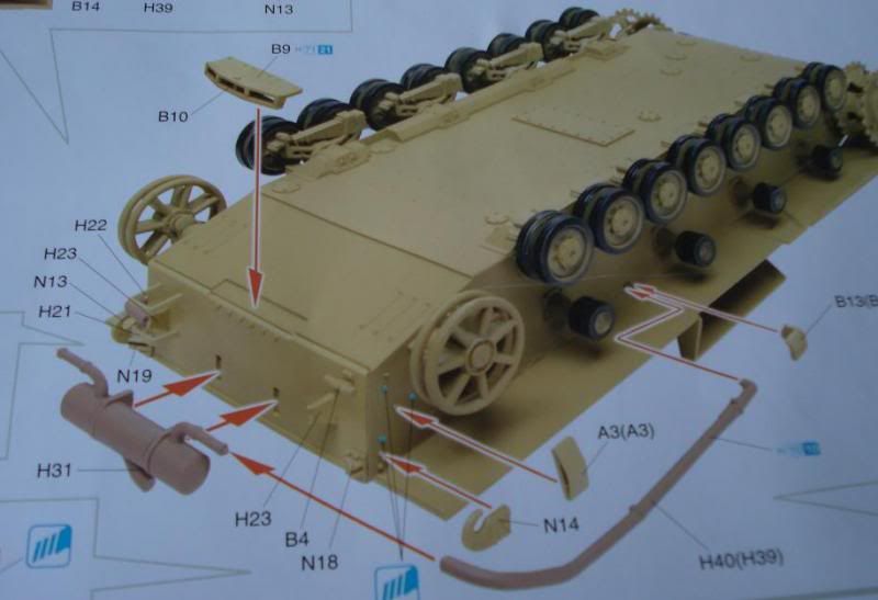

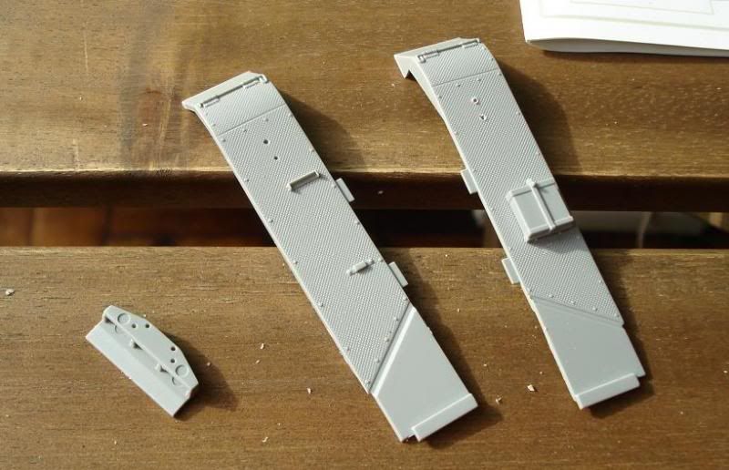

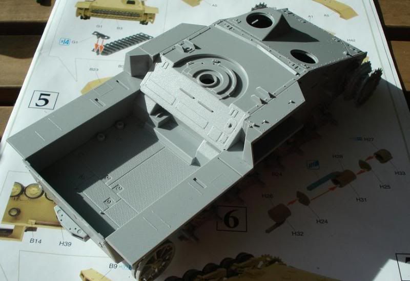

Worked on the Hummel again !
Fenders
Hull
