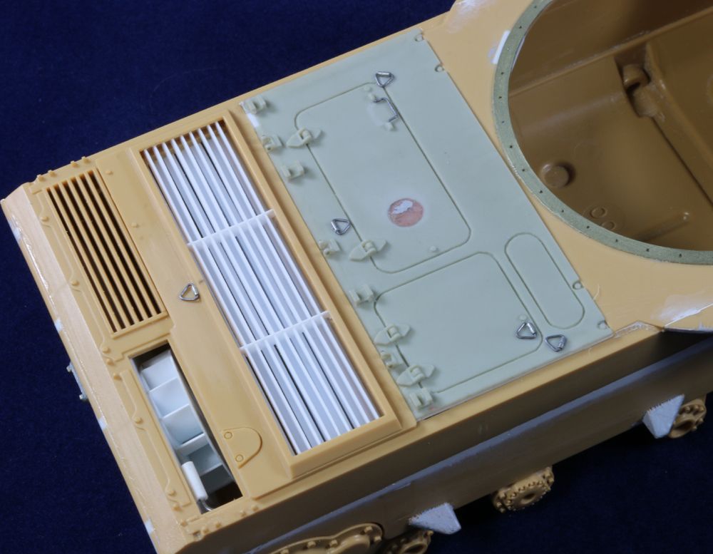

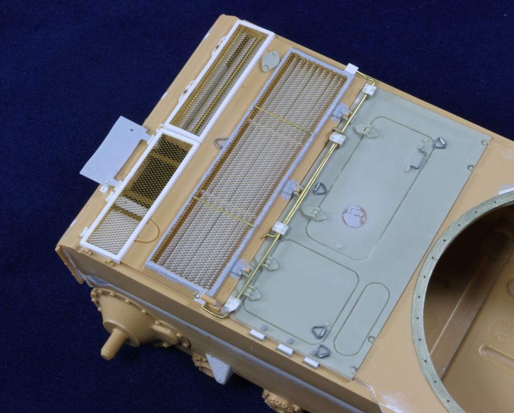

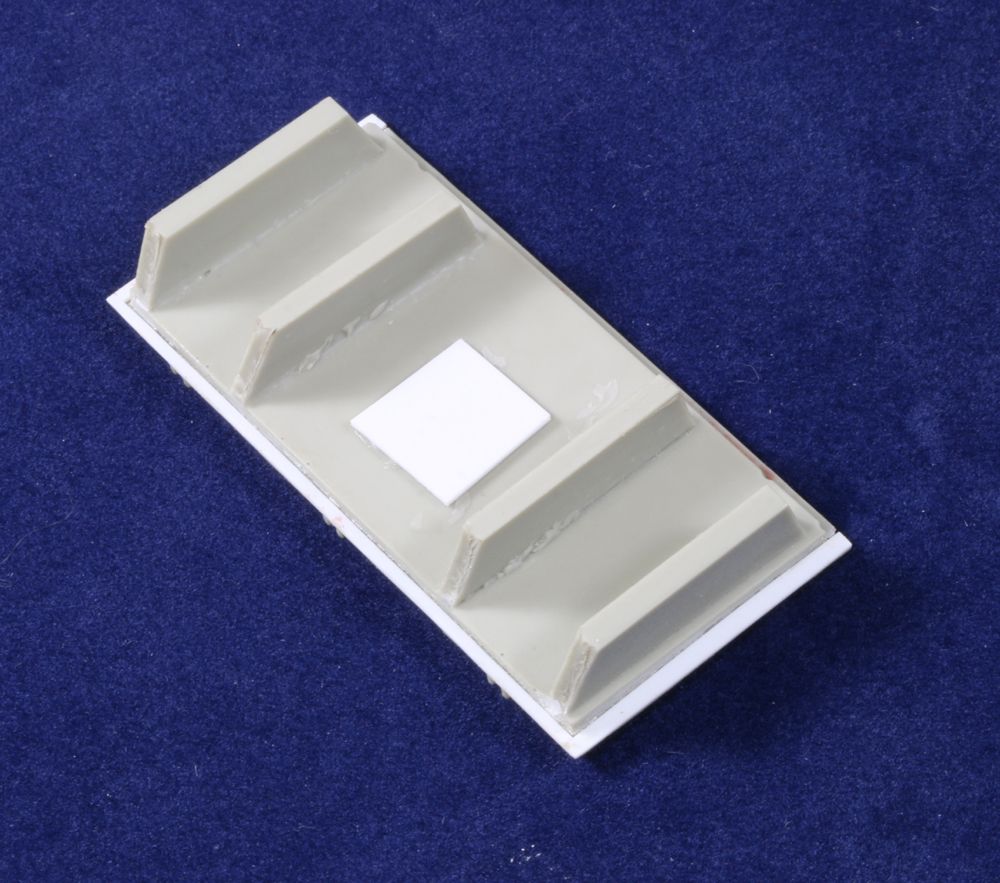

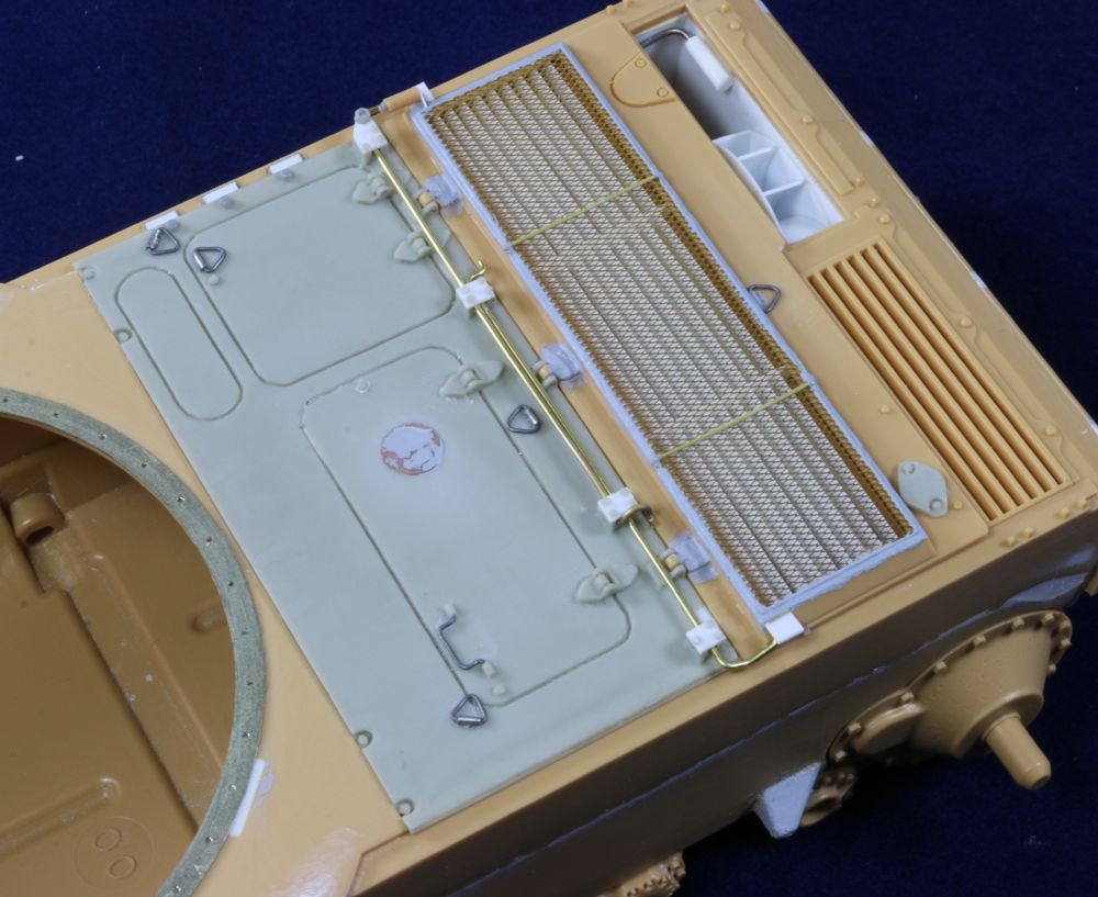

The Legend replacement resin deck need a bit of clean up on the edges and I've added some styrene shims to 'thicken' the plate a little too. The scrap styrene piece in the middle is a base for filling the hole with filler....
I've also replaced all the moulded on lifting loops etc with lead wire which is easier to manipulate when making such small pieces....

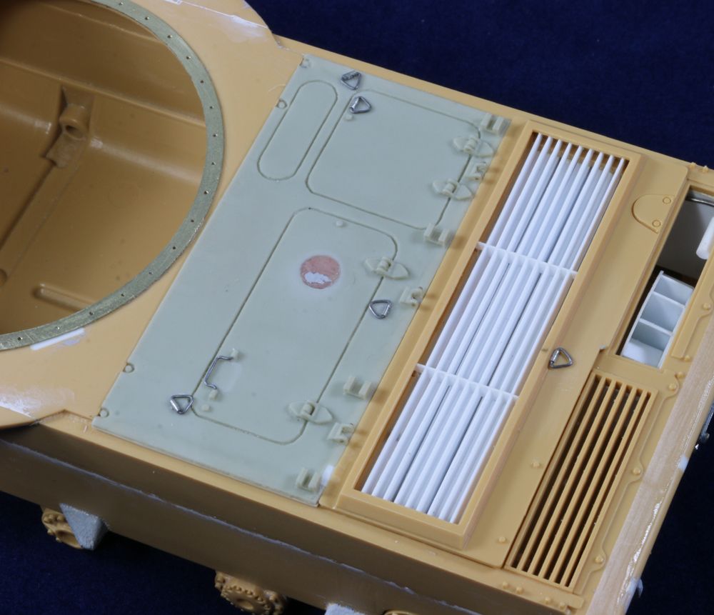

More work completed on the engine deck including the access door torsion bars specific to the T54....
Gary

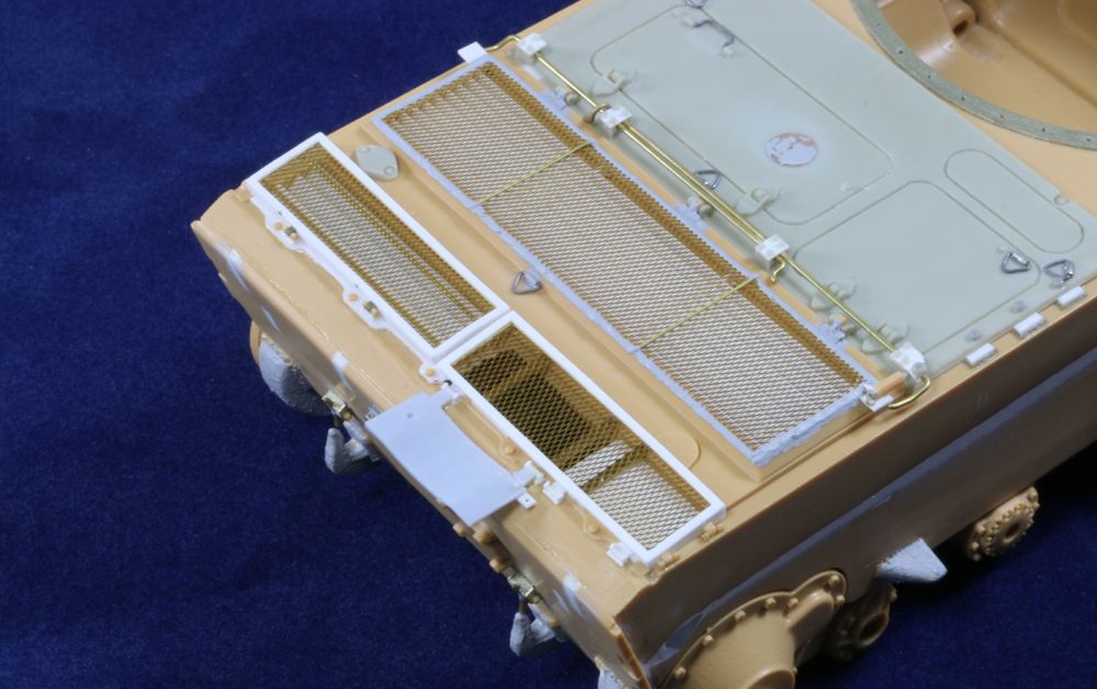

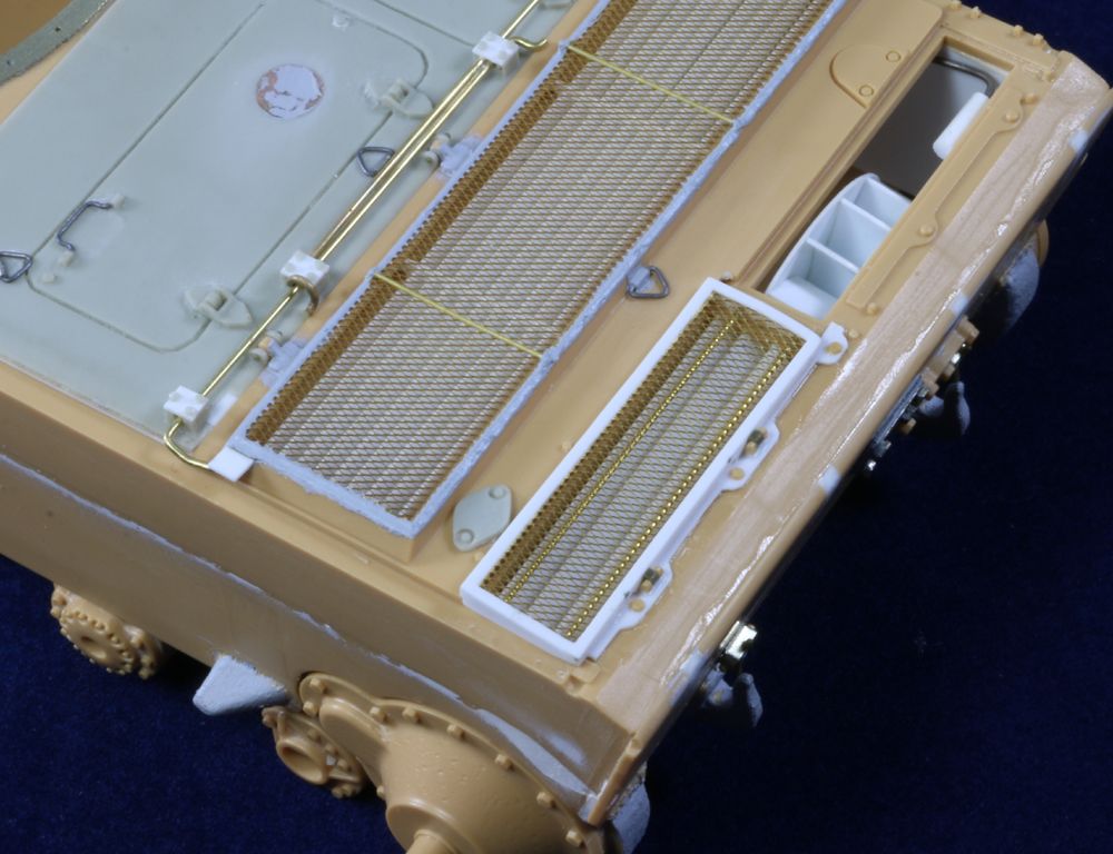

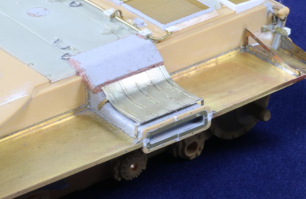

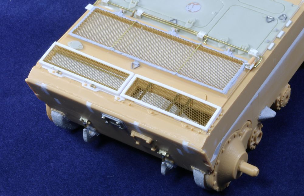

The slats in the rear outlet are removed and replaced in accordance to T54 ref photos. It also appears that the cover also differs to the T54 - not just in appearance but also the hinge points. So the entire cover was scratched using styrene strip, Legend PE mesh and brass wire. The rear panel mounting plate shape also needs to be modified - again, using strip styrene...
Gary

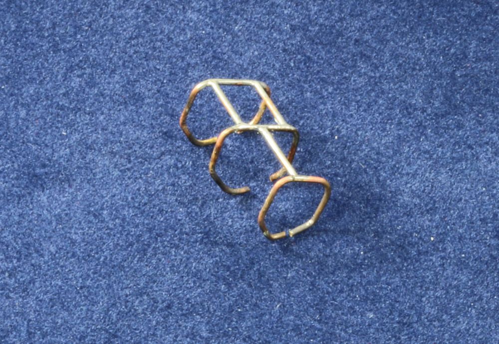

Gary, how the heck do you make such nice, clean, consistent bends with the wire? I am insanely jealous!
gastec
Auckland, New Zealand
Joined: February 03, 2014
KitMaker: 992 posts
Armorama: 871 posts
Posted: Sunday, December 21, 2014 - 11:05 PM UTC
Thanks guys
Colin - annealing the brass rod helps a lot when you need to bend a tight angle.

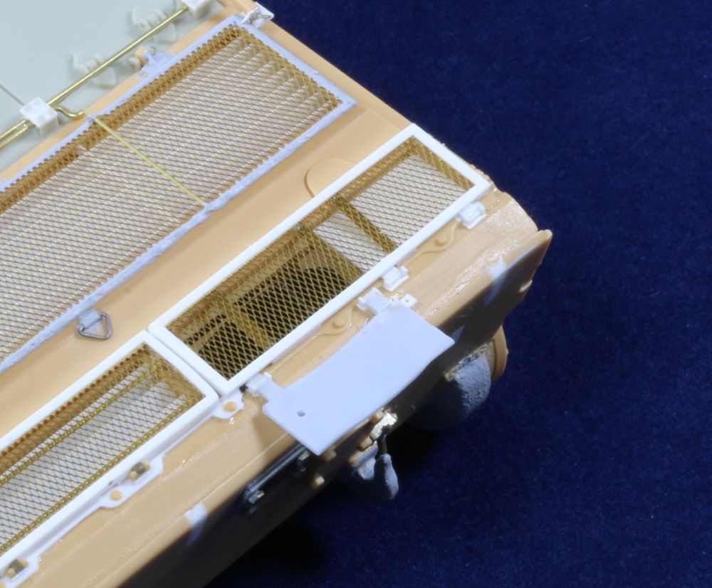

Second grill WIP....
Gary

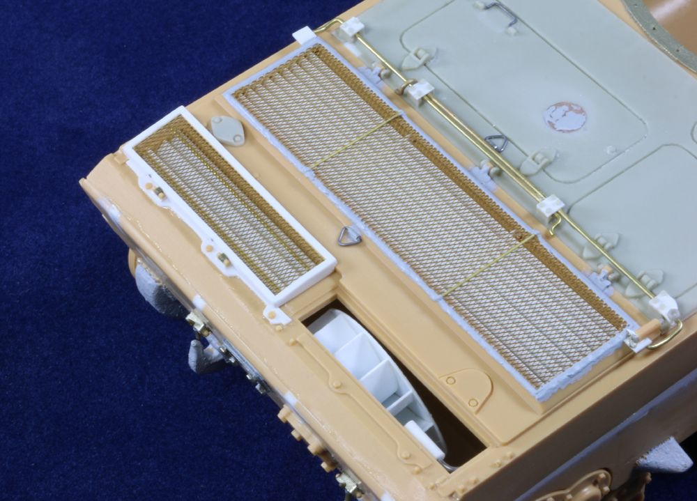

The radiator fan armoured cover on the earlier models was split in two. The DEF Models part is actually about 1mm too short so after cutting the cover in two, I remade the flat section from scrap sheet styrene. After adding hinge parts (Need trimming once cement has set) and priming the fan assembly black, the covers are fixed in place. The armoured covers, when open, can be fixed in place with a bolt as depicted on my model...
The 'dot' on the cover is an air bubble but still has a thin piece of resin on top so will 'vanish' under paint.

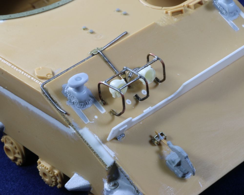

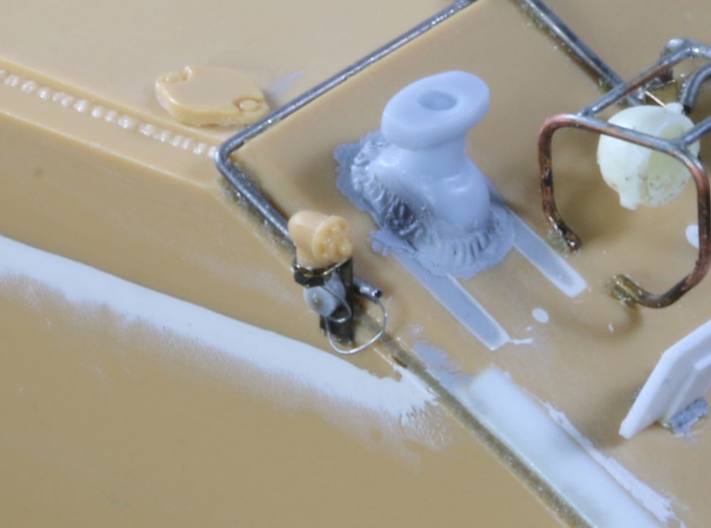

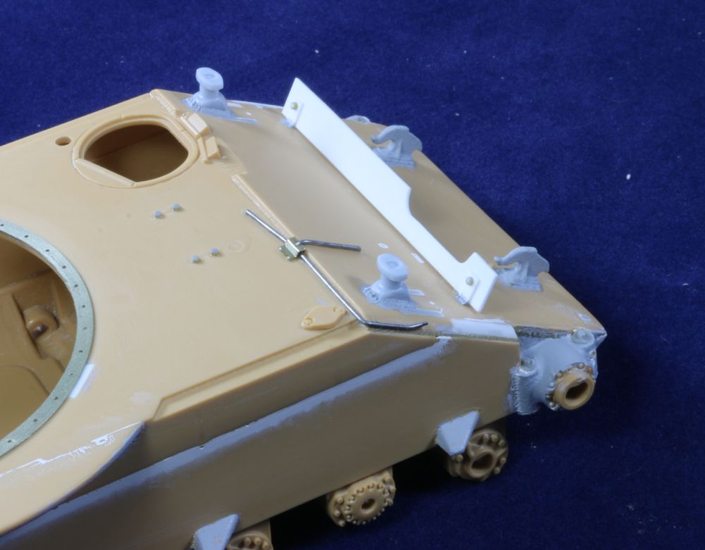

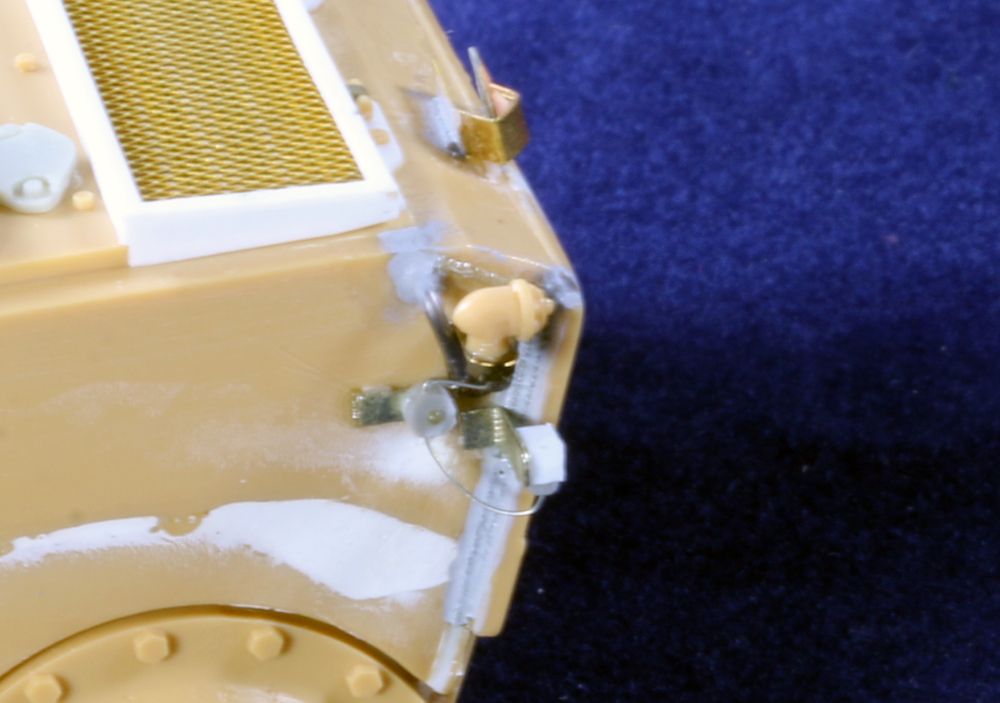

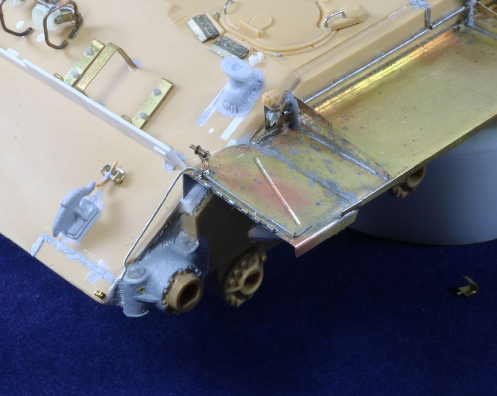

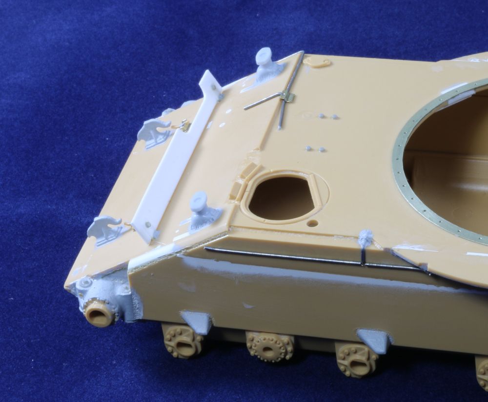

More work done at the front end. The wading board is remade from styrene as the PE option in the DEF set is way too thin. The two resin 'posts' on either side are from DEF - though I don't actually know what they are for The wiring conduits are added using solder wire as it's much easier to bend to shape and the ends are drilled out to make it look like hollow tube....
Next I need to add some welds to the conduits.
Gary

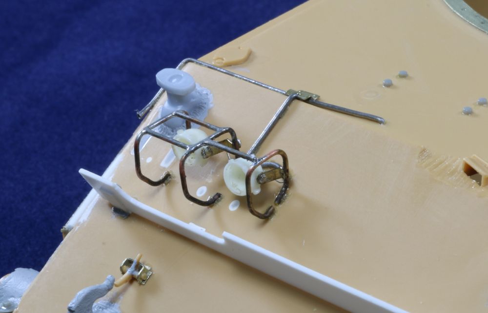

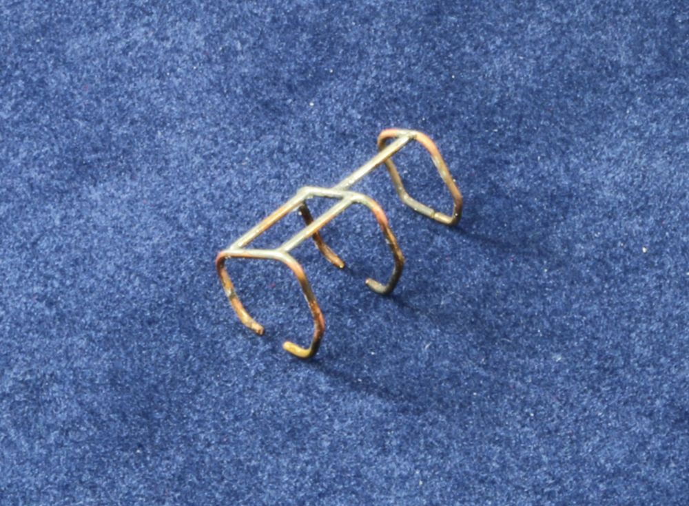

Initial Tiran 4s kept their original light guards. These aren't in the Tamiya Tiran 5 kit, but I do have a T55 in my stash so raided that. The styrene guard isn't really that good but makes a nice template guide to make one which is truer to scale. I used .020 brass rod bent to shape and soldered together for strength....
Gary

All in place now. Resin lights (hollowed out with a Dremel ready for clear lenses) are from the spares box....
Gary

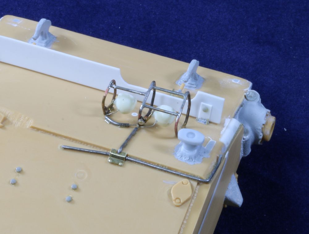

Convoy marker lights. Mixture of kit parts, Aber PE and some scratchbuilding....
Gary

With the convoy lights all done, I added a few more details including the welds for the distinctive frontal interlocking armour plates using Mr Surfacer and am probably about ready to move onto the fenders next...
Gary

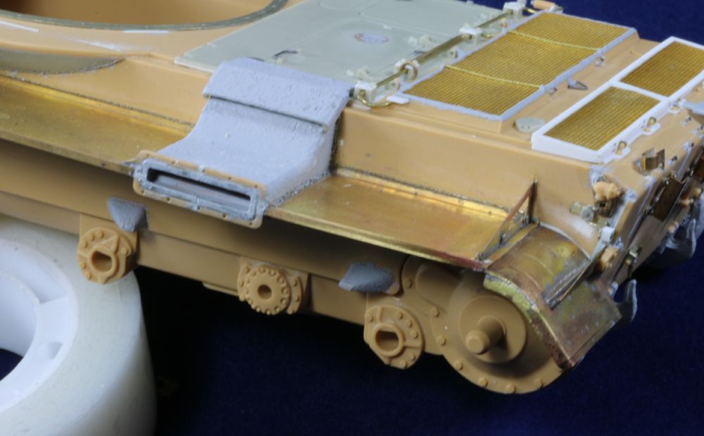

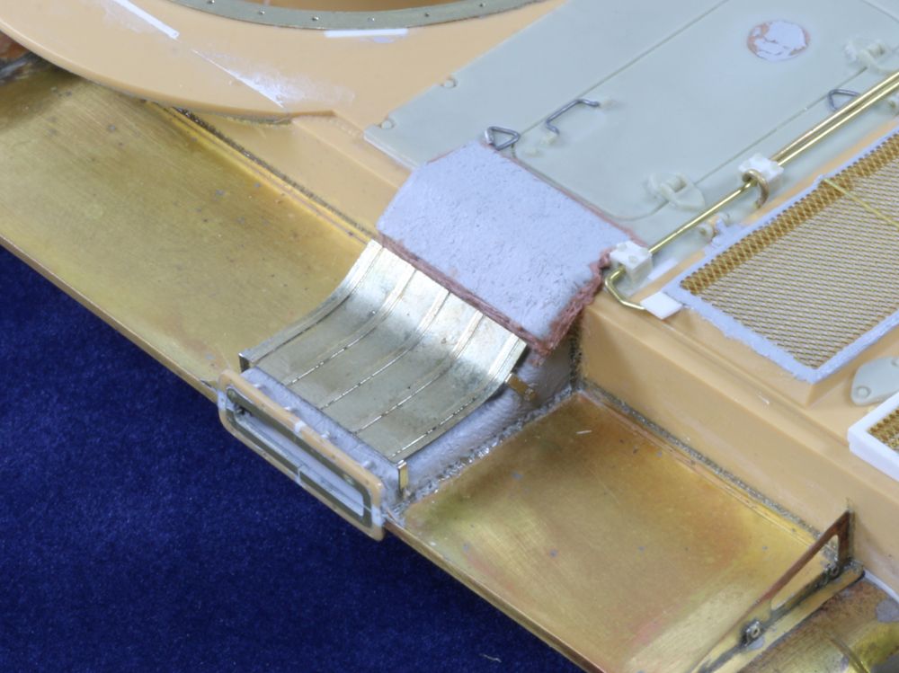

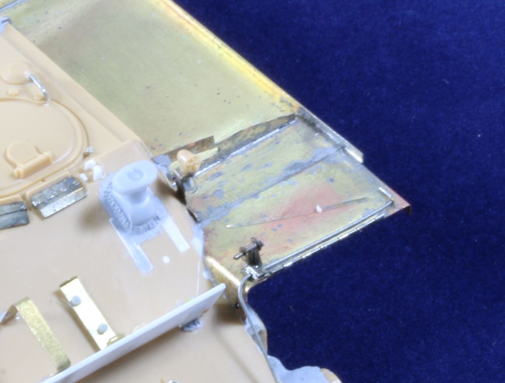

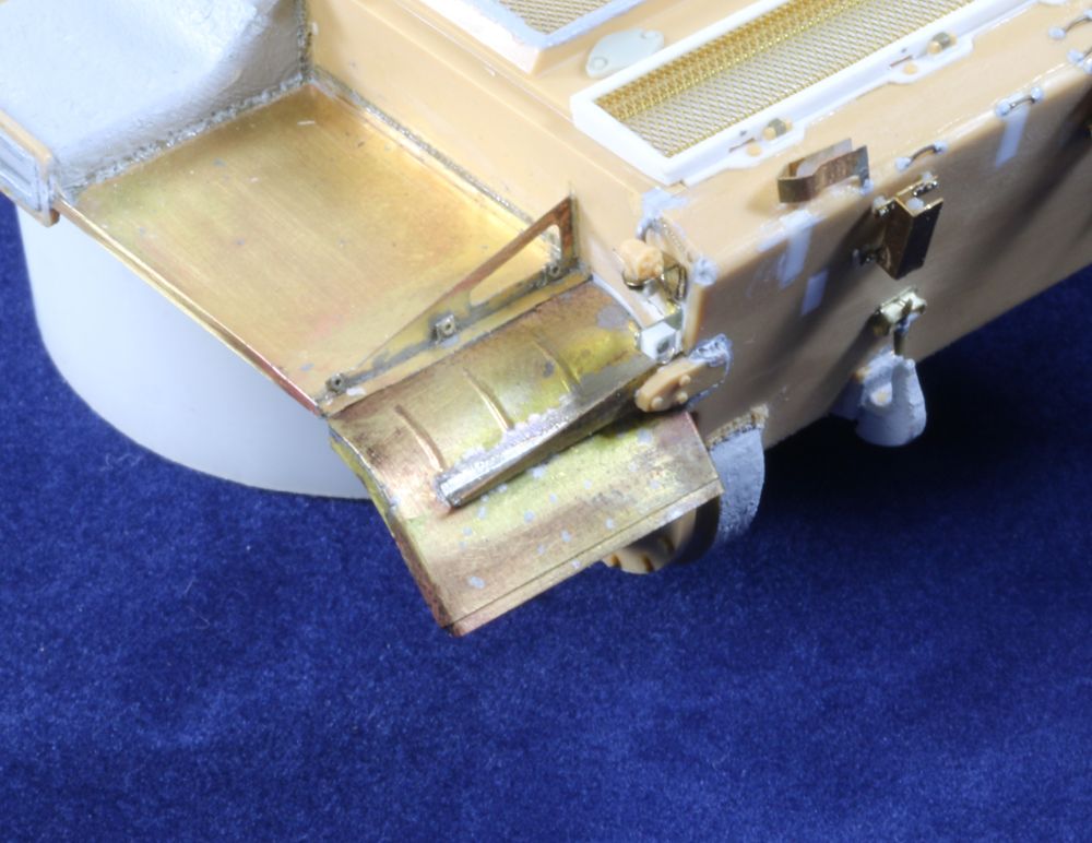

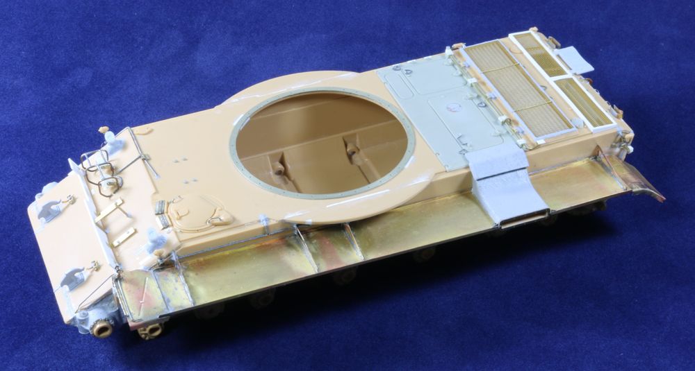

I'm using Voyager's T55A fender set here as I had one in my stash rather than the Tiran 5 specific one. As a result of it being based on the original Tamiya T55 kit, the embossed ribs on a couple of panels need to be 'reversed' - ie recessed rather than raised - as Tamiya got them wrong on their kit. Otherwise, pretty straightforward. Initial Tiran 4s kept the original front guards which is what I've used here. I'll attach the fender to the hull before finally putting the front guard in place and bending the hinge to fix permanently. I have yet to add the read rubber mud guard and plan on using lead foil to replicate this.
Gary

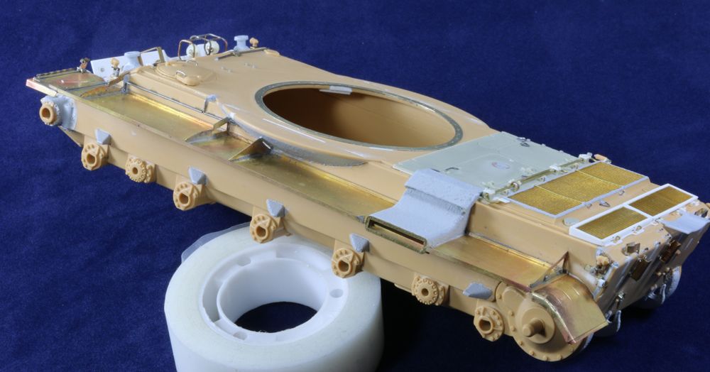

First fender is on...
Leading inside edge needed a slight trim with some sharp scissors to get a snug fit, but overall, happy with the way it mated up to the hull...
However, I'm not 100% happy with the exhaust outlet - going to need to re-do that so it better resembles the real thing. New armoured cover is from the Legend set...
After the exhaust is sorted, I'll start adding some welds where required.

Welds added where required and exhaust outlet still being worked on but much happier with it now. I've decided to leave off the front guards so that the idler tensioning units can be seen on the finished model...

Exhaust complete....
