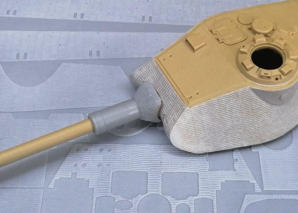

Here is the commander's side of the turret with the raw sticker material applied. I intentionally left off the hatch zimmerit so you could get a better look at the before and after.
The film is very tough and of what is probably scale thickness. The shapes ARE NOT diecut and in my opinion it is better to cut the stuff with scissors but if you choose to use an X-acto make sure it is a fresh, sharp blade with a good point.
The film is thick enough that it does not hunker down well over details. When trying to work it around bolt heads and welded panel keyways I am going over these lines and scoring the zimmerit material with my knife to sort of take some of the fight out of the material and get it to lay down better.
Lastly the adhesive on these is rather extreme. Once you lay it down it is not going to move around at all. You can lift it up once or twice if need be to reposition it but not much more than that. For the most part once it's stuck, it's stuck.

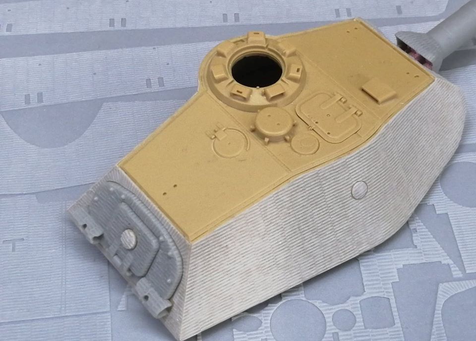

Here is the loader's side of the turret with the zimmerit applied and also painted. (No weathering yet.)
As you can see here trimming to exact size requires some practice, some patience and some luck. If you cut the various pieces out by cutting right on the guide line offered by Tamiya you will produce a piece that is oversized every time. I guess that is better than being too small. While still attached to the backing paper I tried to lay each piece up to the model to test for fit. Each time trimming just a little more off of each edge. As you can see even though I was careful I still ended up cutting some of the edges a bit undersized.
From previous experience working with the resin zimmerit I find that using small amounts of either the gell type super glue or good old Elmer's Glue as a body filler on these small edge flaws will rough up the surface and hide many these missteps.

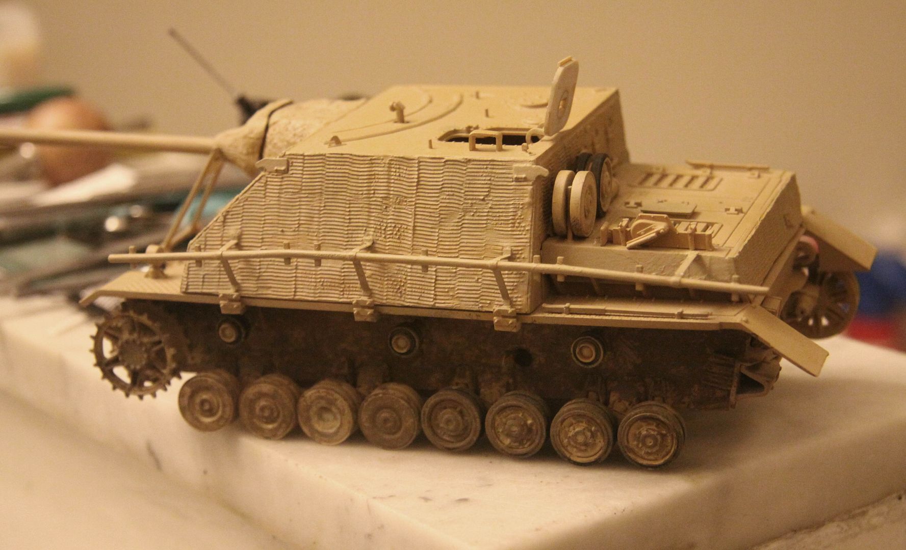

I've used ATAK, Eduard, and the Tamiya stickers. Of the three, ATAK is the best option. It's better looking to scale and lets you easily modify to show damage, if you like doing that. The Eduard is my least favorite as it's a challenge to get the large PE plates to match up on the edges, and it just doesn't look as real. The Tamiya stickers are just fine. They provide the proper look and texture. They may not be perfect to scale, but they do the job. The only issue with them is that you have to cut openings for every bolt hole. This can be time consuming.
Pics of the ATAK product on my 1/16 Tamiya Panzer IV RC Kit.
Pics of the Tamiya stickers on my 1/35 Tamiya Panzer IV build
