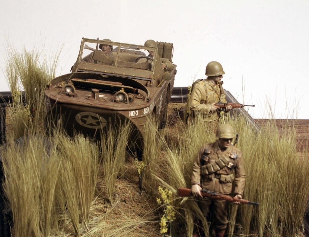

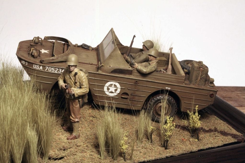

Unfortunately I just recently built mine before the introduction of the new kit. Just wanted to do a straight out of the box kit for a change. Wish I had added the resin wheels though.
I did add some much improved jerry cans from Tasca, Archer gauges and info plates, scratch built the canvas side curtains and the oar and finally I custom positioned the driver and passenger figures.

I agree with you! However I got taken to school by a couple of guys on this site who said you can't just add a couple of gas cans to an old kit and make it a winner. At the time we were talking about the old Peerless Max White Scout Car. My feeling is that SOME, not all, of these old kits have a real quality to them that only call for some minor updating to become a competitor!.
If I had it to do over I would perhaps put even more effort into this model with the Eduard etch set and some raised letter tires. But none the less I am very happy with the results. Thanks

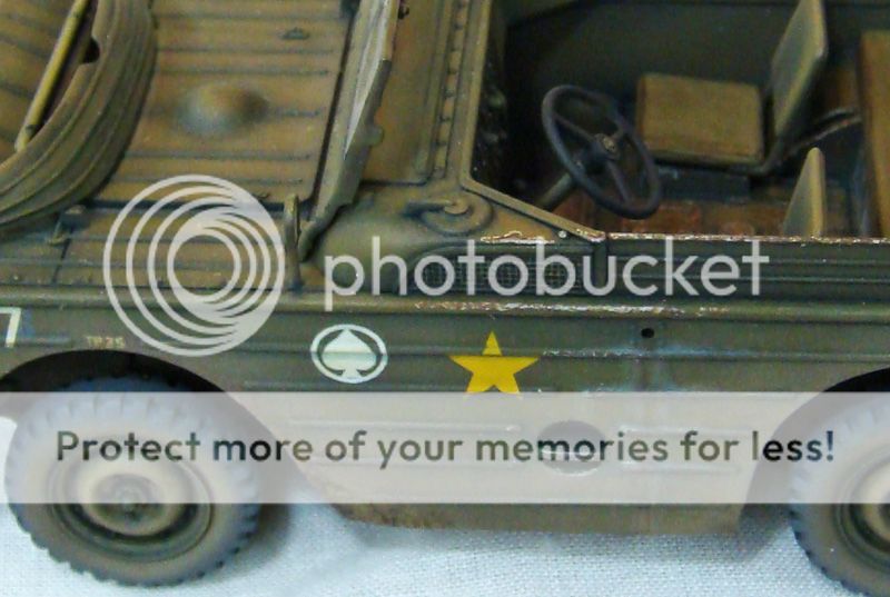

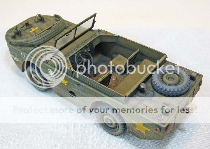

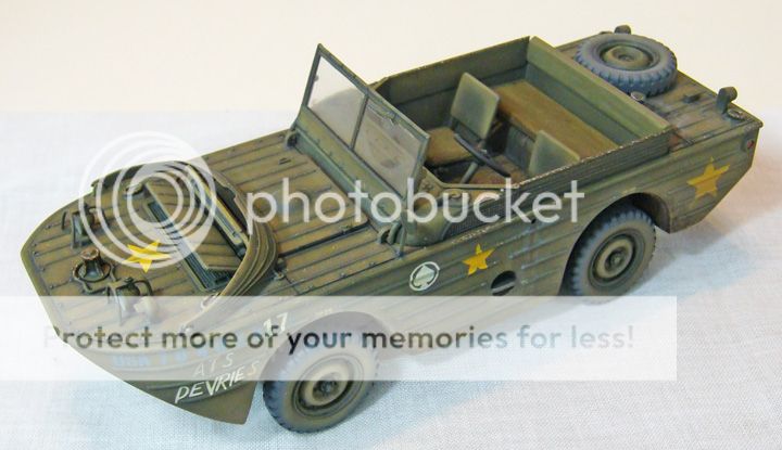

I built this copy of the 1974 original Tamiya release finishing it up about 2 weeks ago for our local AMPS club's intra-club contest.
The theme for the build was "Anything U.S.," so I was looking for an easy OOTB build to participate with.
The Tamiya kit is an oldie-moldy, but with some basic TLC, I thought it whipped into shape fairly nicely.
I painted on most of the markings (the spade unit insignia and "Devries" name are kit decals) using stencils following the color plate located in Zaloga's Osprey book on the Jeep. I also found original WWII photos of each side of the subject vehicle which showed the markings were not perfectly symmetrical, side to side.
I finished this one using Tamiya paints for the airbrushing, Vallejo model colors for the details, and artist oils for the washes.
The hardest finishing tasks are masking off the windscreen (molded as a single part with the wiper, etc detail) and the screens on the sides and front. I think Tamiya's inclusion of the PE screens is a very logical improvement and would simplify the painting (as long as the builder can deal with the PE).
When I get a break between other projects, I'll go back and add a 5 gal fuel can (the kit can is the old "two handle" type) and maybe a driver figure and put it on a base.
Until someone like Bronco or Miniart release a 21st century version of the Ford GPA, the old Tamiya kit is the only 1/35th scale game in town. The new release is, IMO, an improvement, but certainly not the kit that this subject deserves.

Mike, I really like the panel shading affects on your GPA! Not really panels I guess more like rib shading!
SdAufKla
South Carolina, United States
Joined: May 07, 2010
KitMaker: 2,230 posts
Armorama: 2,150 posts
Posted: Monday, March 31, 2014 - 10:17 AM UTC
Thanks, Mike!
The shading was done with the airbrush and then using a variation of oil color modulation.
I pre-shaded using Tamiya XF-62 Olive Drab straight from the bottle, and then highlighted with the same color mixed with XF-60 Dark Yellow at about 3:1 OD to yellow.
After the markings were done, I used indigo artist oils for the shadow washes followed by yellow ocher for the highlight washes. Each wash color was applied individually and blended out with a brush damp with mineral spirits. I also used ordinary mineral spirits to make the washes.
These indigo shadow washes were applied carefully, more like pin washes, just around or in the details instead of indiscriminately like general washes. The yellow ocher washes were applied across wider areas, like the fields between the ribs, somewhat like filters, as well as to the tops of the ribs, rivets and bolts, etc.
All very "old school" and low-tech.
I followed this with the dirt and dust colors airbrushed on. I used a raw umber oil wash in those areas.
That's really all there is to the basic colors.
The detail painting and chipping were done with Vallejo and Citadel acrylics. The whole thing got a "dust" glaze airbrushed on made with Tamiya Buff, gloss clear and thinners.
I still have some detail painting to do on the seat cushions and to add a 5 gal fuel can. (I couldn't bring myself to use the two-handled can that came with the kit!)
Glad you like, though!
