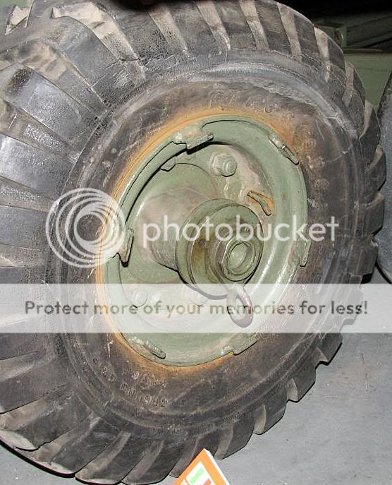

Hi all,
Doing some research on the British Ordnance Quick-Firing 6 pdr Antitank Gun for an up-coming build.
I'm trying to find out the purpose for these T-shaped tabs that are welded around the outside edge of the rims:
I've also seen similar tabs on the rims of 25 pdr's, so I'm assuming that they were a standard fitting with a pretty well understood purpose. However, nothing in my personal library has any info, and I guess that my "Google-foo is much weak" since after hours of looking, I can't find anything online either.
After studying the darned things (do they even have an official designation?), I can only guess as to their purpose. I THINK they may be designed to provide extra leverage to rotate the wheels when using the man-handling ropes hooked to the wheel hubs. If the rope was hooked to the hub and then passed around one of the tabs near the top or bottom dead center and pulled, it might help rotate the wheel moving the gun into and out of firing positions.
This is just a guess, though, and I can imagine some other purpose could have been intended.
So, the question is:
Does anyone here know? Is there some reference that you can recommend that might have the answer?
These tabs are missing from the rims on the Riich Models kit, and the gun that I'm building had them, so I want to be able to identify the parts and their purpose in my build notes.
TIA and Happy Modeling!

Some more information:
The OQF 6pdr ATG had two to four hauling ropes that were stowed on the front of the shield above the gun barrel. Each of these ropes was fairly thick (from photos, I'd estimate a little larger than an inch in diameter). They had metal eyelets with hooks spliced on the ends, and period photos show them hooked into the hauling eyelets on the wheel hubs with the gun crew manhandling the piece into or out of position or hooking it up to its prime mover, etc.
The gun also had two, tubular metal levers that were fitted into short lengths of pipe on the ends of the trails. These were carried on the sides of one of the trails and also used by the crew to maneuver the piece. The mounting pipes were equipped with pins and keeper chains to fasten these levers in place when in use to move the gun (although photos of the levers in use are pretty scarce).
These levers are quite a bit too large in diameter to fit into the hauling eyelets on the hubs. Their diameter is also considerably larger than the radius of the notches on either side of the tabs on the rims, suggesting to me that they were not intended to be fitted together.
As far as I can determine, there were no other tools issued with the gun that could be used as levers, and even the two "handspikes" for the trails are not designed with the arty traditional wedged ends.

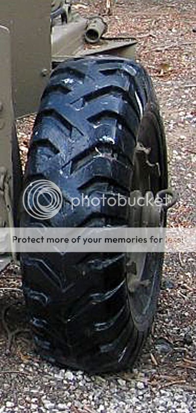

Here are a coupe more photos of OQF 6pdr ATG wheels showing the rims and tabs from different angles to help visualize their geometry.
In this second photo, you can see that the sidewall bulge of the tires would interfere with using a straight lever across the wheel from one tab to another (offsetting to one side of the hub). Obviously, the hub would prevent using a lever across the wheel to tabs directly opposite each other.
It might have been possible to use the pulley / sheave-like area on the hub as a fulcrum with the end of a lever notched on the side of one of the tabs. However, I think the pulley-sheave is almost in the same plane as the notches on the sides of the tabs, which probably means that this is not possible because of the same tire sidewall issue described above.
Here are two more photos of SIMILAR tabs on, respectively, the rims of the OQF 17pdr ATG and the Ord 25pdr HOW.
In the first photo (the 17pdr wheel) you can see that the design of the tabs is hook-like and not T-shaped with the opening of the hook towards the center of the wheel. There are also only 5 tabs on these wheels (vice 6 on the 6pdr).
The different shape, in particular, suggests that the way these tabs were used was somewhat different than on the 6pdr but the purpose was presumably the same.
The wheel hubs on these guns also don't have the pulley-sheave like fixture found on the 6pdr wheels. (If that makes any difference, except to suggest that the pulley-sheave wasn't intended for use with the rim-tabs?)

These tabs identify the wheels as an artillery wheel and are used for moving the gun on rough, boggy, muddy or soft terrain when a vehicle is not available. You attach a rope loop over one of the tags on each side and then wrap it around the other lugs, some poor saps then get the job of pulling the ropes to rotate the wheel. These tabs should only be found on an artillery piece.

In Frenchy's photo, the rope is attached to a free-turning loop on the hub and not offset from it, so the guys are pulling the piece forward.
As for using the lugs on the rim for a similar effect, I don't think so. For starters you would only get part of a turn out of the wheel before you get to exactly the situation you describe in your post, the rope gets on the "wrong" side of the axis and you start to defeat the purpose.
I think they are for using a hand spike to slowly advance the piece over very rough or inclined ground using the hub as a base and the tab as a fulcrum. The fact that the tire bulges a bit past the "sheave" plane on the hub is pretty inconsequential if you are using a 4-5 foot long metal pole to do the job. The tire bulge will just be levered out of the way. That there are approximately matching grooves on the tabs and on the sheave would strengthen my surmise.
But I still don't _know_. :-)

Sorry Paul but that is what they are for, Information from the The Garrison who are re-enactors of WW1 and WW2 Royal Artillery, a large number of them ex-gunners.

this method allows the rope to act as a lever and so requires less effort by the donkeys doing the pulling.
OK, I'm obviously not getting the picture here. :-)
So you wrap the rope around the tabs, rather like the rope on a windlass, anchoring one end to the hub and then pull the free end that you have let pay out the front thereby providing an extra torque to the wheel by virtue of the distance from the wheel hub to the rope strung across the tabs?
Wouldn't this mean you have to rewind the rope over the tabs every so often as you unwind the windlass?
If this is how it works, I can see the mechanical advantage, but it seems clumsy unless its used only in extremis and for very short distances.
If I haven't gotten it right yet, I'm obviously missing something and need pictures as well. :-)

Paul you are correct in that it is for short distance moves when needed depending on terrain. You would need to perform the task several times depending on distance, but a gun crew could move the gun over just about any terrain without busting a gut in the process. Of course you would not use this all of the time; the rope attached to the eye makes it easy enough to move a gun most of the time, when you reach a difficult patch you wrap the rope around the rim.
