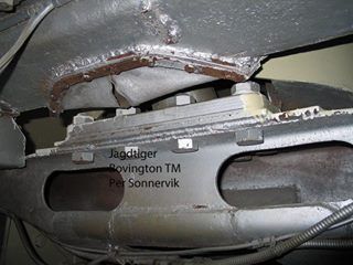

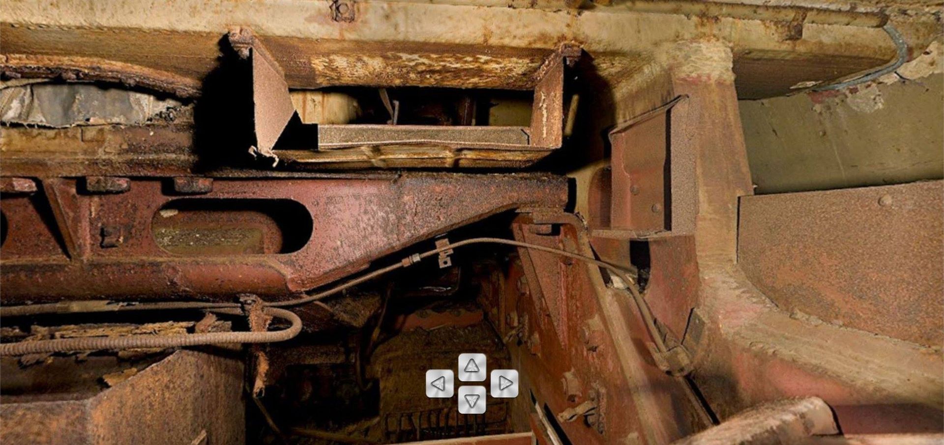

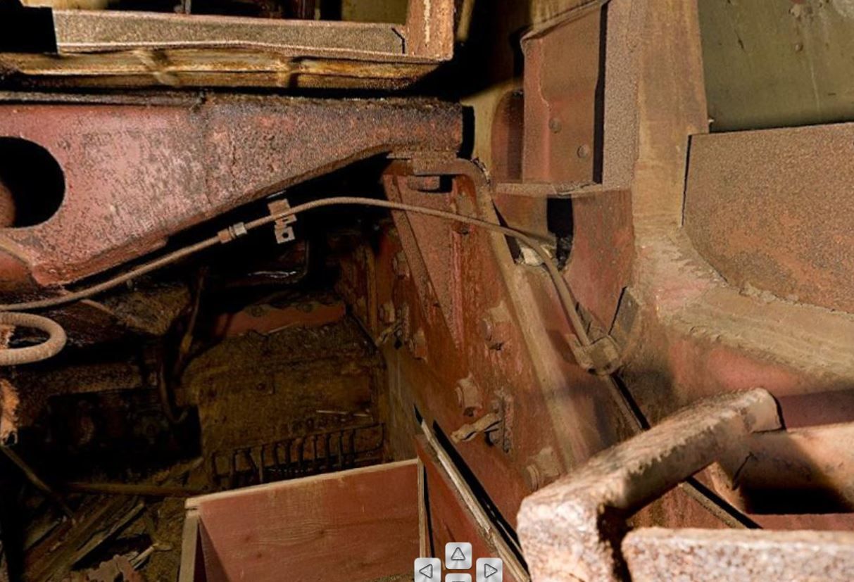

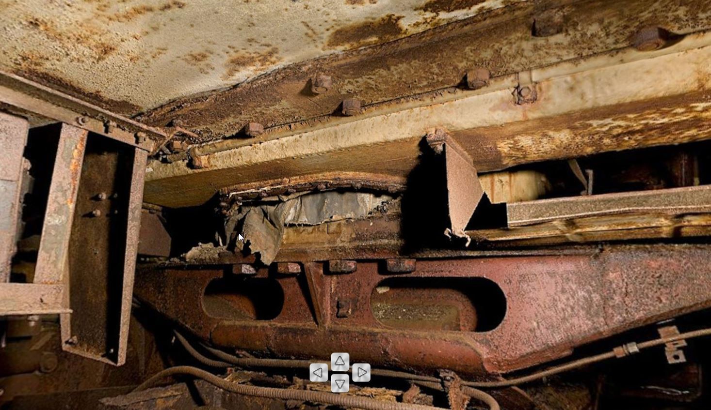

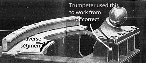

Trumpeter used images of the prototype to detail their mount, and its 100% wrong for a production vehicle. The images and information I used came from UNRESTORED museum vehicles. Also, there was never an 88mm version of the Jagdtiger, its a myth!
What Trumpeter used for their gun mount:
The UNRESTORED Bovington Jagdtiger:
The UNRESTORED Aberdeen Jagdtiger:
Sam

Hi Donald - please explain how Im wrong with the gun mount. Im keen to hear how I got it wrong when I used images of unrestored actual vehicles, both the Aberdeen and Bovington ones. The images I posted clearly show that Trumpeter got it wrong. Im not insulted by any means, I'm just keen to hear what reasoning you use to justify saying I'm wrong.
Sam
Sam
Hi Sam.
I've been going with what information that I've had available. You posted the pics. after this post, obviously Trumpeter screwed up big time especially on a kit with a list price of $400 U.S. dollars. If you had posted the pics. with your scratch built mount I wouldn't have said anything. On a side note without plans or a cutting diogram I doubt that anyone will try to do what you have done.
Regards
Donald
