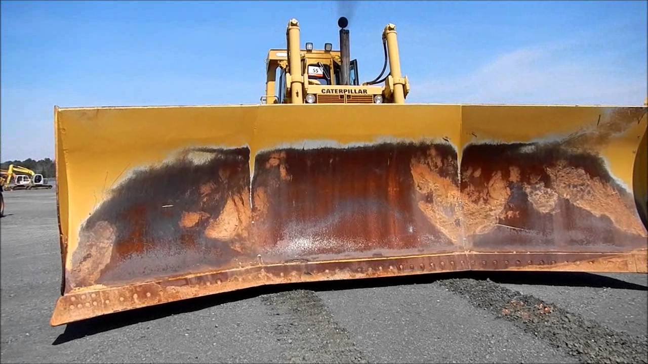

Regarding painting, I imagine the steel alloy used for the tracks and wheels will have a high Manganese content for wear resistance. This means that the wearing surfaces of the wheels and both faces of the tracks will not be bright silver, nor will they be graphite metallic grey. High Manganese content steel has a goldy-brown appearance, difficult to replicate and for which I have not yet found a stock colour match.
Most modern construction equipment uses high manganese steel for the buckets, blades, and implements. Once the surface oxide wears off they look quite steel-like.

Posted: Tuesday, November 14, 2017 - 10:20 PM UTC
Thanks for the pics. I like the rust on the dozer blade and will try and replicate it on my T90 with blade when I get to it.
