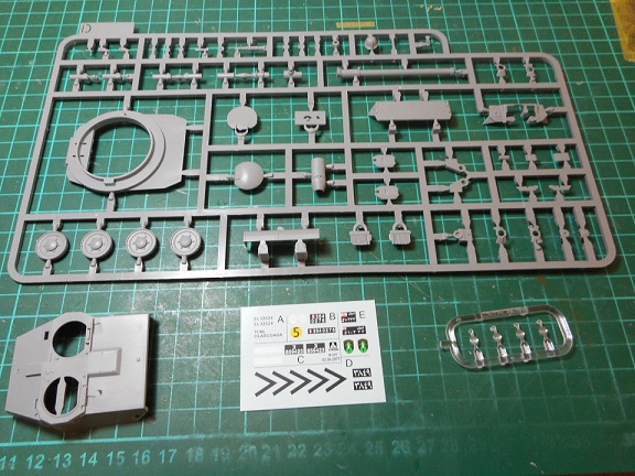

Hi All, I start with my new job, It will be a Panhard (AML-90) in Mavinas / Falklands by 1982. The model is a Takon in 1/35, the numer of the kit is the 2077.
The kit that I saw is simple, with few pieces, with out interiors. My Idea is make it with a patrol in Port Argentino.
By now I only can show the model:
Regards, Omar

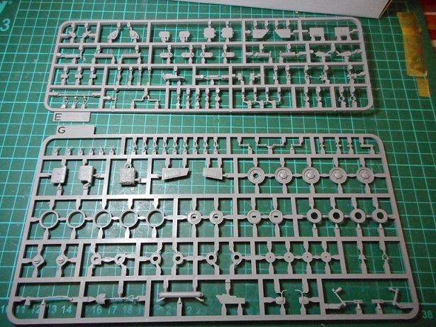

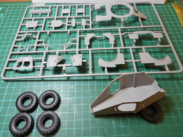

Posted: Monday, December 11, 2017 - 06:37 AM UTC
Thanks Eric
Well, the first steps for the moument, the pieces are simple to asemble, you must chose the correct version, because the model dosen`t coincide with the Argentinian version, its a mix between the two versions of the model.
The kit permit a little moviment of the front tren, that permit turn few the wheels
The advances:
Regards

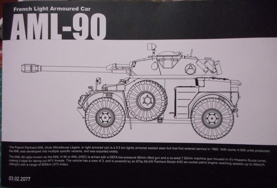

This points you must have to considerate:
And the other point is the sport of the MG, must be made by scratch, because the kit doesn´t bring it.-
LeoCmdr
Alberta, Canada
Joined: January 19, 2005
KitMaker: 4,021 posts
Armorama: 3,853 posts
Posted: Friday, December 15, 2017 - 10:08 PM UTC
Thanks Omar,
I think I've deciphered your Xs on the instructions so I will try to spell it out.
1. Follow step 13-2 and not step 13-1. Are these some type of air filter or exhaust grills?
2. Follow step 15-1 instead of step 15-2 for the wheel assembly. It appears the wheel hubs are different in both steps. Any other explanation?
3. Drill out the holes as per step 19-2 instead of step 19-1. Any explanation?
4. Follow step 26-1 for main gun assembly but leave off part D46 and don't drill the holes in part D32. Is that correct?
5. Step 23-2 don't drill holes in part D29.
6. Don't use the antenna mount and base (E16 and D8) indicated in step 25-1.
7. Use the antenna mount and base (E16 and D49) indicated in step 25-2 and leave off the turret bin part D43. It appears in images of AML 90s on the Falklands that a second identical antenna mount and base should also be on the left side of the turret. Is that second antenna mount and base included in the kit as extra parts? Is the mount included as Part D50?
8. Add the missing turret top mounted machine gun and mount. Is this a French AA-52/NF-1 machine gun?
9. In step 26-1 the straps on part D14 should be placed on the right front side of the turret.
Anything else identified?

Hi Jason
The points that you indicated are correct, I show more pictures of the Argentinian Panhard, you can see all the answers that you ask:
The MG is the same of the AMX-13/ 105 :
Look:
Regards
