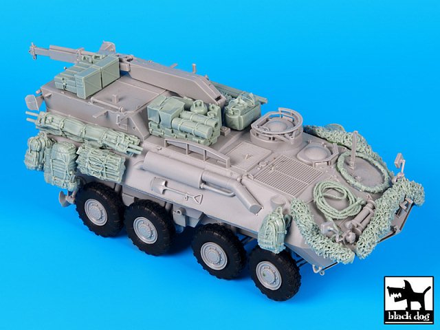

Have you seen this set from Black Dog (#T35118) :
Maybe this could be an option ? And you'll surely find some use for the rest of the set parts

Personally, Oliver I'd go with the rolled gauze technique since you don't need a tremendous amount of detail, there was a lot of dust, etc. coating everything; it will also drape well. I have the Black Dog set, it's nice, but the net comes in sections, it's solid and just doesn't look right to the eye - it doesn't drape, it rests. The vehicles in the gun platoons all carried two rolls of wire on the front (either concertina or barbed wire) for snap VCPs these were lashed around the light clusters on VC's side of the vehicle and the pioneer tools were either carried inside (bow saw and mattock head) or in the racks (mattock handle, shovel and axe). Unless you're depicting the push to Baghdad, you can also use protective mask carriers as stowage in either the gypsy racks or turret bustle rack; once it came down we did not have to tote around the gas masks they were all stowed together for accountability on the vehicles that might help somewhat with your stowage. In my platoon only two vehicles carried a spare tire, and it wasn't mounted in the usual place on the hull (there was a gypsy rack there), it was tied down on the engine access panel.
