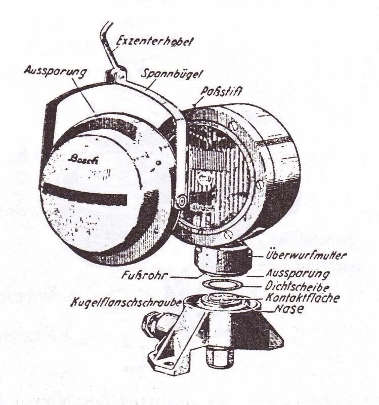

Posted: Wednesday, September 26, 2018 - 12:03 AM UTC
Looking good Matthew. One thing, the cable for the Bosch light does not enter the rear housing, it runs into the side of the base. The base has a large contact point in the centre which mates up to a similar contact in the upper section shaft. When the light is switched on the power goes from the cable into the base, then from the base wirelessly to the contact in the shaft of the upper section which then passes to the bulb. See diagram below for Kontactflache
Your bracket may be a little too high as it appears the normal tank mount is actually still being used just bolted or welded to the bracket..

Posted: Thursday, September 27, 2018 - 02:02 AM UTC
@Peter: I never knew that was how contact was made in the Bosch headlight. This is really useful information. I will make some adjustments, including shortening the bracket. I think the bracket is an ad hoc add on by the Germans - not the British original, though it’s hard to tell from my reference photo.

Posted: Thursday, September 27, 2018 - 03:07 PM UTC
Yes, it is amazing what digging around in the internet will turn up. Over the years I've learned I had quite a few misconceptions myself.
Definitely an add on. Basically you should have the base to fit to the flat plate, the plate just needs to be on a lower strut to account for the height of the Bosch Base. You can see the rounded housing of the base facing the centre of the vehicle in the pic, so the cable runs into the base from outside, same as on a standard German tank fitting that side.
