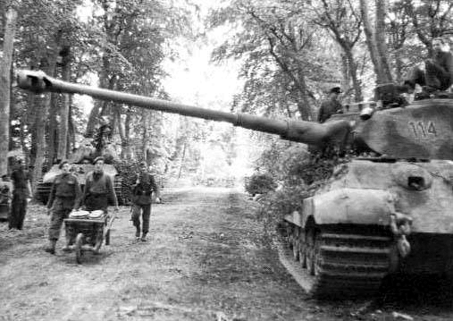

Since it seems this thread is drawing to a close with the Zimmerit question having been answered this seems a good spot for pose my King Tiger question.
Some years back I bought the Dragon Sd.Kfz.182 King Tiger (with Porsche Turret) kit. (#6189) It sat in my stash all these years but this past week it moved to the head of the line. Construction is now about 85% complete.
Only now do I notice that the box art shows the #114 King Tiger as having been covered in Zimmerit whereas the plastic model itself is of a non-Zimmerit Tiger.
Which is correct? What is Dragon up to?

Looks like #114 (Oberstleutnant Alfred Rubbel, 1. Kompanien/schwere-Heers-Panzer-Abteilung 503) had Zimmerit :
Normandy, France. 16 July 1944 :

Zimmerit has now been ordered.
Do not appreciate Dragon portraying a particular tank as one thing when in reality is was something else. Then they show it properly on the box art but one cannot build THAT tank given the materials in the enclosed kit.
