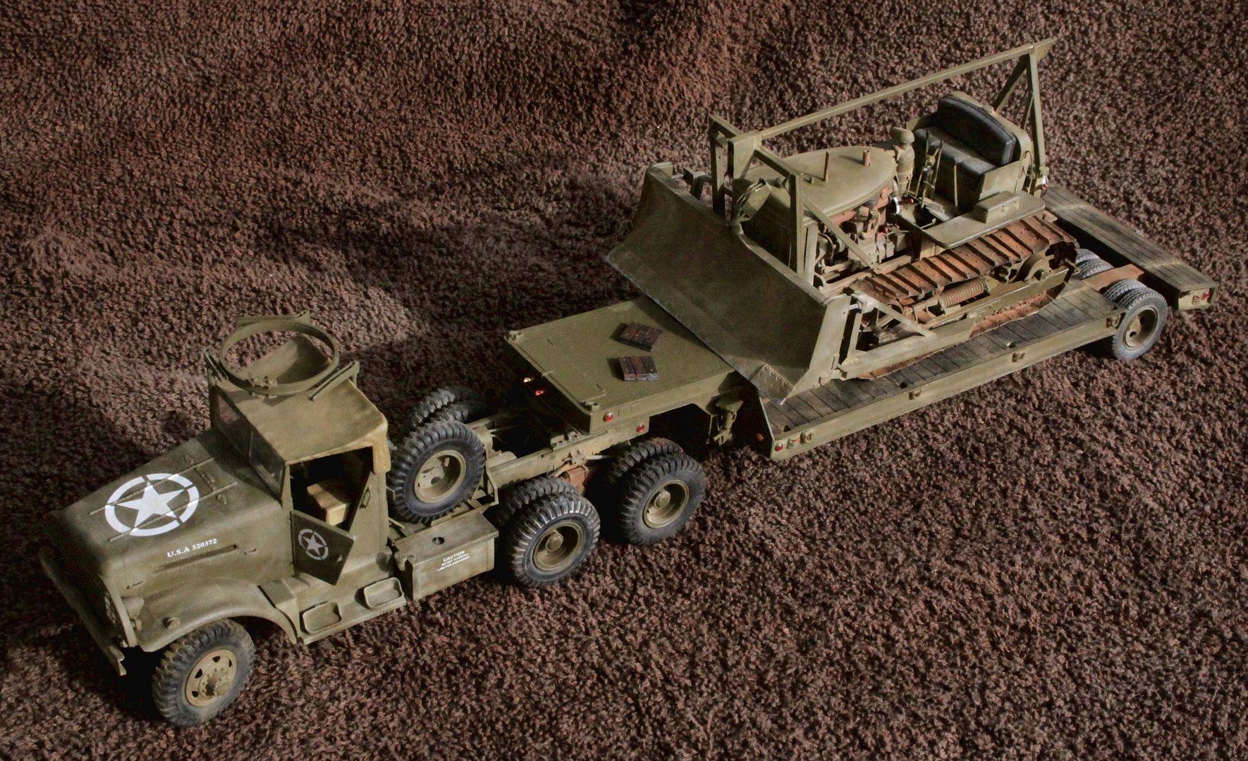

I suggest you do not paint tires at all. Scrub with synthetic kitchen scrubber then weather with pastel chalks (available at Michael's Art Supply in the US or online) or with powered weathering pigments. (Even cigarette ash or white school chalk will work.) You are (probably) only looking for a dusty effect anyway.
Pastel dust will hunker down into the "tooth" of the scrubbed rubber - chalk will stay put- no sealer will be necessary.
HobbyBoss White 666 cargo truck converted to semi-tractor.
Rubber tires with pastel weathering.
These rubber tires are now 5-6 years old
with no sign of rot of any kind.
p.s. I used the side of an abrasive cut-off wheel in my Dremel tool to gently rough up the tread and remove the center mold seam.

Exact same story on the tires below as reported for the ones above on the White 666 semi tractor. Except these are Tamiya hollow rubber tires and the model itself is well over twelve years old.**
Roughed up the tread and removed the center mold seams using the side of an abrasive cut-off disk chucked in my Dremel. All weathering done with pastels. To me the only need for actual paint on rubber is if you want to add somewhat extreme oil stains to the wheel bearings that spreads all the way out onto the tire and/or a heavy mud treatment.
** I campaigned this model eleven years ago. It took roughly 2-3 years to build and all the kits I scavenged for parts (including the tires) were used not new. So if you are worried about the tires falling apart it is anybody's guess exactly how long it has been since these tires were actually manufactured somewhere in the Far East but I know it is at least 14+.
