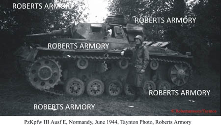

Here's an Ausf. F in Normandy :
And a "E" :

The two photos posted above appear to be a Panzer III Ausf. J and an Ausf. H.
And a "E" :
