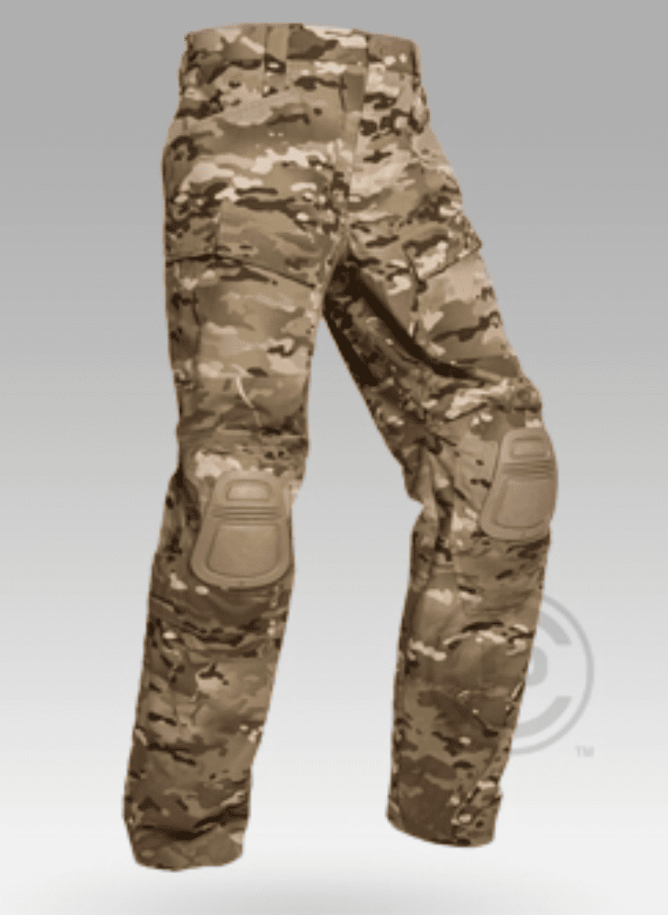

I also printed off a colour photograph of what it was I was trying to recreate in scale; in this case, Crye Precision combat pants, and pinned it to the wall above my workbench. I referred to this for scale and consistency of pattern.

Again, referring back to the pants, I started to spray out the second colour, green, in carefully chosen areas. Every camouflage has a pattern, and Multicam is no exception, which is why I have the pattern pinned to my wall.
It is important to remember, this is only the second of four colours to apply, and it doesn’t need to cover the entire figure; equally important to remember, it does not need to be everywhere. There are large areas of the camo where there is no green. Or brown.
I left this to dry over a couple of days, before coming back to repeat this step for the next two colours: wood, and flesh. Always referring back to the pants and pattern images for scale and consistency. Again, applying, moving, or leaving the masking as needed.

Referring back to the images, I prepared to apply detailed paint of the four base colours randomly, breaking up any large areas I may have missed, or wasn’t happy with.

the camo is actually more brown/green based than tan.

That depends on which uniform you are actually talking about. If you mean the original Cyre Multicam commercial patter, it did/does have more sand in it. If you are talking about the pattern the US Army developed, OCP (Operational Camo Pattern), then it is mostly brown and green. It actually looks very similar to the old Woodland BDU pattern. It looks like the figure is actually wearing Cyre Multicam, not OCP.
