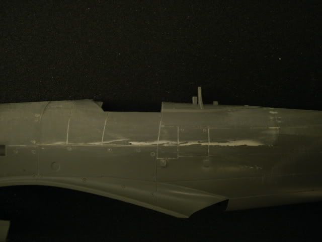

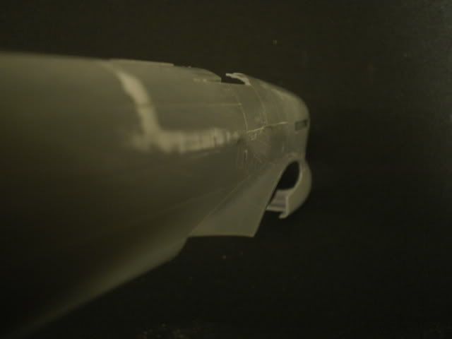

This is how it turned out so far, without the use of any plasticard additions:
The panel lines here are whitish but not filled, but here is on the left side of the bubbletop variant the only real surface detail damage I could not avoid: The nicely engraved "disc" screws (lovely work from Hasegawa) were damaged and I could only replace them with holes...:

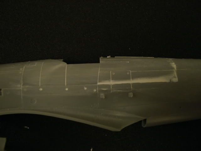

The right side was much better:

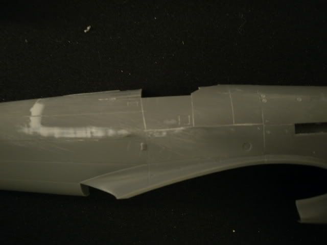

Left side of the cardoor version looks rough at the joins, but that is because of the plier work:

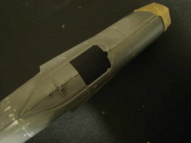

Again the right side was better:
Cardoor worst side:

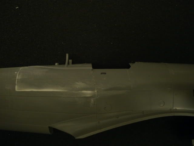

Bubbletop best side:

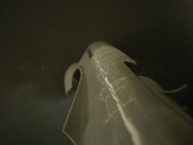

By trimming the entire fuselage join, the need for plasticard inserts is obviated, and the panel lines do match the way I did it, so that does seem like a good way to go. Doing this did not affect the fit of either of the canopy variants in the slightest:
It is true the use of these fuselage inserts is an unpleasant compromise that the modeller pays the price for, but, quite frankly, I wish this issue had not obscured the fact that these models are superior in overall accuracy to just about everything else out there: Every other component of this kit fits very well, and most Tamiya and Accurate Miniatures kits (with far bigger reputations) look positively retrograde in comparison... Too bad it is not my favourite subject, but I think it is the best 1:48th WWII aircraft kit Hasegawa has ever done, bar none, even if the flush-to-the-opening wheel wells walls will seem like a serious issue to some (a similar issue to the P-51 wheel wells).
