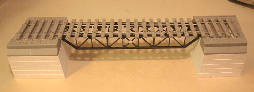

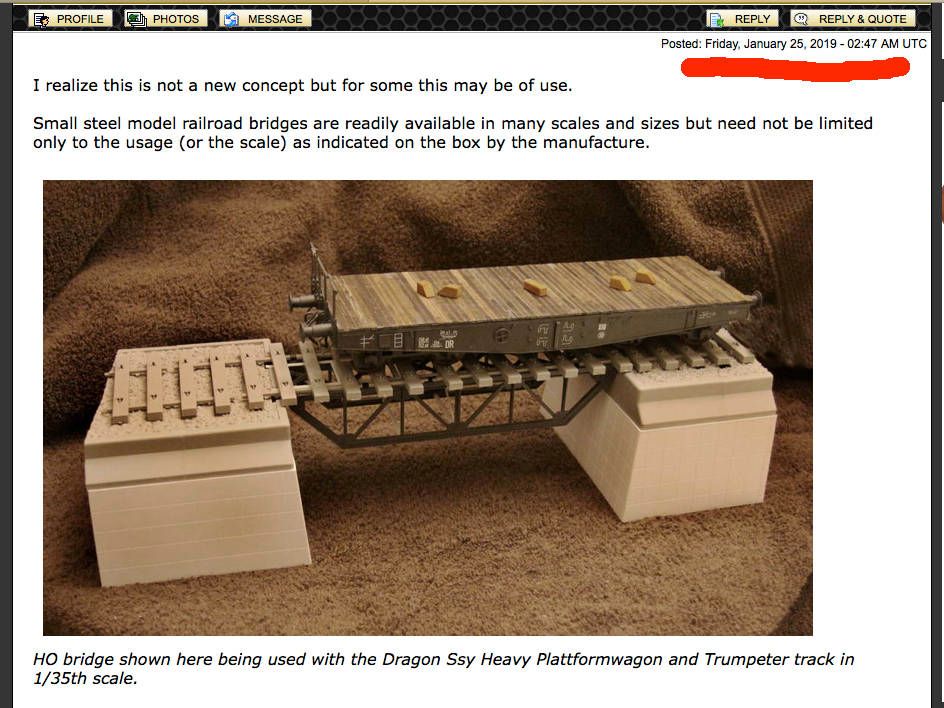

I would like to ask for the approval of Angel and the rest of the group on the following question:
I was one of the early enlistees to this campaign but without a specific model in mind. So far I have yet to become involved with what I would call a truly serious scratch build. However at the beginning of this year I did start this somewhat involved scratch build/conversion of a HO model railroad bridge into a 1/35th scale model.
This build is not part of any other campaign, but as of 25 January I started a build blog here on Armorama covering its' construction. The two abutments are totally scratch built and the bridge is actually a combination of two HO model RR bridges with considerable scratch built structure added to it.
I would hope this would be acceptable that I might submit this model as my entry. However I will accept the judgement of the group. - Thank you for your consideration.
______________________________________________________________
The thread covering the construction of this and several other small bridges can be viewed at:
https://armorama.kitmaker.net/forums/274761

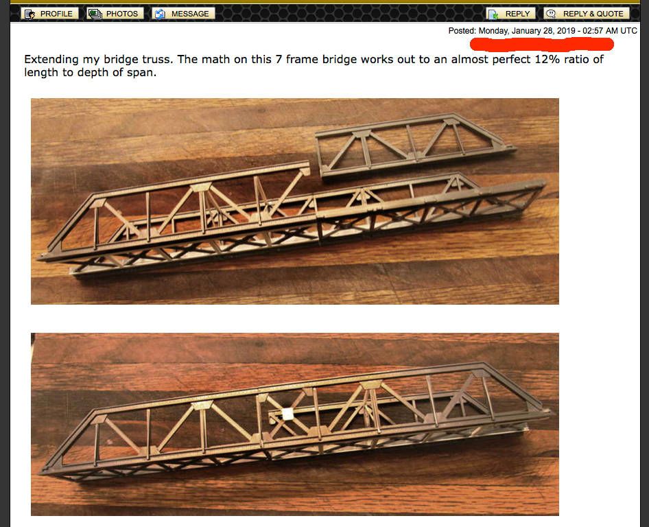

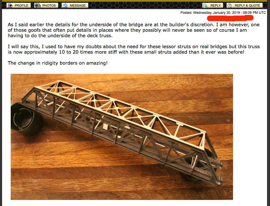

More photos from the construction blog covering this build:
I was told by my Army Corps of Engineers Niece and others that a bridge as short as my first attempt would have been built, in real life, as a simple plate girder bridge and not a truss bridge. My response: OK I will double the length!" The general rule of thumb is that a truss' depth should have a minimum 12% ratio to its' length. This one now works out to just about exactly 12%.

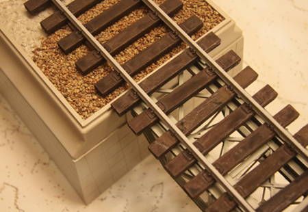

Painting and staining of the Trumpeter railroad ties (sleepers) for the bridge.
