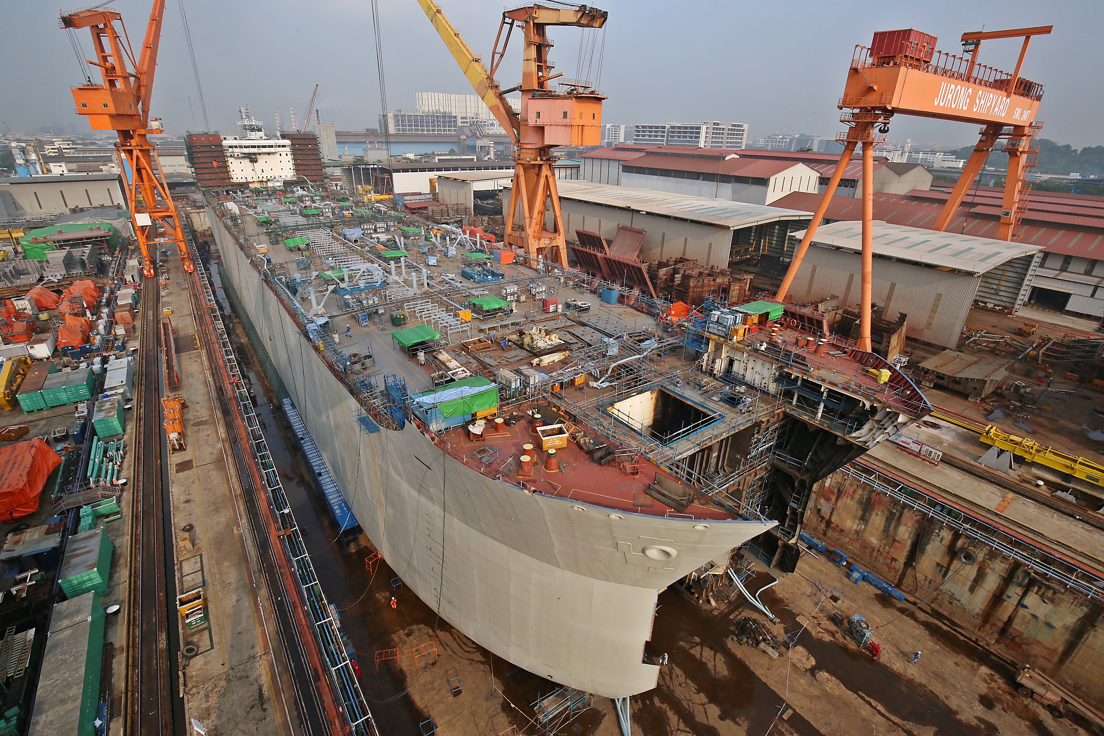

It depends on how the original dock was built. Some are built by blasting a hole in the rock so most of the walls will be blasted rock with some concrete to fill in where needed or to make structures like ledges and stairs. Others are all concrete
and
This one in Helsinki is more of a dry harbour ...
Maybe go visit Suomenlinna?
https://www.google.com/maps/place/Suomenlinna/@60.1452507,24.982346,291m/data=!3m1!1e3!4m5!3m4!1s0x46920b8db8853885:0xc98ef166ae80717!8m2!3d60.1454!4d24.9881401?hl=en
Mare Island, dry dock used by the US Navy
Portsmouth Navy Yard
https://upload.wikimedia.org/wikipedia/commons/thumb/9/94/USS_Greeneville_%28SSN_772%29_-_dry_dock_Pearl_Harbor_%281%29.jpg/1280px-USS_Greeneville_%28SSN_772%29_-_dry_dock_Pearl_Harbor_%281%29.jpg
Link to Wikimedia, USS Greeneville in dry dock
A few images to feed your imagination and creativity.

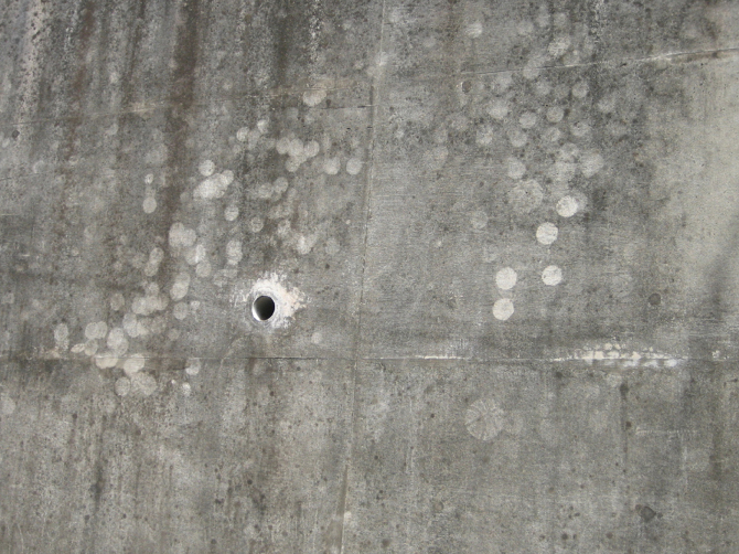

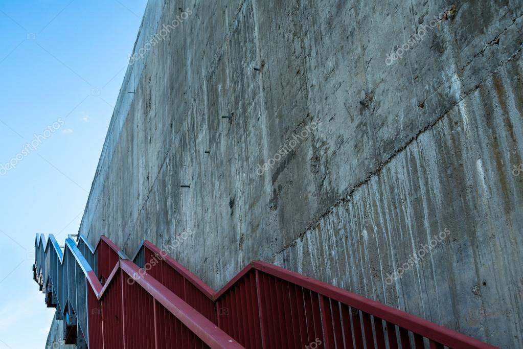

Build from plasticard. The surface structure/texture of concrete scaled down to 1/700 will be smoother that matt paint anyway.
Large surface details like small joint lines between slabs of concrete or the mould lines should be replicated. The forms used when pouring concrete can be made from individual planks or from large sheets of plywood. The planks result in lots of narrrow "strips" in the finished concrete, big sheets result in large smooth surfaces with distinct lines. If planks are nailed together to form large boards then both types of texture will be visible.
Planks:
Plywood sheets:
Hard to tell:
Don't know which method they used back in 1919 ...
The real trick is in the paintjob, to avoid a uniform surface ...

What's the colour of Money, errr concrete ...
Someone told me many years ago that there is often a faint yellowish tint to concrete, not just plain grey.
That goes for clean concrete, once there is dirt on it the painter needs to consider what kind of dirt it is. Is there moss or algae growing on it, could be green/brown/red/rust-coloured? Is it near something that creates soot, such as an old railroad? Other airborne contaminations?
Calcium can also cause white/grey patches on concrete. Trying to eliminate this effect by tinkering with the recipe when mixing/pouring can lead to weaker concrete.
What kind of sand or rock material was used when mixing it? Grey, black, reddish or yellow sand?
If we just stick to granite it can range from almost black via grey to red. Asphalt made with red granite will be a dull pale red once the topmost layer of tar has been worn off ...
The only usable answer is to try and get pictures of a the object in question, specific drydock in this case, or a selection of typical examples when modelling a generic drydock/bridge/embankment/wall.

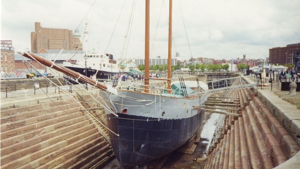

Interesting project. I know what I would use, especially for the dry docks with the "step" design. You can replicate this very easily with insulating foam. It's lightweight, easy to cut and very cheap. You can then coat it with a thin layer of plaster and texture it any way you want.
Alternately you could use sheet rock. I've used it for several projects. The downside is that it's heavy, and you have to first wet it to get the paper off. The it has to dry again thoroughly before you can use it. The advantage is the you can simply carve your detail to into.
If I were doing the straight wall design I'd probably use foam for the horizontal surfaces and sheet rock for the vertical ones.
